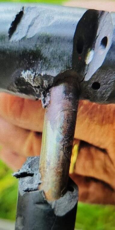

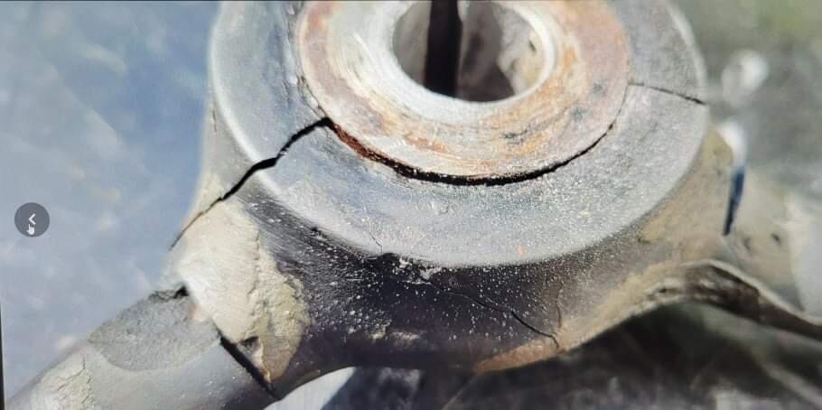

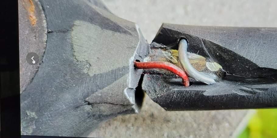

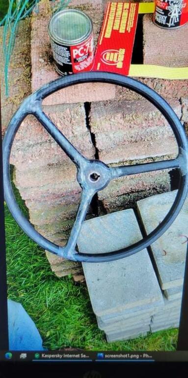

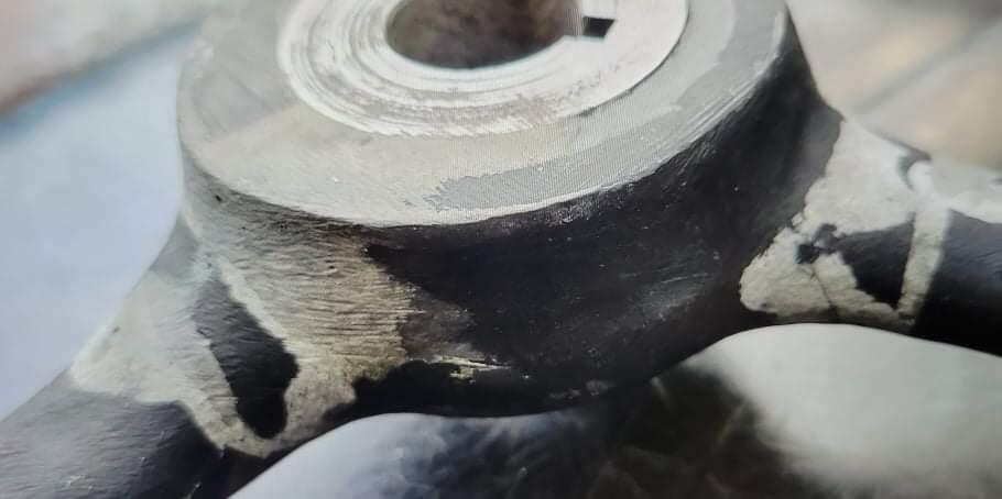

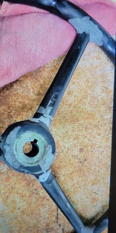

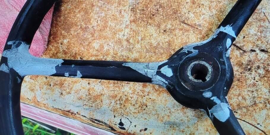

AMC RULES 37,259 #1 Posted December 29, 2021 (edited) Another RS member and I were recently discussing his wanting to do a old W-H roundhood steering wheel restoration. I shared with him the process I used, once I re-found the picts I took last year. Posting them here as well, with hope that they may help someone thinking about restoring their's too. First, a couple picts of what I started with here. Edited January 5, 2022 by AMC RULES 7 Share this post Link to post Share on other sites

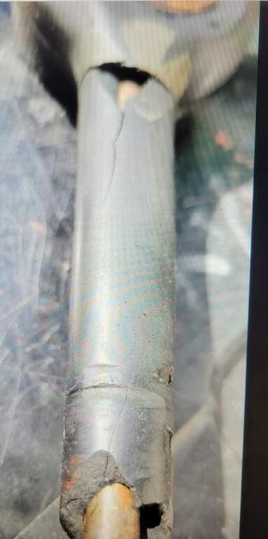

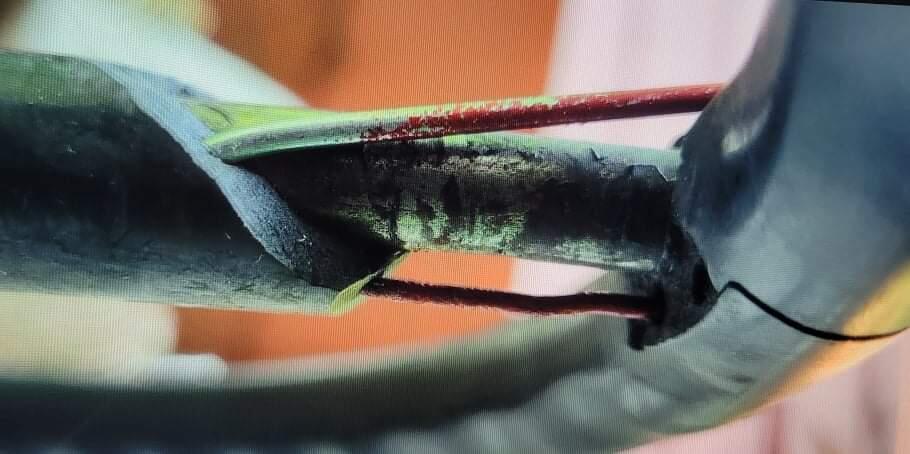

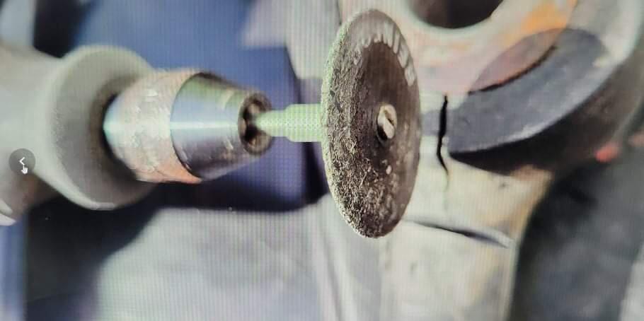

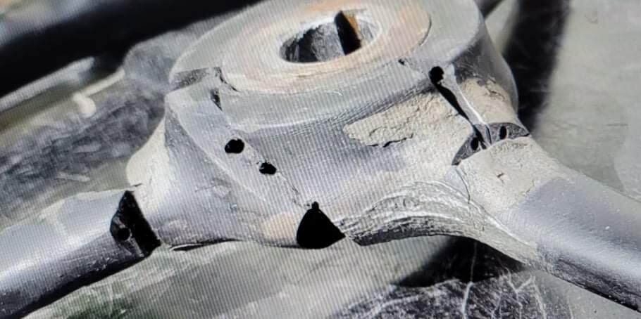

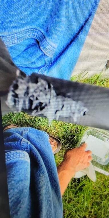

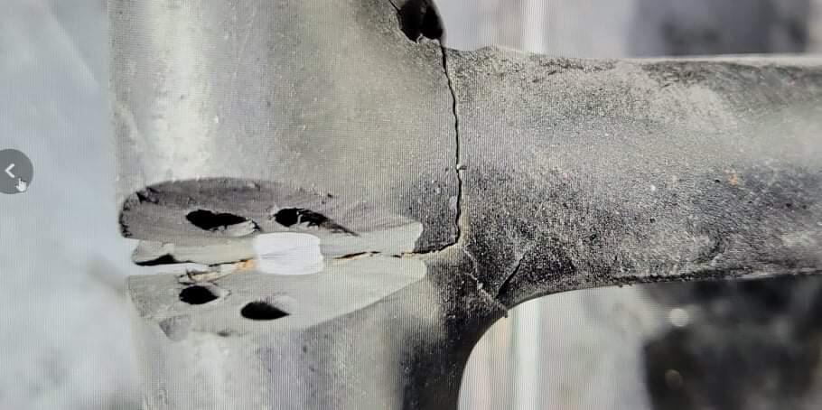

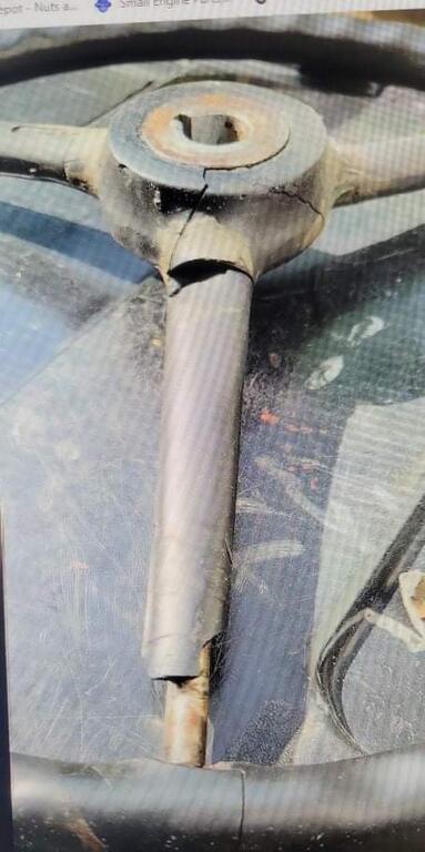

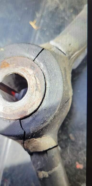

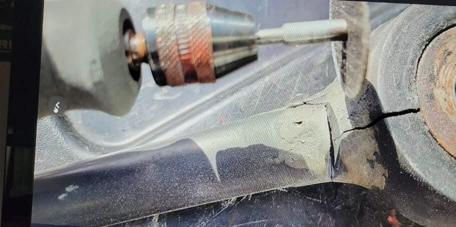

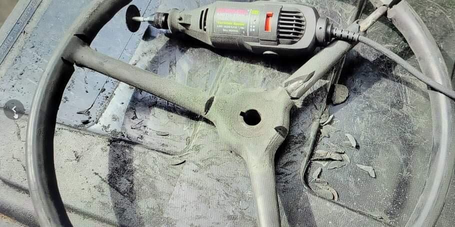

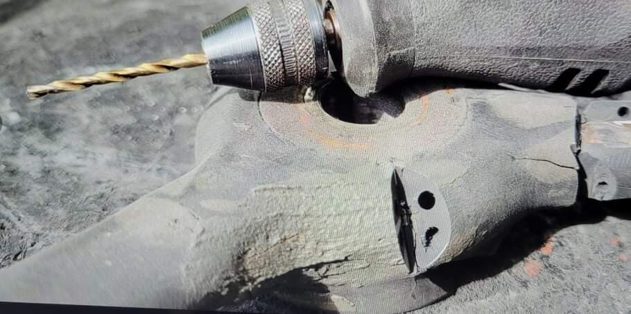

AMC RULES 37,259 #2 Posted December 29, 2021 (edited) My process starts with a cleaning of the wheel, to the best of your ability, to remove as much of the dirt and nasty black surface oxidation that just never seems to stop coming off. Just keep going though, it will eventually stop. Once you're happy with that you can proceed to opening up any breaks in your wheels material. Cut off wheel on a Dremel tool is my go to method for this. Basically just relief cutting them major cracks at a 45° angle. Then, switching over to an small, maybe 1/8th inch drill bit to add some tooth in them cracks for your repair material to attach to. Edited December 29, 2021 by AMC RULES 3 2 Share this post Link to post Share on other sites

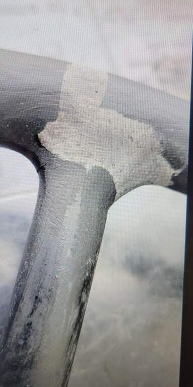

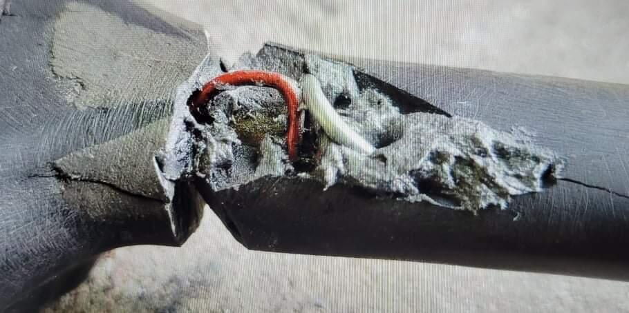

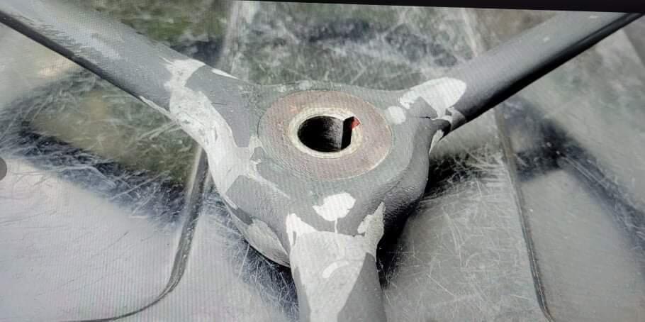

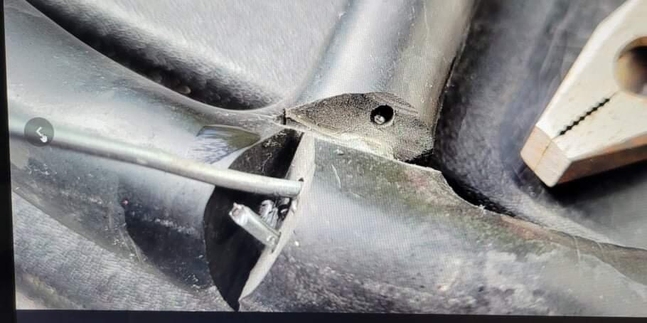

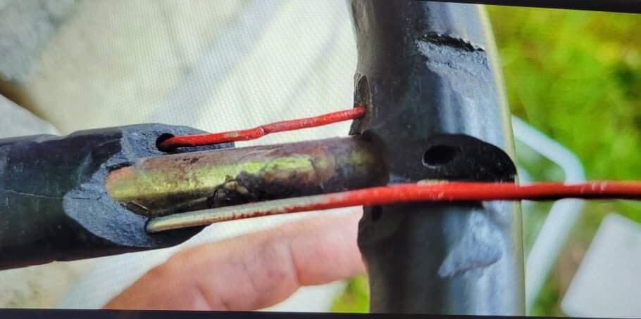

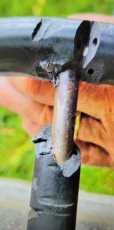

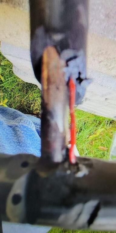

AMC RULES 37,259 #3 Posted December 29, 2021 (edited) I then find some small wire to act as a support structure, and start working it into some of them holes. Edited December 29, 2021 by AMC RULES 7 Share this post Link to post Share on other sites
Pullstart 71,145 #4 Posted December 29, 2021 Then what? Your method reminds me of interstate core repairs. They cut out a huge chunk, then drill into the next pieces and toss some rebar down the hole. Something to hold onto. 2 Share this post Link to post Share on other sites

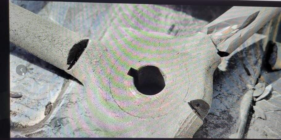

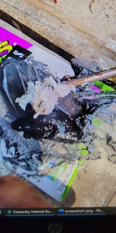

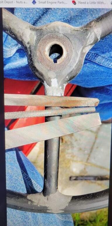

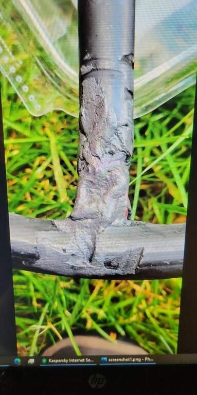

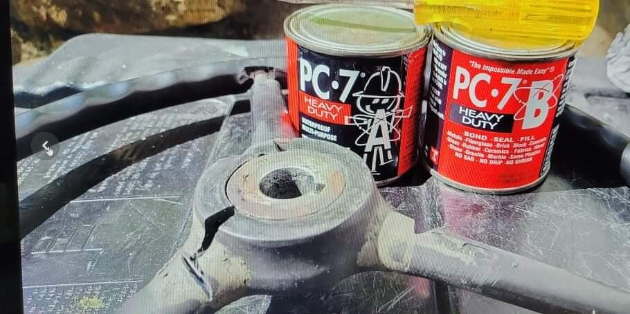

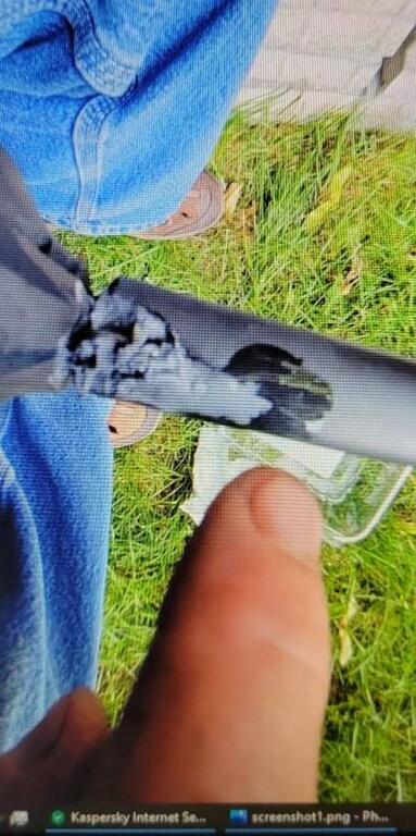

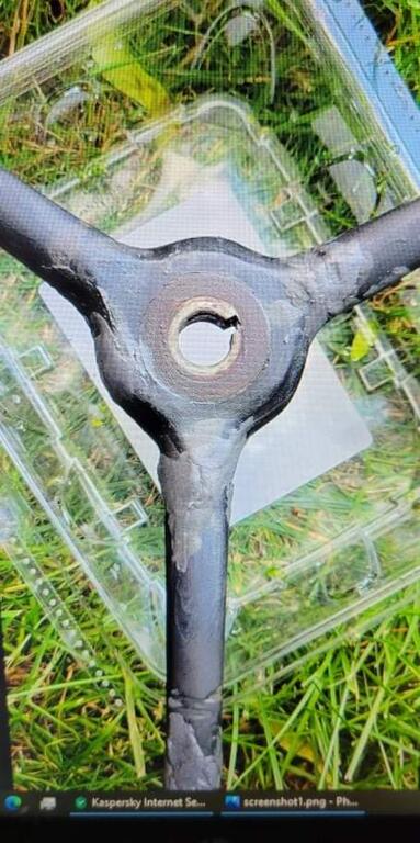

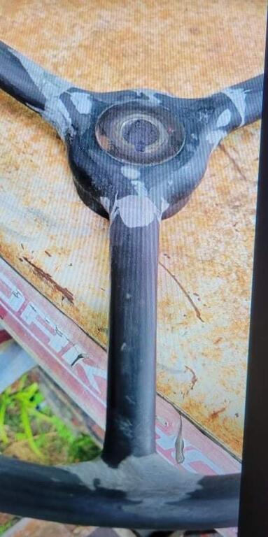

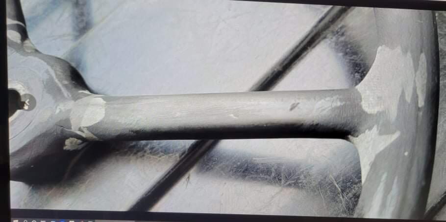

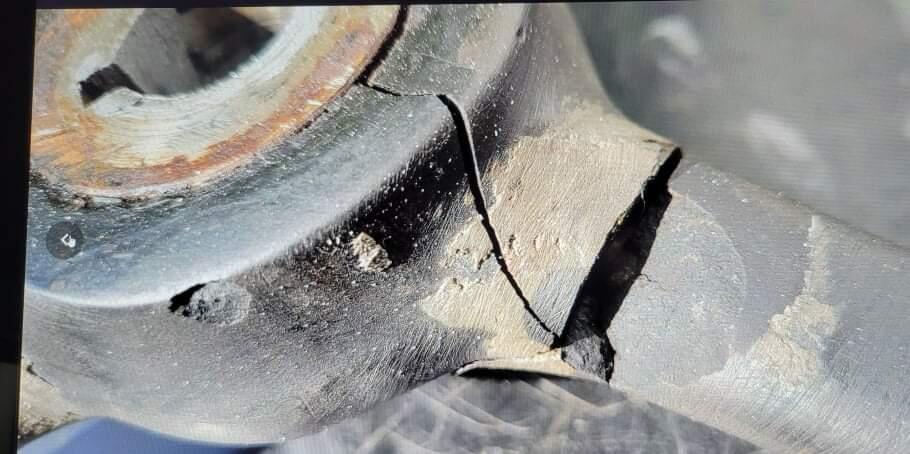

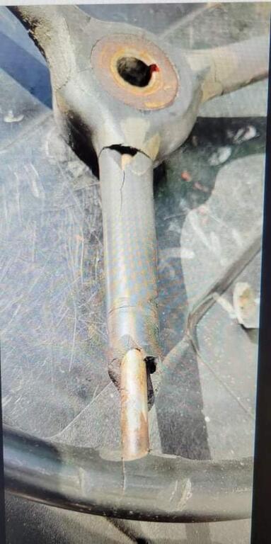

AMC RULES 37,259 #5 Posted December 29, 2021 At this point, you can proceed to replacing the lost material. I chose to use PC-7, it's a two part epoxy I've had great results working with over the years. Start by thoroughly mixing two relatively equal parts of the material together. Doesn't have to be exact, just looking for a uniform grey color to the material before you apply. I like to start applying with a flat tip screwdriver to ensure the epoxy gets driven into some of them holes I drilled. Holes aren't deep, maybe just 1/8" deep. This is what is going to help ensure your repair is tied into the original remaining material left on your wheel. Don't get into too much of a hurry here, just work all of this repair process in small stages that you can easily control. Here you note that once I have the crack filled I am using just a water wetted finger to smooth out the epoxy as best I can while it's still easily workable, before it starts to set up. Dipping into the water frequently serves to keep the epoxy from adhering to you, and your smoothing process working nicely. Here you'll notice these repairs are starting to take shape. You may have to remix another small batch to add more material where ever necessary. 5 3 Share this post Link to post Share on other sites
AMC RULES 37,259 #6 Posted December 29, 2021 I typically like to work with epoxy during them summer months, when it's hot outside. Helps to make the process proceed in a timely fashion, only needing about 45mins of drying time between each step of the process. Oncy the epoxy starts to set up you want to start removing any excess, and start shaping your repairs before they become rock hard. I like to do this with a variety of files and rasps I have on hand here. Just work each repaired area to a finished state as quickly as possible. Then let it dry for 24 hours. After the epoxy is good and solid you can now move onto your finish state with a medium 320 grit sandpaper. You'll want to sand the entire wheel at this point in preparation for the painting process which follows. 5 4 Share this post Link to post Share on other sites

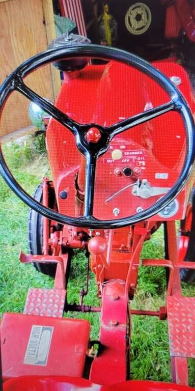

AMC RULES 37,259 #8 Posted December 29, 2021 Before painting you'll want to re-clean the wheel with a good quality, automotive grade wax and grease remover before shooting with paint. Any old black will do, I just used the off the shelf black Napa has to offer here. Give that ample time to dry, say one week. Then follow up with a few coats of a quality gloss clear and you're good to go. I'm partial to the "Diamond Clear" that the Eastwood company offers, because it's easy to work with, is within reason, gas and oil resistant, and dries hard as a rock in it's finished state. 6 Share this post Link to post Share on other sites

AMC RULES 37,259 #11 Posted December 29, 2021 (edited) Well, I suppose it could if you concentrated too much pressure sanding on them repaired areas. Part of my reasoning when I suggest you work that epoxy as much as possible to a finished state before it sets up completely. You're correct, that epoxy is going to dry much harder than that steering wheel's original material. Best to have it worked very near to it's final shape before that happens. Edited December 29, 2021 by AMC RULES 7 Share this post Link to post Share on other sites

AMC RULES 37,259 #15 Posted December 29, 2021 Will take some new picts of the finished product to share here. You have to remember the picts you see I've posted above are photos of archieved images on my home computer monitor. Leaving much to be desired in clarity. 3 Share this post Link to post Share on other sites
