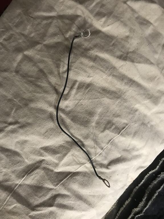

Wheelhorse616 4 #8 Posted December 27, 2021 I figured out that my starter is fine, just have no clue where this wire goes, not good with electrical. If anyone owns 312-8 and knows where this goes, a description and picture would be great. Thanks. Share this post Link to post Share on other sites
Wheelhorse616 4 #9 Posted December 27, 2021 2 hours ago, gwest_ca said: You have a low oil switch that is part of the starter circuit. Check the oil level first and make sure it is full. Then disconnect the switch and see if it starts. The switch is mounted in the oil pan at the rear. If it does the low oil switch needs to be serviced. There are special instructions to remove the low oil switch without damaging it. I think I found the culprit, this wire, I am not sure where it goes because I am not good with wiring and can’t figure out the diagram too well. Share this post Link to post Share on other sites
gwest_ca-(File Mod) 12,489 #10 Posted December 27, 2021 The looks like a ground wire that would be between chassis parts to ensure a good ground but being a light gauge of wire would not be suitable for anything but a small circuit. 1 1 Share this post Link to post Share on other sites
Wheelhorse616 4 #11 Posted December 27, 2021 1 minute ago, gwest_ca said: The looks like a ground wire that would be between chassis parts to ensure a good ground but being a light gauge of wire would not be suitable for anything but a small circuit. If anyone finds picture or knows exactly where it goes it would help out a ton, thanks. Share this post Link to post Share on other sites

RED-Z06 2,720 #16 Posted December 27, 2021 Thats the hood ground between the hood and block 1 1 Share this post Link to post Share on other sites

Wheelhorse616 4 #18 Posted December 27, 2021 6 hours ago, RED-Z06 said: Thats the hood ground between the hood and block What model tractor is that and what engine is on it. Just making sure. Share this post Link to post Share on other sites
RED-Z06 2,720 #19 Posted December 27, 2021 1 minute ago, Wheelhorse616 said: What model tractor is that and what engine is on it. Just making sure. 1987 312-8, M12S... Share this post Link to post Share on other sites

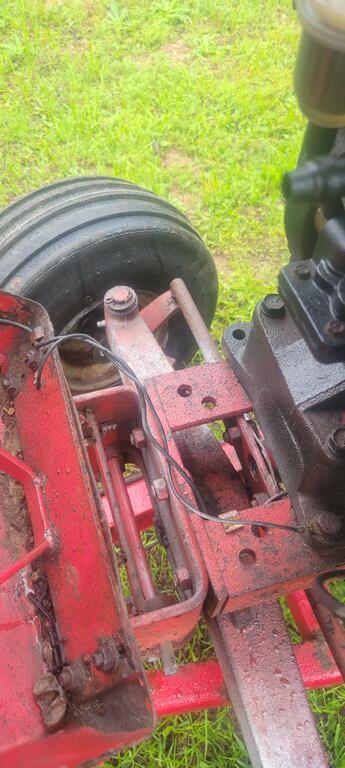

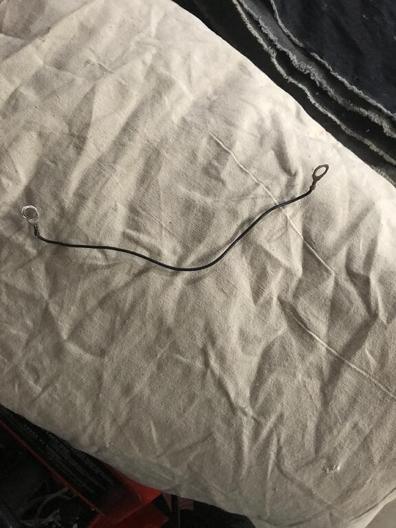

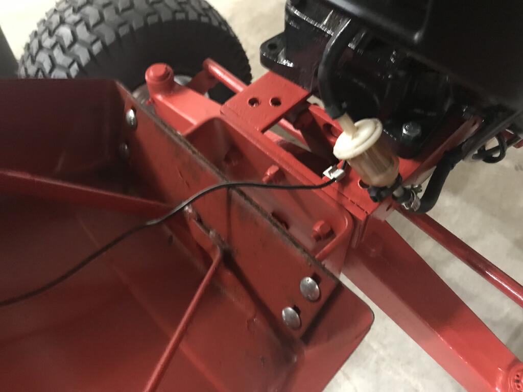

Wheelhorse616 4 #24 Posted December 28, 2021 There’s some pictures, if anyone knows where that wire goes. Feel free to ask for more pictures of any other spot, let me know. Thanks! Share this post Link to post Share on other sites
Wheelhorse616 4 #25 Posted December 28, 2021 2 minutes ago, RED-Z06 said: That was me. These tractors use a 3 post self grounding solenoid, it grounds to the frame, you apply 12v to the single small post, and it works. Any extra pictures you need that would help you just let me know. Share this post Link to post Share on other sites
