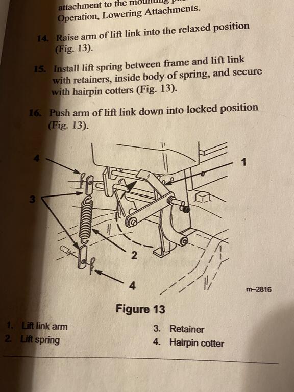

formariz 12,381 #3 Posted December 24, 2021 (edited) 12 minutes ago, lynnmor said: Do you have the big, ugly lift spring installed on the right side? Is it installed correctly? The one under tractor on lift bar? #5 on diagram?Not yet. Is that the cause of this? How do you guys install that damn spring ? Drives me nuts each time. I cannot extend it enough to reach hooking point. Edited December 24, 2021 by formariz Share this post Link to post Share on other sites
lynnmor 9,051 #4 Posted December 24, 2021 To get that spring on, I place the blower shoes on 4 x 6 blocks. The big, ugly spring installs vertically at the right front of the tractor. 1 Share this post Link to post Share on other sites
formariz 12,381 #5 Posted December 24, 2021 1 minute ago, lynnmor said: To get that spring on, I place the blower shoes on 4 x 6 blocks. The big, ugly spring installs vertically at the right front of the tractor. #3 on diagram. I have that one on. Share this post Link to post Share on other sites
lynnmor 9,051 #6 Posted December 24, 2021 Did you push the tension lever down? 1 Share this post Link to post Share on other sites

formariz 12,381 #11 Posted December 24, 2021 1 minute ago, lynnmor said: Did you push the tension lever down? No. That may be my problem right there. I’ll review that tomorrow. on the other spring do you install it prior to engaging bar on tractor lift arm? I just can’t seem to have the strength needed to extend spring enough to hook it on the tab. Share this post Link to post Share on other sites

wallfish 20,677 #22 Posted December 24, 2021 9 hours ago, formariz said: #3 on diagram. I have that one on. That spring (2) is to level out the lifted blower. Guessing the lift link arm isn't locked into position adding the spring tension. Dedicated tractor for mine as well and it stays somewhat level. It will rock back and forth when raised and you can feel that #2 spring tension when doing it by hand. Share this post Link to post Share on other sites
