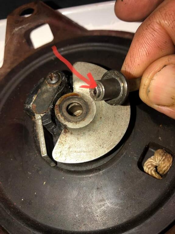

Consigliere 11 #1 Posted December 19, 2021 I have a 1969ish Wheel Horse Trailblazer 7 HP Snowblower. The starter on it broke and basically I need a new one before the snow hits. Anybody got one for sale? Share this post Link to post Share on other sites

gwest_ca-(File Mod) 12,510 #3 Posted December 19, 2021 Sorry I don't recognize the parts. Is that the end of the crankshaft that broke off? https://www.wheelhorseforum.com/search/?q=trailblazer&quick=1&type=downloads_file Share this post Link to post Share on other sites
305 381 #4 Posted December 19, 2021 the motor used on a Trailblazer 7 is a Tecumseh H-70. plenty of good used recoil starters on Ebay...search H-60 too all you need is the recoil, nothing else is broken. that broken part is part of the recoil Share this post Link to post Share on other sites
Consigliere 11 #5 Posted January 15, 2022 Wanted to thank everyone for their replies. I got one of those H70 compatible starters off of eBay. Works fine! Share this post Link to post Share on other sites
