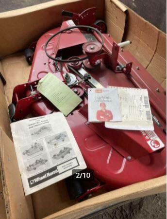

Maxwell-8 4,371 #1 Posted December 18, 2021 The unbelievable thing happend. A local seller, (which I bought the 312 from) has a NOS 42" rear discharge deck for sale. Still in the box. What would it be worth, so I can make him a fair offer. thanks! 2 3 Share this post Link to post Share on other sites

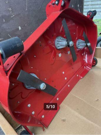

76c12091520h 4,290 #7 Posted December 19, 2021 If I'm looking at pictures correctly, that is a vertical shaft deck. The shell may be able to be adapted to fit your tractor but will not "bolt on" as it sets. I understand your location may limit your access to Wheel Horse parts/attachments but keep that in mind when pricing. 2 1 Share this post Link to post Share on other sites

Lee1977 7,805 #9 Posted December 19, 2021 (edited) Its a vertical shaft deck for a lawn tractor, but it can be adapted. If you really need a deck $600 or 700 would not be too much. The last 300 series decks were probley over $1000 Edited December 19, 2021 by Lee1977 1 Share this post Link to post Share on other sites
kpinnc 19,008 #10 Posted December 20, 2021 (edited) 11 hours ago, 76c12091520h said: If I'm looking at pictures correctly, that is a vertical shaft deck. The shell may be able to be adapted to fit your tractor but will not "bolt on" as it sets. Yes and no. The vertical shaft parts will need removing, but the mounting holes for the tach-a-matic hitch are clearly visible. The hitch from a donor will go on without modification. The only thing I can't be sure of is what the modified center scalp wheel bracket is for. Looks like the additional part of it will come off. May need a double pulley added to the middle spindle too. I'd offer $600 and go from there. The last new deck I asked about was $800 from a dealer. Vertical shaft tractors and attachments were less expensive. Edited December 20, 2021 by kpinnc 1 Share this post Link to post Share on other sites
Maxwell-8 4,371 #11 Posted December 20, 2021 17 hours ago, 76c12091520h said: If I'm looking at pictures correctly, that is a vertical shaft deck. The shell may be able to be adapted to fit your tractor but will not "bolt on" as it sets. I understand your location may limit your access to Wheel Horse parts/attachments but keep that in mind when pricing. Just realized it as well, relooking at the ad. The vertical engine WheelHorse are plentifull, the horizontal shafts are rare. at least a 20:1 ratio. 6 hours ago, kpinnc said: Yes and no. The vertical shaft parts will need removing, but the mounting holes for the tach-a-matic hitch are clearly visible. The hitch from a donor will go on without modification. The only thing I can't be sure of is what the modified center scalp wheel bracket is for. Looks like the additional part of it will come off. May need a double pulley added to the middle spindle too. I still have those parts, from the rusted-out deck that came with my C-175 1 Share this post Link to post Share on other sites
lynnmor 9,051 #12 Posted December 20, 2021 Since that apparently is a light duty deck for a 200 series tractor, i wouldn't pay a premium price for it. I believe it does not have the solid bar around the bottom edge to reinforce it. 2 Share this post Link to post Share on other sites
Lee1977 7,805 #13 Posted December 20, 2021 I have put a bar around a couple older decks. It's not a hard job start on the end weld it fast bend clamp and weld it fast about every 4 or 6 ". I used a 3/8" cold roll rod. Dad bought a bunch at the scrap yard, the reason it was there was it's so hard you can't tap treads on it easily. Share this post Link to post Share on other sites
