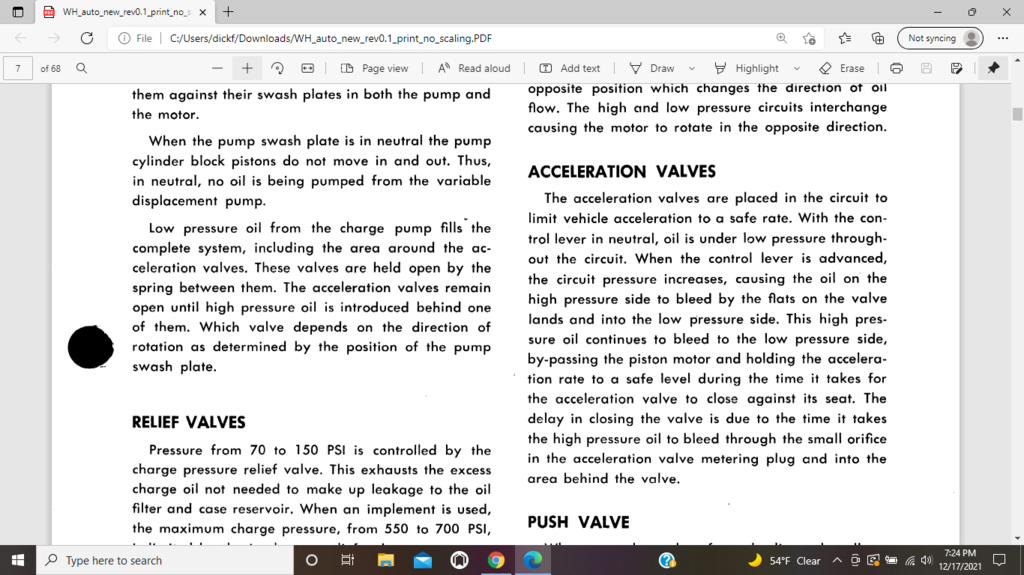

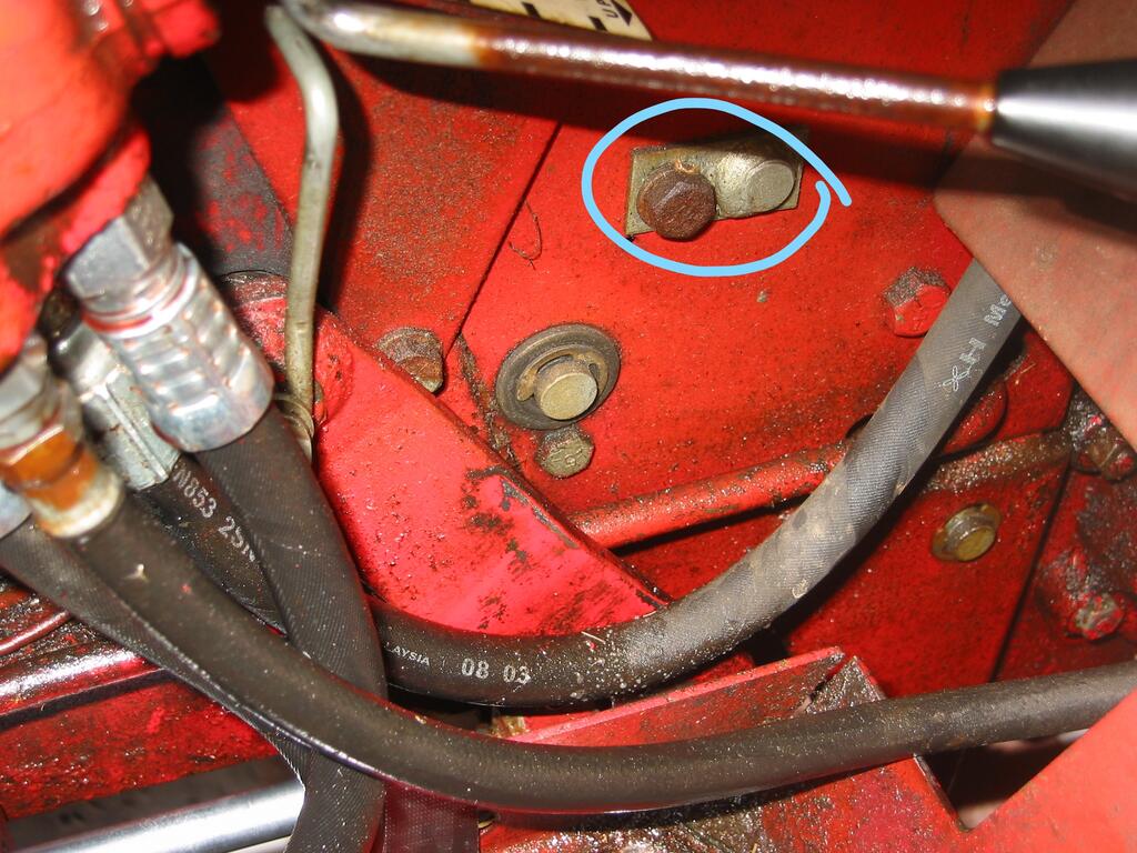

pfrederi 21,215 #2 Posted December 17, 2021 You can download the manual here Good diagnostic chart Click on picture. Is you tow valve closed tightly?? 2 Share this post Link to post Share on other sites
Jrain 276 #3 Posted December 17, 2021 4 minutes ago, pfrederi said: You can download the manual here Good diagnostic chart Click on picture. Is you tow valve closed tightly?? Yes thank you for that I did have this downloaded already and I am reading through it now , Yes the towvalve is closed so tight I could not even budge it in either direction but it does look to be closed and the tractor does not move when not running. Share this post Link to post Share on other sites

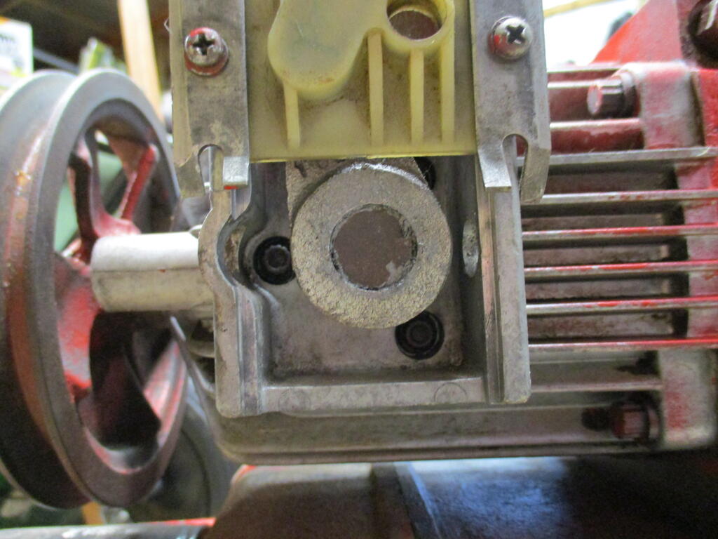

pfrederi 21,215 #4 Posted December 17, 2021 How does your plastic slider in the motion control look is it moving the shaft into the pump OK. Also is the plate tightly welded to the motion control cross shaft and bolted in place. 1 Share this post Link to post Share on other sites
Jrain 276 #5 Posted December 17, 2021 38 minutes ago, pfrederi said: How does your plastic slider in the motion control look is it moving the shaft into the pump OK. Also is the plate tightly welded to the motion control cross shaft and bolted in place. 40 minutes ago, pfrederi said: How does your plastic slider in the motion control look is it moving the shaft into the pump OK. Also is the plate tightly welded to the motion control cross shaft and bolted in place. Ok I will have to check those 2 things like I said I cleaned everything in there until I felt all was operating smoothly ,I did not look behind the slider after cleaning it to check and if the shaft was moving properly , How far does the the shaft move in to the pump what type of movement am I looking for , as far as the weld and bolt on the cross shaft I will look to see if it is ok. Thanks for the good advice Share this post Link to post Share on other sites
pfrederi 21,215 #6 Posted December 17, 2021 (edited) As the plastic slider moves up and down the shaft in the center should move Edited December 17, 2021 by pfrederi 2 Share this post Link to post Share on other sites
953 nut 69,727 #7 Posted December 18, 2021 1 hour ago, Jrain said: it does have hydraulics and they do work at any engine speed OK, this tells you the pump is working. My guess is that your acceleration valve springs may be broken. The springs take a pounding when the tractor is rapidly shifted from forward to reverse and when they are broken the symptoms are as you have described. 1 Share this post Link to post Share on other sites
Jrain 276 #8 Posted December 18, 2021 4 minutes ago, 953 nut said: OK, this tells you the pump is working. My guess is that your acceleration valve springs may be broken. The springs take a pounding when the tractor is rapidly shifted from forward to reverse and when they are broken the symptoms are as you have described. OK thank you for your diagnosis and as I was reading the trouble shooting guide it did lead me in that direction on either a issue with as you said the acceleration valves or the charge valves and already printed off the directions on the disassembly repair and assembly of these valves , So your post gives me hope that the issue is not catastrophic or a difficult fix. Thanks for your input and help 1 1 Share this post Link to post Share on other sites

squonk 48,207 #10 Posted December 18, 2021 The large shaft in Paul's pic. Make sure the allen screw inside the arm that attaches to that shaft is tight. Share this post Link to post Share on other sites
Jrain 276 #11 Posted December 24, 2021 So had some time today to look at the transmission issues , first thing I found was the cam housing plate (cam guide frame ) that is attached to the trans was very loose the 2 allen screws were almost backed all the way out So I pulled the entire shifter assembly out to gain access then noticed the brake spring was disconnected and a mess so took care of that I was able to disassemble the entire cam mechanism pulled it all out cleaned and put it all back in using loctite on the allen screws , cleaned lubed the shifter mechanism and got everything in there working properly Then I proceeded to look in to the acceleration Valves ,so being I have a little experience with theses valve because I added hydraulics to my c120. and being this auto 16 has hydraulics it should have the same added internal parts kit for hydraulic operation , I noticed right away when I took the forward cap off , the spring came out but not the ball , I put a magnet in to the cavity to retrieve the ball and nothing , so then I probed around in the cavity with a pick , I could feel the ball lodged in the corner so to speak , offset not center in the cavity, I then removed the hydraulic hose from the intersecting side and probed in that cavity, I left my magnet in the other cavity incase the ball got released , again I could feel the ball lodged in the side, Not centered in that cavity either ,and there was enough gap along side of the ball where my pick fit through and moved the magnet that I had placed in the other cavity. So I feel this is my issue . the ball somehow is very tightly stuck it will not move at all , I do not want to force anything till someone with experience can tell me what I should do at this point . 1 Share this post Link to post Share on other sites
