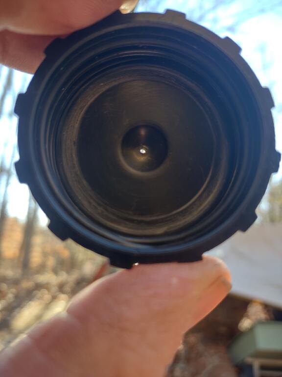

ebinmaine 80,642 #1 Posted December 17, 2021 I have a c-160 gas tank that has no gasket inside the cap. As you can imagine considering there's a hole in the center of the cap that leaks quite a fair amount. What can I make a vented gasket from and where do I put the vent hole in the gasket itself? Share this post Link to post Share on other sites

ebinmaine 80,642 #4 Posted December 17, 2021 5 minutes ago, Achto said: Most of those have a rubber or cork gasket ring, with nothing over the vent hole. 3 minutes ago, 8ntruck said: baffle This is what I've got guys Share this post Link to post Share on other sites

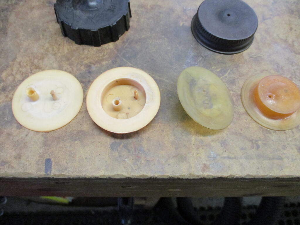

pfrederi 21,145 #5 Posted December 17, 2021 These are from a red tank and a black plastic tank on Chargers but should be very similar. Two piece operation with internal tubes.. offset 2 1 1 Share this post Link to post Share on other sites
pfrederi 21,145 #6 Posted December 17, 2021 You cap looks just like my plastic one on the left. 2 Share this post Link to post Share on other sites
ebinmaine 80,642 #7 Posted December 17, 2021 2 minutes ago, pfrederi said: You cap looks just like my plastic one on the left. Agreed. Maybe I could make up a double layered gasket with the middle hollow and then punch a couple holes in the other layer so they won't line up with the cap orifice. 1 Share this post Link to post Share on other sites
