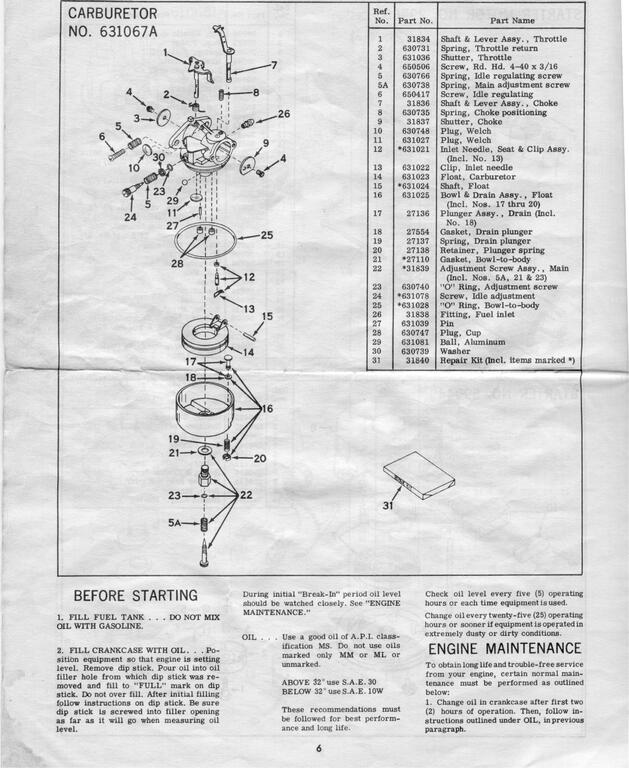

Handy Don 17,489 #4 Posted December 17, 2021 (edited) I'm adding apologies for missing the mark and corrections to this post since it appears that the technique varies. You measure Tecumseh oil level for some models/builds by resting the head of the retaining screw in the cap against the shoulder of the hole in the engine. That way neither the tightness/looseness of the retaining screw nor the depth of screwing in the cap affect the reading. For these models If you've been measuring measure by screwing in the cap, you are running your oil level too low. For other models/builds, the cap must be fully screwed in. On these, I assume the stick should be attached to the cap snugly but able to swivel. Apparently, instructions should be stamped into the dipstick. Scroll down to post #8 for an example. (Slide-in dipsticks are always fully seated to get the correct measurement.) Edited December 17, 2021 by Handy Don 1 2 Share this post Link to post Share on other sites

pfrederi 21,176 #8 Posted December 17, 2021 1 hour ago, Handy Don said: You measure Tecumseh oil level by resting the head of the retaining screw in the cap against the shoulder of the hole in the engine. That way neither the tightness/looseness of the retaining screw nor the depth of screwing in the cap affect the reading. If you've been measuring by screwing in the cap, you are running your oil level too low. (Slide-in dipsticks are always fully seated to get the correct measurement.) No Tecumseh specifies you screw it in to get a reading and yes it should swivel around 1 Share this post Link to post Share on other sites
Handy Don 17,489 #9 Posted December 17, 2021 Dang it. I had an owner manual from the snowblower's H60 that said otherwise and assumed it was a class thing. Now I'm gonna go back and edit the earlier posts to specify that you have to look at the manual for your engine as it looks like it is build-specific. Share this post Link to post Share on other sites
