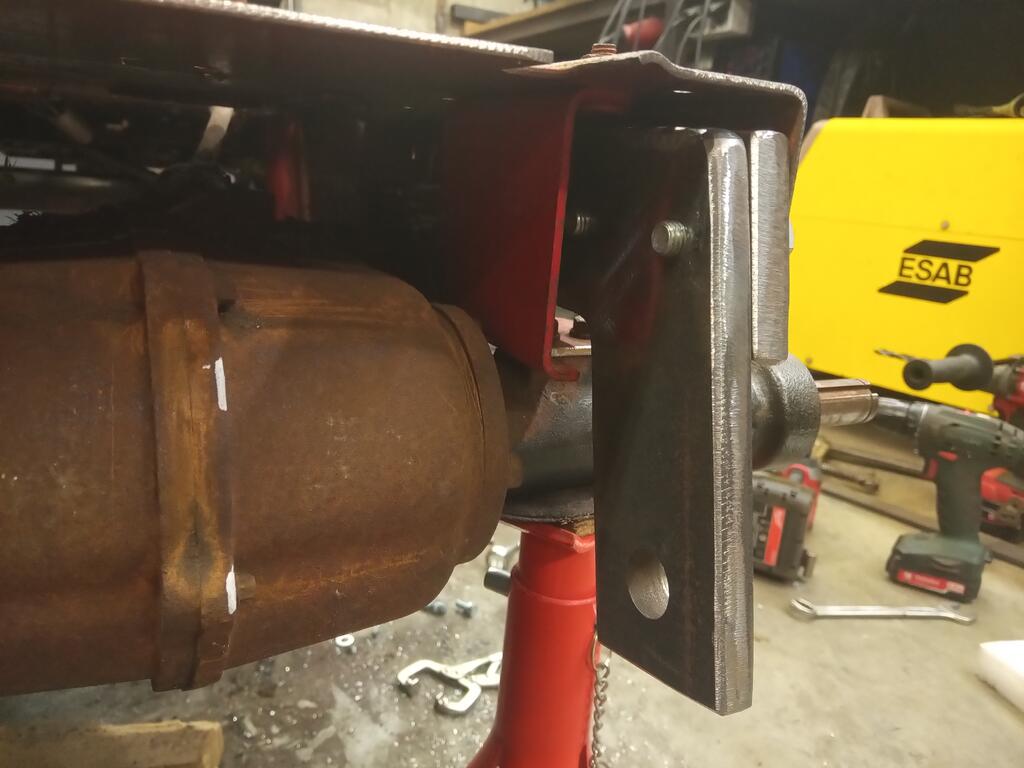

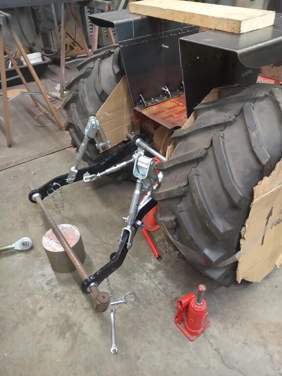

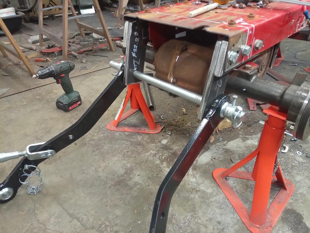

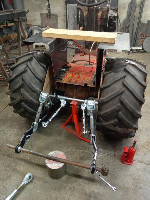

Since the previous post i've been tinkering away.. I think the three point is a go!
  • Like 3
  • Excellent 5
ebinmaine

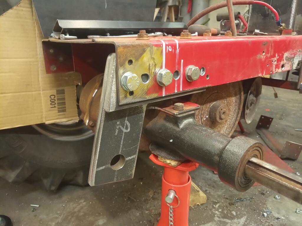

What kind of weight capacity are you looking for?
Will the stamped steel frame hold that amount or are you adding reinforcement?
  • Like 2
I bet you would be surprised
  • Like 2

1 hour ago, ebinmaine said:
weight capacity
Good question.. i'm not really sure. Probably going to end up overbuilding everything and never lifting more than 200lbs :confusion-shrug:
About the frame. I'm going to strengthen it as much as possible, or well, at least until i'm satisfied. I think i'll double up the thickness of the frame where the 'l-brackets' mount to prevent tearing. I'll also connect the two l-brackets with a brace to prevent side to side flexing.
  • Like 2
  • Excellent 5
Oldskool
Quite strong, that?
I'm sure it could lift the frontend without any issue
  • Like 3

1 hour ago, Oldskool said:
lift the frontend
Have you not seen my grille and frontweights?? :confusion-confused::P
  • Like 1
  • Haha 4
I have.
I'm just saying I bet the frame will hold up to the point of the front lifting up from 3pt use in extreme circumstances.
Or do you think it will fold?
  • Like 2

8 hours ago, Handy Don said:
Not much "Murray" left
Thanks! No not really.. if I ever attempt something like this again i'll probably just use the components I need, transmission and engine, and build the rest from scrap. That being said, this whole project kinda snowballed a little bit :blink:
I certainly hope not! Like I said most of the time I tend to overbuild things so I'm guessing it will be allright.
Wouldn't wanna find out by trail and error though :hide: so i'll just add a little more bracing 😁
