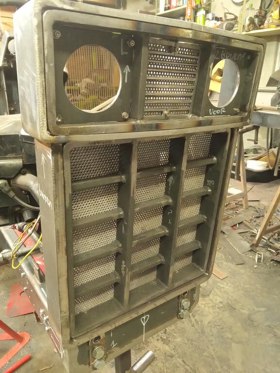

Drilled some holes and finally found some led lights that are the size that I want, have a nice, somewhat 'oldschool' lens on them, all without being extremely pricey. The lights will get a bezel to film in the gap while still being able to adjust them.
Then I installed some mesh behind the grille. Not sure if I like the look of it. I would have liked it to be more open or 'holey' :P
What do you think? Any tips on where I might find more open mesh?

ebinmaine
Fleabay maybe.
Your version of our big box home supply store?
Do you have a metal fab shop local?
Some places that can get "expanded" steel might also be able to get "perforated" steel or aluminuminuminum.

Oldskool
I'm not sure of the size of your grille but I have gotten some good screening from air filters. Ones you would see from a large gravel truck,  a long haul type truck or heavy equipment.

ebinmaine
That's bordering on the craziest damn thing I hoid. I love it.

SylvanLakeWH
Looks ok to me, but if you are still looking search “screen door protector” and a bunch of pretty cheap options will pop up… :eusa-think:

sjoemie himself
Yes i do. That is where this piece came from. Seems all they use is the heavier stuff. So more steel than holes I guess 😁
9 hours ago, Oldskool said:
from air filters
 I like this idea but i'm unsure where I would find a used filter that is big enough. The screen should be about 15" square.
Good one! That's pretty close to the metal vs. air ratio i'm looking for. I'll take a look around Giggle or Amazonia to see if someone near me has these available.

Oldskool
I get mine from some local big truck repair shops, also local scrap yards..
I just go in and ask. They usually tell me if there is one in the dumpster its mine. Some can be 14-18"H x 6-8"W. Cut off and unrolled it should be big enough
  • Like 4
Handy Don
14 hours ago, Oldskool said:
This image made me think of those wire mesh waste baskets that go under ones desk. I have one in the garage right now!

EB-80/8inPA
McNichols can provide you just about anything you want, but it won’t be as cheap as a recycled trash can.

sjoemie himself
I'm sure they can. Problem would be shipping it to the Netherlands :happy-jumpgreen:
Jokes aside, i've tried similar adresses locally aswell, point is that new perforated and/or expanded metal is pretty expensive. Plus most of it isn't as 'open' as I would like it to be.
So I think i'll go for the garbage basket idea for now.
Giggle let me stumble across metal speaker mesh. That is small and 'holey' enough only catch is finding a big enough piece.

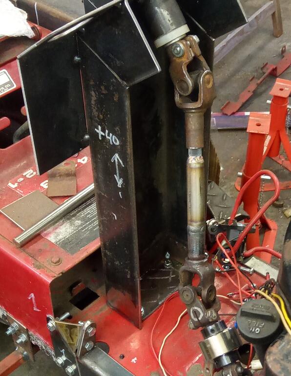

ebinmaine

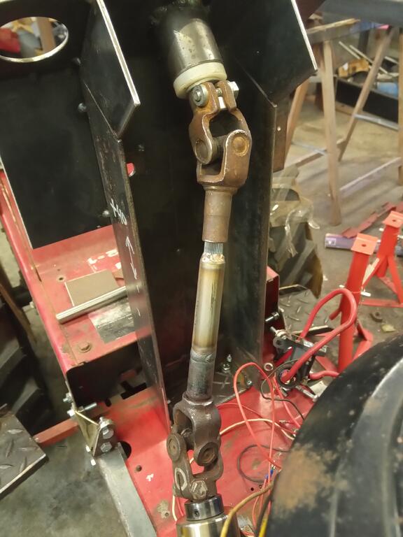

17 minutes ago, sjoemie himself said:
Cut the base of the steering console and added said ******. This also meant I had to extend the steering shaft
Excellent idea.
The Colossus project steering tower height needs to raised as much as 4" (75+mm).
Usage of this setup could prove beneficial.
  • Like 1

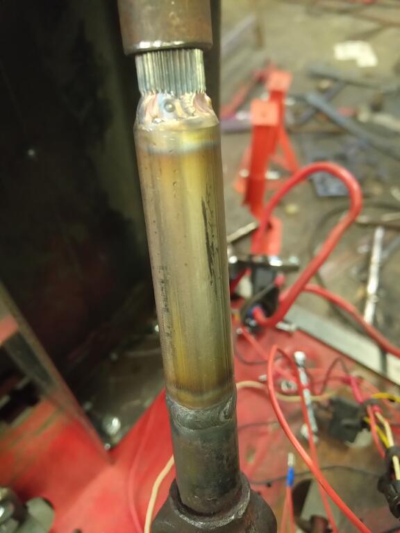

sjoemie himself
4 hours ago, ebinmaine said:
Excellent idea
Thank you. Works quite well.
The universal joints came out of various cars from the local scrap yard and are top quality for an unbeatable price. One piece even has splines which proves to greatly aid in easy (dis) assembly during the build phase.
  • Like 2
  • Excellent 3

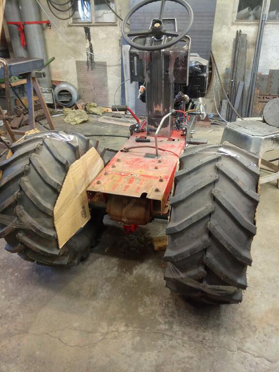

sjoemie himself
Thoughts, yes or no?
  • Excellent 7
