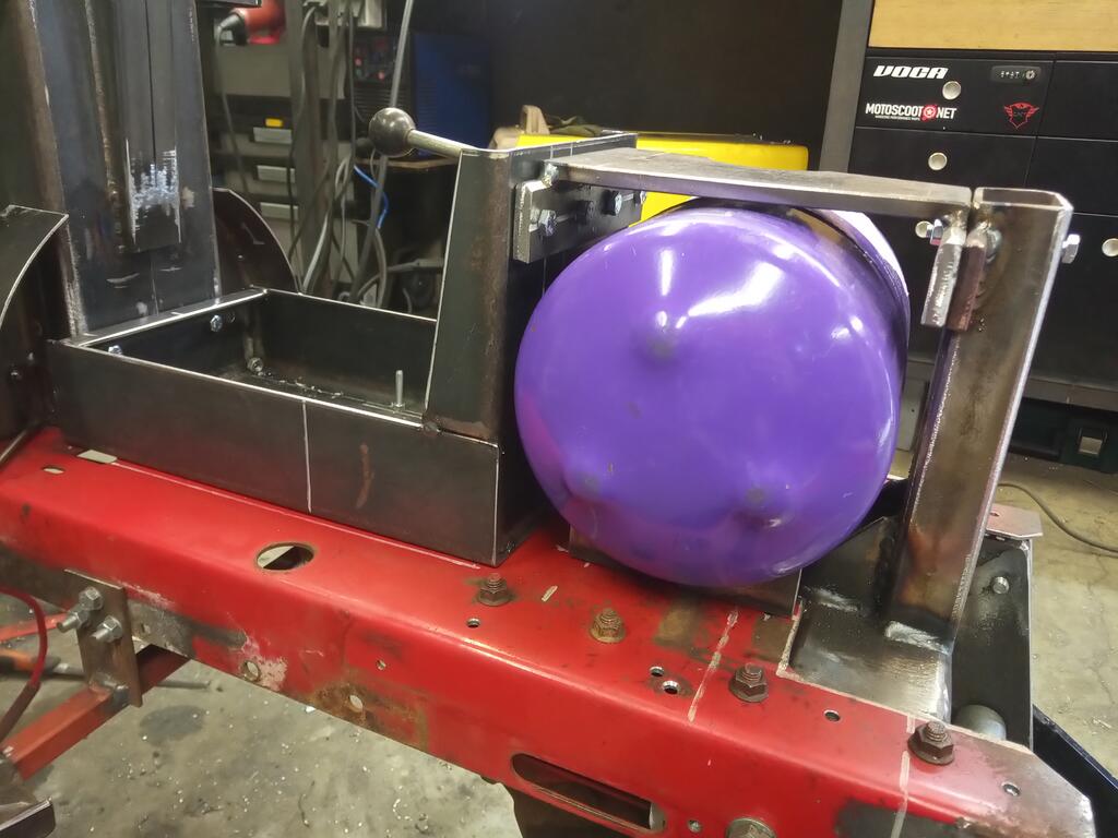

Oldskool

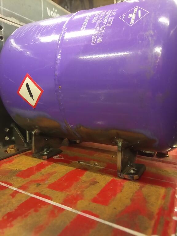

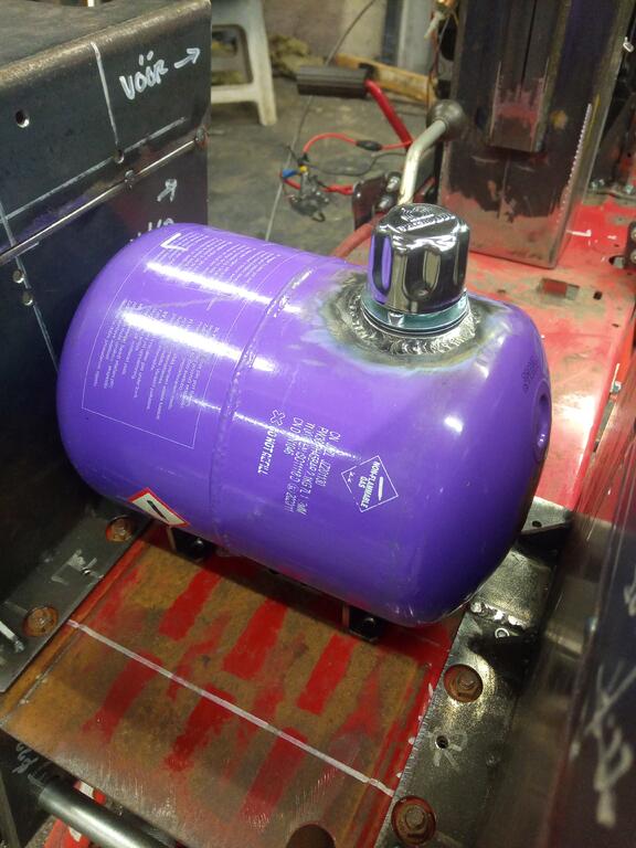

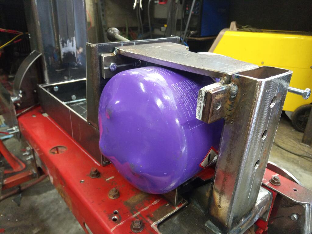

Thats looking quite stout.
Nice use of the helium tank by the way.
"Use what ya have".
I like it.
sjoemie himself
20 hours ago, ebinmaine said:
Use what ya have
Keeps the cost under control.. well.. sort of anyways :confusion-confused:

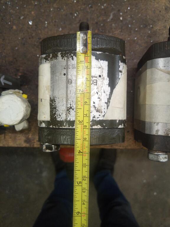

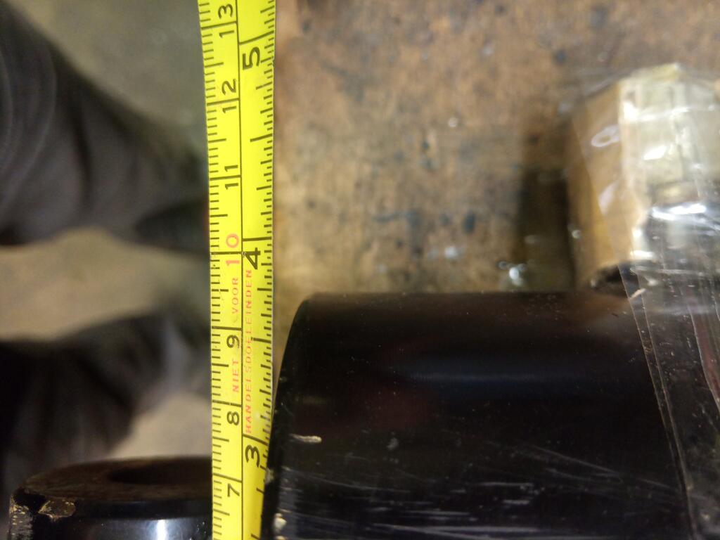

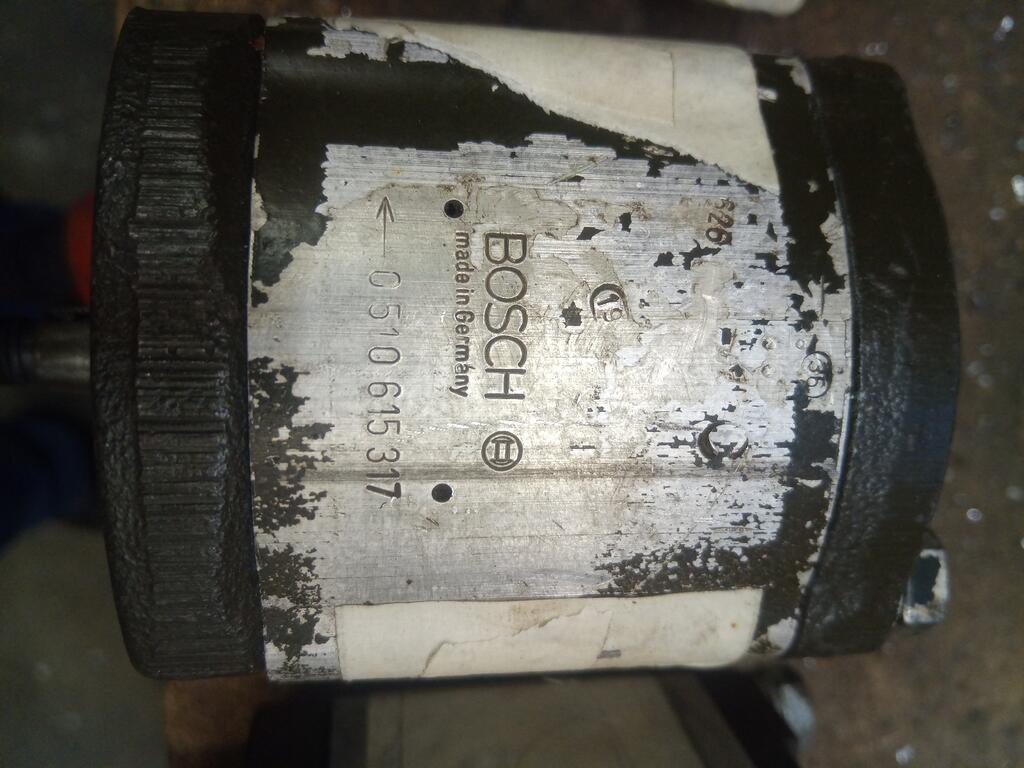

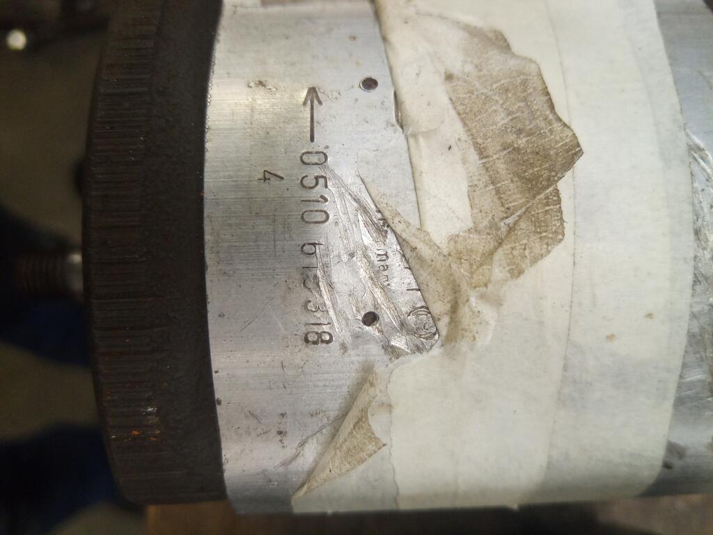

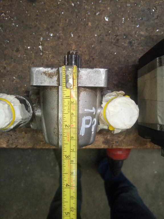

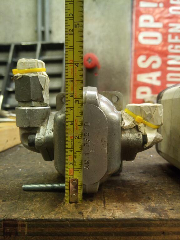

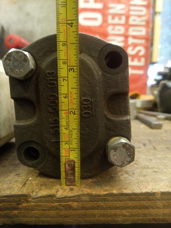

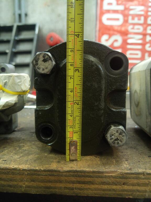

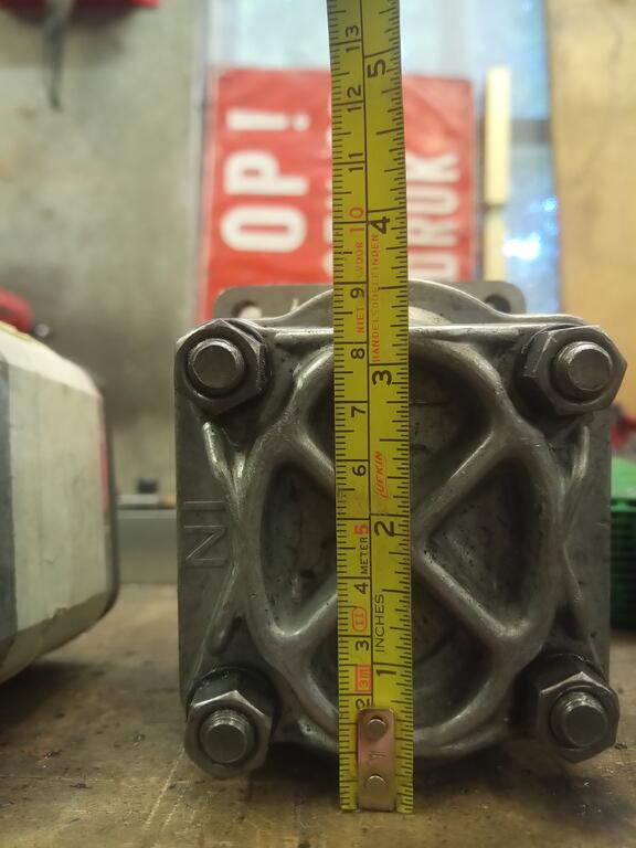

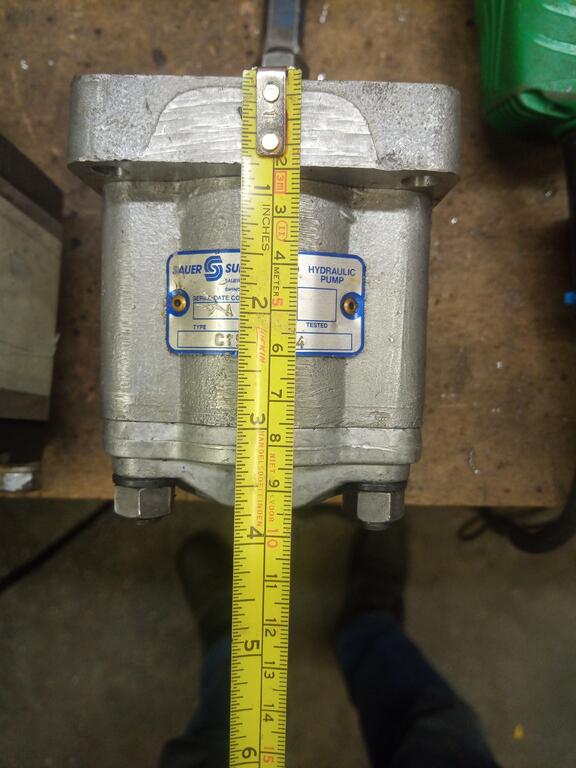

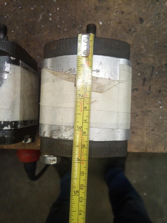

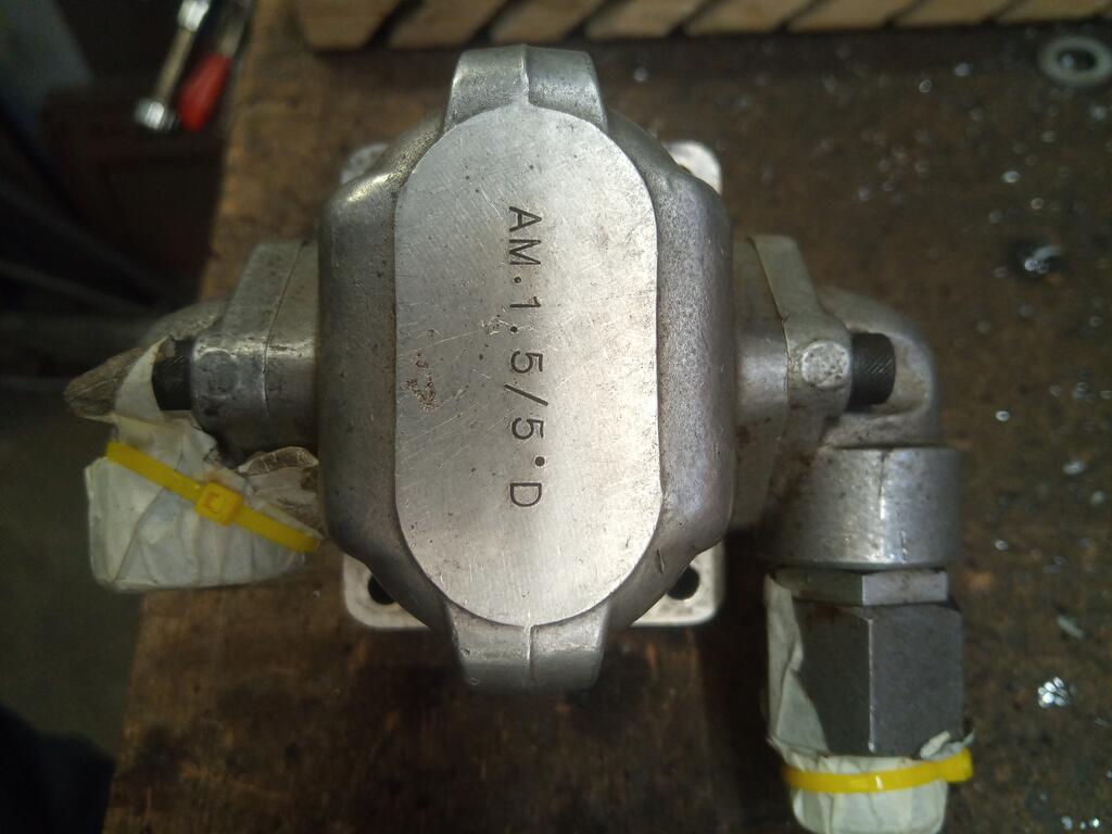

Calling on all hydraulic experts! I've got four hydraulic pumps to choose from but unfortunately haven't been able to find much information on either of them.
Can someone enlighten me with either the specs of (one of) these or their vote on which pump they would use on their tractor?
Engine that will be driving the pump is an 18hp briggs. I would like the pump to handle the rear 3 point and atleast one external valve for a tipping trailer. When possible a hydraulic pto or dual external valves for turning an implement would be great.
Pictures and measurements of my options are below.
All input is very much appreciated!

WHX??
Striking out here on any of those numbers as well. Found abit on that Bosch but no specs. Does it have a tapered shaft?
Sure would be nice to see the specs on the one you use. Maybe one of the other fellas will have better luck.
Handy Don
I would try to start with the the loads and volumes. For that, you'll need the sizes of all the cylinders (piston diameters and throws) and the forces they'll be expected to exert. You'll also have to estimate the lengths of hoses/tubing involved.
For example, a big cylinder or long might be able to exert a lot of force or have useful throw but with a small pump it will take a long time to fill!
As for the pumps, there are three key specs: volume per revolution , maximum working pressure, and max RPM.
You could test for the volume by hand (prime the pump and then count the hand-turned revolutions needed to transfer a set volume of oil from one container to another).
Max pressure is likely in the range of 1000-2000 psi but that is strictly a guess. The physical characteristics of the pump have very little to do with pressure.
And don't forget, in your design, a pressure relief valve--you need the specs to be sure.
Max RPM is also going to come from specs.
sjoemie himself
@WHX?? and @Handy Don I had a bit of a 'eureka' moment and found some specs of the Bosch pumps:
Pump 2:
  • Max. working pressure 250 bar/3600 psi
  • Volume per revolution 16cc or 0.97 ci
  • Max. rpm 3500
  • Min. rpm 800
  • Rotation counterclockwise
Pump 3:
  • Max. working pressure 250 bar/ 3600 psi
  • Volume per rotation 19cc or 1.15 ci
  • Max. rpm 2000
  • Min. rpm 1000
A while ago I ordered the plans from PF engineering for one of his FEL. He suggests using a pump with 4 to 8 gpm, that is about 15 to 30 l/min.
With some math added to my pump specs I get this:
16cc per rev. @ 3200 rpm = 51.200 cc/min (51 l.min or 13.5 gpm)
19cc per rev. @ 3200 rpm = 60.800 cc/min (61 l/min or 16 gpm)
Taking into account that a front end loader uses a lot more cylinders, aka. oil that needs displacing, it seems that even with the smaller pump I could reduce the input rpm on the pump to about half the engine speed and still have plenty oil??

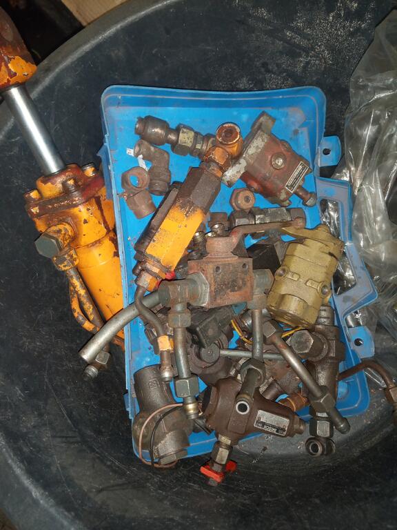

does either Pump 3 or Pump 2 have built-in pressure relief? Do you already have any control valves you plan to use?

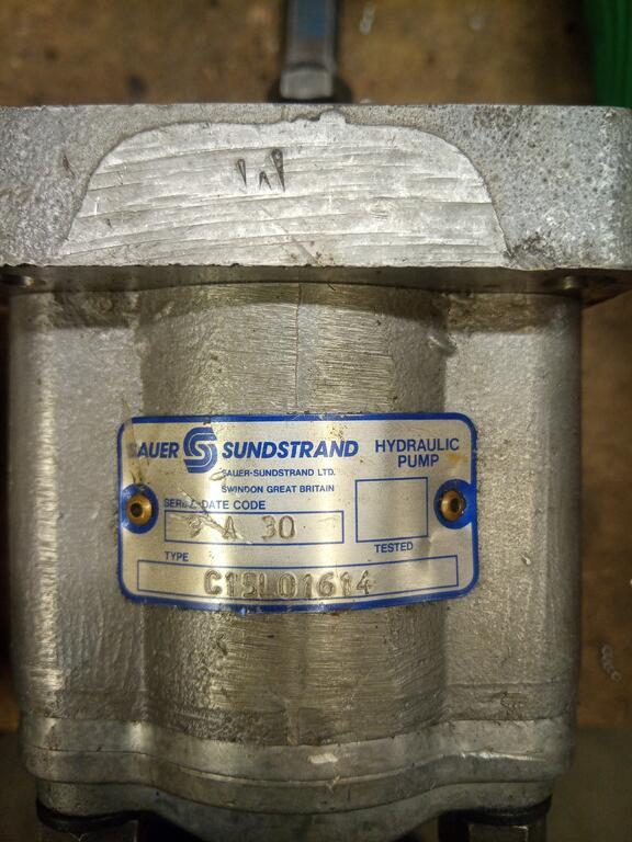

 Don't know, and maybe?? See picture below
We have a site in the Netherlands called 'marktplaats' or marketplace. That is where I buy most of my components.

Almost forgot.. visited two company's today and the last one seemed to be 'the' place. Shelves full of hydraulic components and the people looked like they knew what they were talking about.
They said the Bosch pumps are probably too big and advised to use the Sunstrand one. They're gonna check out the pump to see if they can change the rotation and if there's a bearing-block available to be able to drive the pump with a pulley.
Also left my cylinder so they can quote me what it would cost to rebuild it with some new seals.

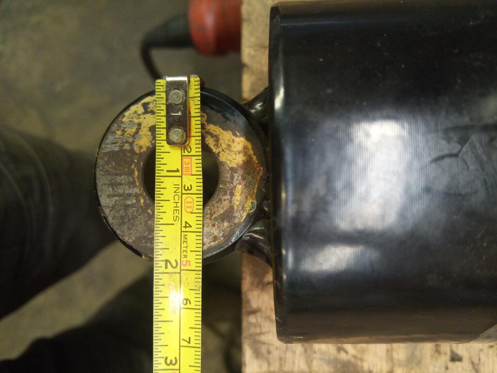

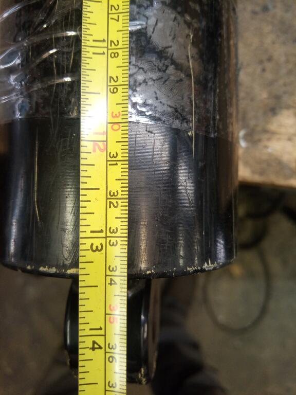

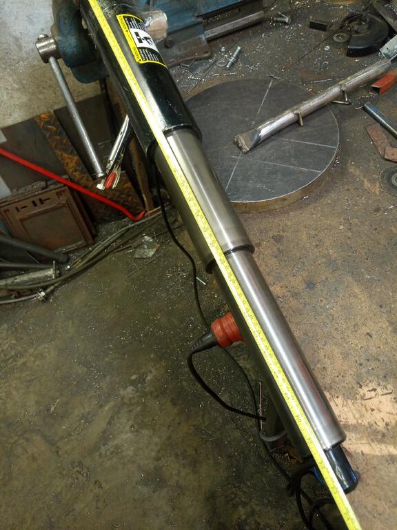

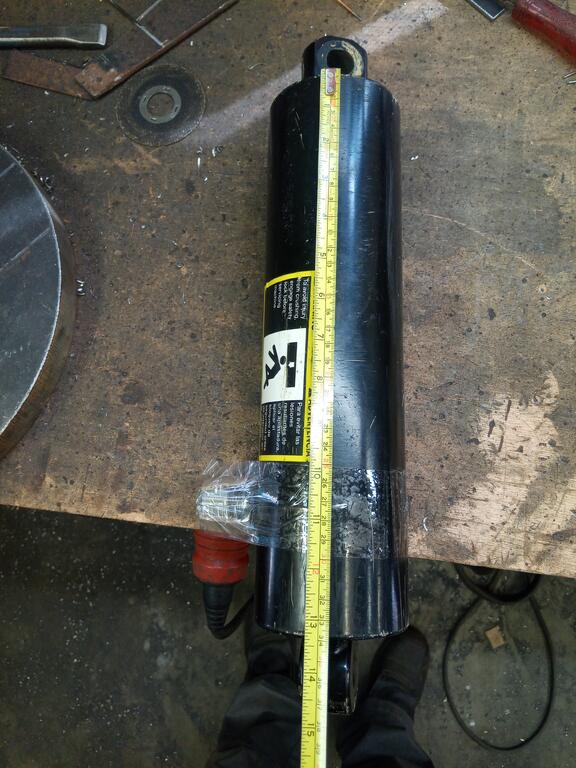

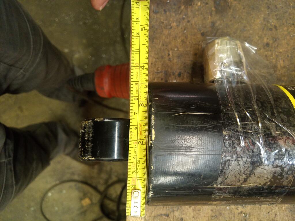

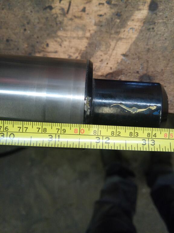

Mailman came through with my cylinder today. It's a little bigger than expected but that an okay problem to have.
Sadly did not hear from the hydraulic shop all week so I couldn't work on the pump setup today.
Pictures below of the cylinder for the upcoming tipping trailer.
  • Excellent 4
Handy Don
VERY cool!
Having the telescoping cylinder lets you avoid a complex (and hence strong and heavy) scissor or lever mechanism for hoisting the trailer.
You can calculate the volume of the extended cylinder and use your expected pump volume to arrive at a likely "lift time".
Also, it looks like that cylinder is powered only for extend (the retract is by gravity or other external force on the lifted body). Be sure to take that into account when setting up the plumbing and valve, and when thinking of how it will operate.
sjoemie himself
Thanks Don. I'm pretty pleased with the cylinder aswell. It was bought sight unseen and although it's bigger than I thought I think it will work fine.
Correct! It's a single acting cylinder. Should be enough for my build. In case it doesn't 'return' all the way or not fast enough I can always add a spring or something.. but we'll cross that bridge when we get there

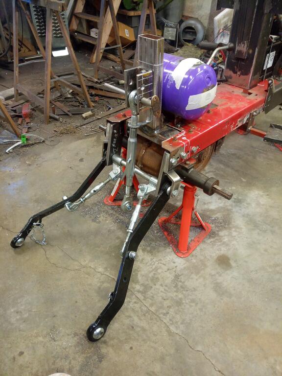

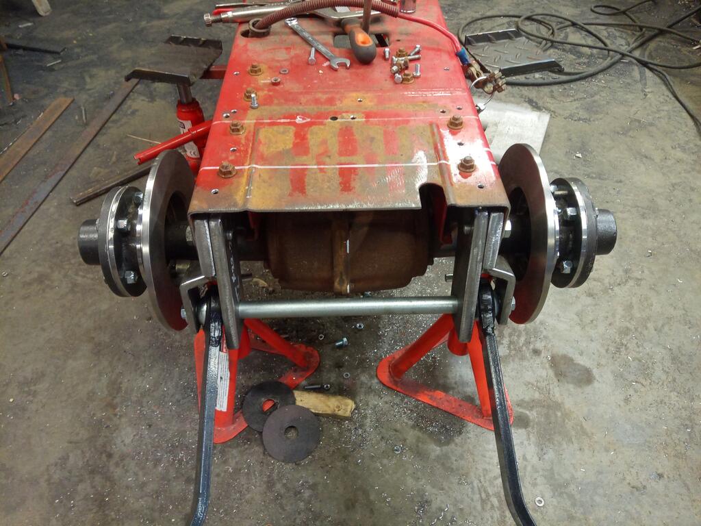

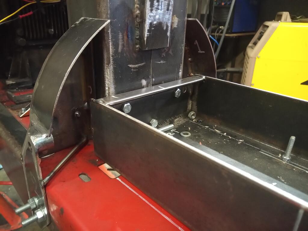

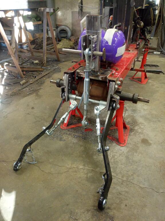

Brace yourself.. bracing incoming.
Made several braces to beef up everything and connect the exsisting  frame to the subframe for the 3 point hitch. The 'tower' for the toplink gets bolted to a plate which also doubles as the seat mounting base. This plate connects to a u- channel which bolts to both the frame and the steering column. Should be okay-sturdy
  • Excellent 7
I should say!
