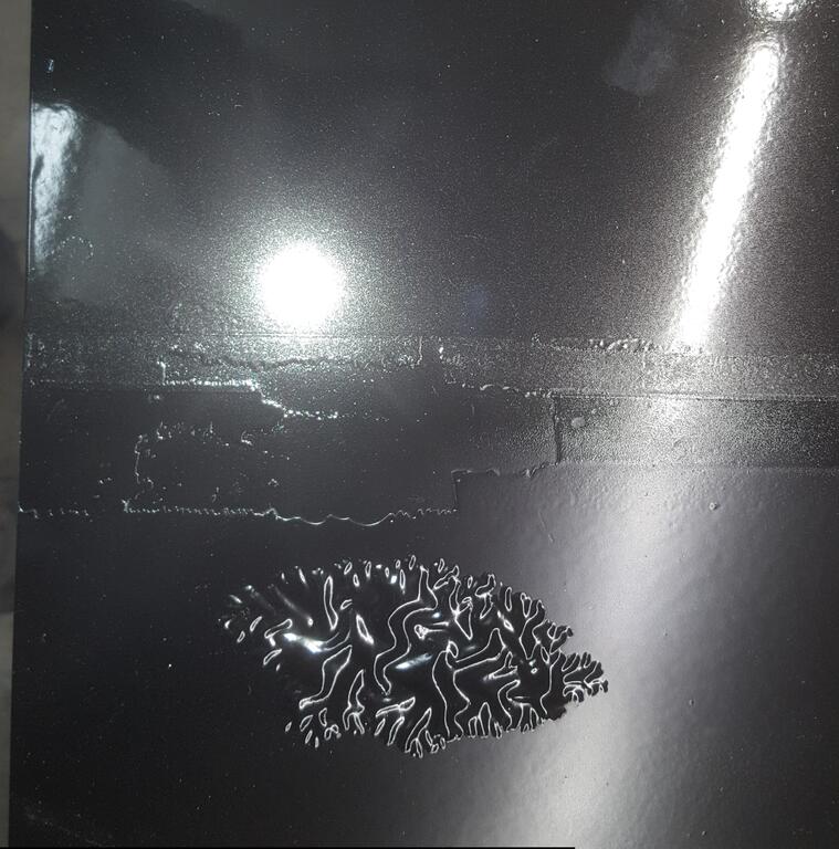

pacer 3,179 #3 Posted December 16, 2021 @Maxwell-8 is spot on ..... In yrs past when lacquer paint was easily bought, I loved to paint with it. But, using it you would dramatically see what would happen if you sprayed over regular enamels it would .... 'craze/krinkle' (I think those were the terms) and you would have to go to bare metal to get rid of it. Although lacquer isnt readily available now, this result could still happen - tho probably not as dramatic - if two different .... brands? were used. Best bet is to do a 'test' piece. A total nuther problem you can run into when painting is getting "fish eye" ((thats a very good name, describes it perfectly) Silicone is the primary reason. With so many products having silicone in them it can jump up and bite you! We had bought a nice dining table/chairs and after several yrs the paint was really bad (ice in glasses sweating) Well over the years my wife and I faithfully had shined it up with Pledge - almost pure silicone! So, I go to gun paint it, sanded it down to where I felt like I had removed all of it .... started spraying, before I got thru the 1st coat it was fish eying BADLY. So I went and got my bottle of fish eye retarder to add a few drops in the next gun ..... and sanded it down - again! better but ..... On the THIRD sand down and repaint - I tried something different and held the gun up over my head letting the clear coat drift/float down in a light misting, pausing between each coat, after about the 3rd/4th coat was still looking good so finished up with 7-8 coats and got a good finish. I mention this because most car wax - all? - have lots of silicone and there are quite a few on here wax the horses.... 2 Share this post Link to post Share on other sites

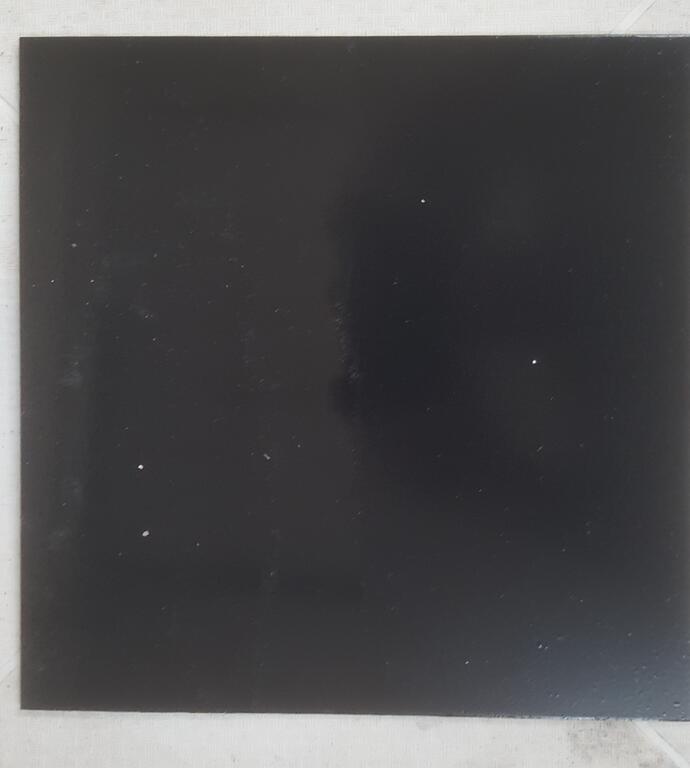

Gregor 4,847 #7 Posted December 16, 2021 I wasn't sure if it would show up in a pic, but it sort-a does. Just a piece of scrap metal. Share this post Link to post Share on other sites

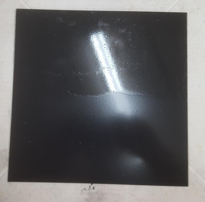

Gregor 4,847 #9 Posted December 16, 2021 That's exactly what I did with these pieces. The first piece, a bit too much, a bit too soon. The second piece was better. Share this post Link to post Share on other sites
