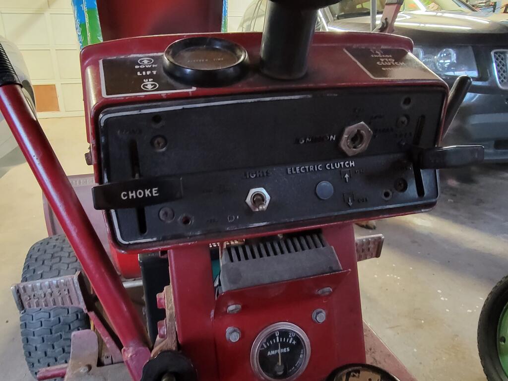

Wmcupp 1 #1 Posted December 15, 2021 1975 c100 trying to install a new light to the front and rear problem I'm having is I cant get the metal plate off that's behind this black plate my question is am I gonna have to remove the gas tank to get back there? Share this post Link to post Share on other sites
squonk 47,991 #2 Posted December 15, 2021 Gas tank should be the fuel line and the spring that holds the tank in. Pretty easy. then you can get to the light switch. 2 Share this post Link to post Share on other sites
Wmcupp 1 #3 Posted December 15, 2021 (edited) 1 hour ago, squonk said: Gas tank should be the fuel line and the spring that holds the tank in. Pretty easy. then you can get to the light switch. Yeah it doesn't look to bad just wanted to make sure that I'm going about this the right way Edited December 15, 2021 by Wmcupp Share this post Link to post Share on other sites
oliver2-44 11,716 #4 Posted December 15, 2021 Sounds like Squonk has you fixed up. Share this post Link to post Share on other sites
squonk 47,991 #5 Posted December 15, 2021 While your in there clean up any dirt / corrosion on the ignition switch and plug. 2 Share this post Link to post Share on other sites
Wmcupp 1 #7 Posted December 15, 2021 31 minutes ago, squonk said: While your in there clean up any dirt / corrosion on the ignition switch and plug. thanks for the tip definitely will do that 1 hour ago, oliver2-44 said: Sounds like Squonk has you fixed up. yes he does thankfully the tank was pretty much empty Thanks Squonk! 1 Share this post Link to post Share on other sites
