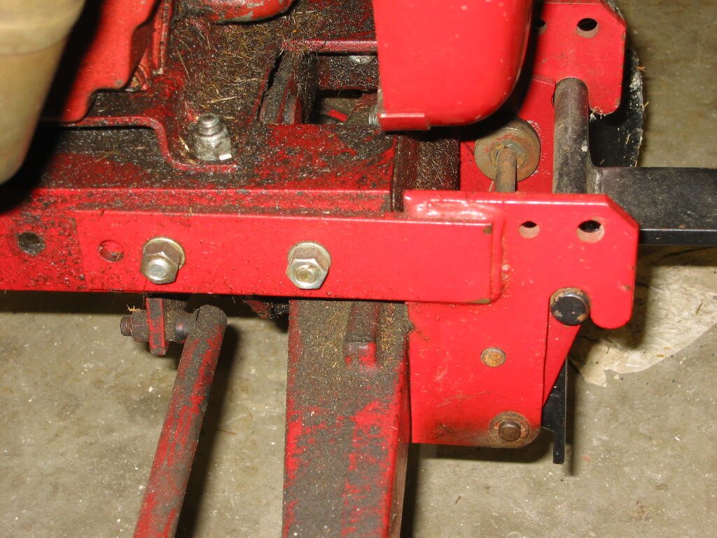

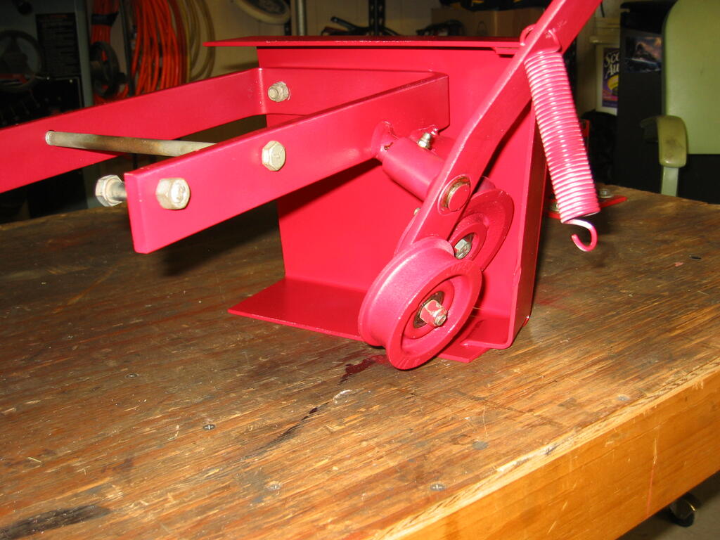

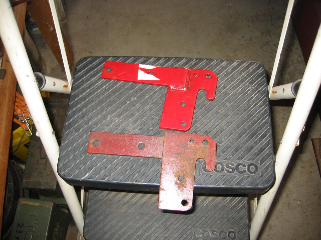

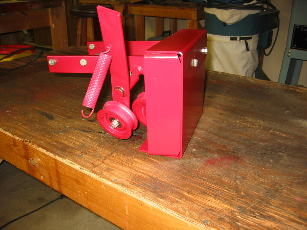

pfrederi 21,046 #4 Posted December 14, 2021 The raider could be had with a short lived front mount mule drive (pic1/2) that bolted directly to the frame. They are not real common. As an alternative you could get a set of these adapters (pic 3/4) that bolt on to the frame and let you create a modern front tachmatic to which you can mount a new style mule drive.. Search on here there are a couple threads that show you might bolt a modern tach matic to the front of the frame some drilling required,. Share this post Link to post Share on other sites
