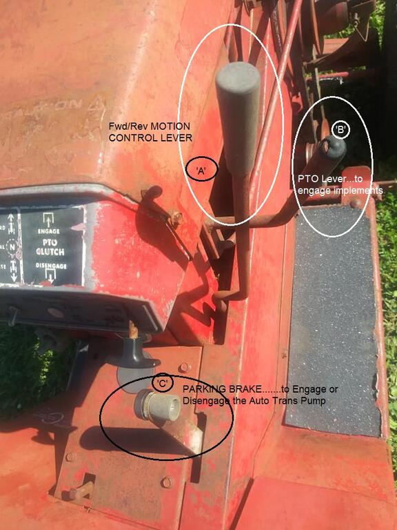

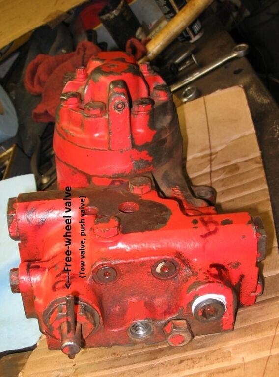

daveoman1966 3,839 #2 Posted December 14, 2021 The GT-14 has a Sundstrand Hydrogear and can be pushed SLOWLY by turning the PUSH/TOW VALVE ...aka 'Free-wheeling Valve'. The Valve is on top of the Hyd Pump END CAP and looks like this. Turn the valve 90 degrees to push/pull the tractor...SLOWLY. You will also need to release the PARKING PAWL (brake) to push/pull the tractor by engaging the hydro pump...as if the tractor was running.... Similar to this BRAKE LEVER (C) in this 2nd photo. (2nd photo is a C-120---don't have pic of GT-14 lever, but is similar function.) Share this post Link to post Share on other sites

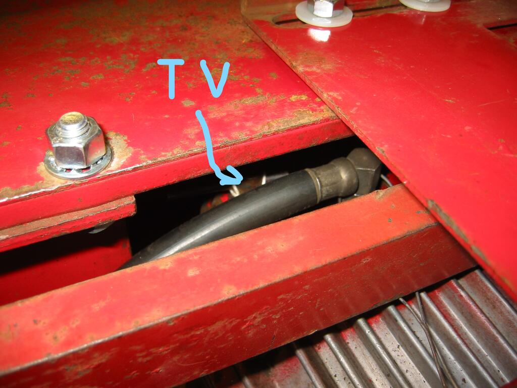

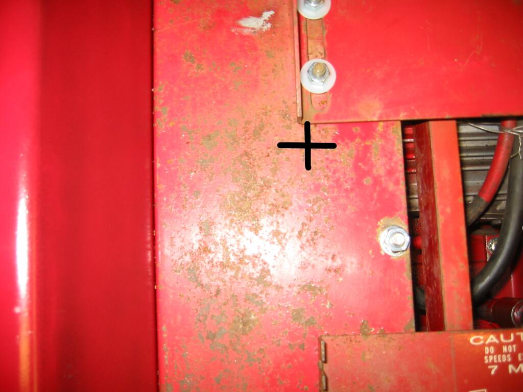

pfrederi 18,633 #3 Posted December 14, 2021 (edited) The tow valve on a GT-14 is cleverly hidden under the seat.. I finally drilled a hole at the black X so I could move the valve (Blue TV) more easily. Edited December 14, 2021 by pfrederi 1 1 Share this post Link to post Share on other sites
