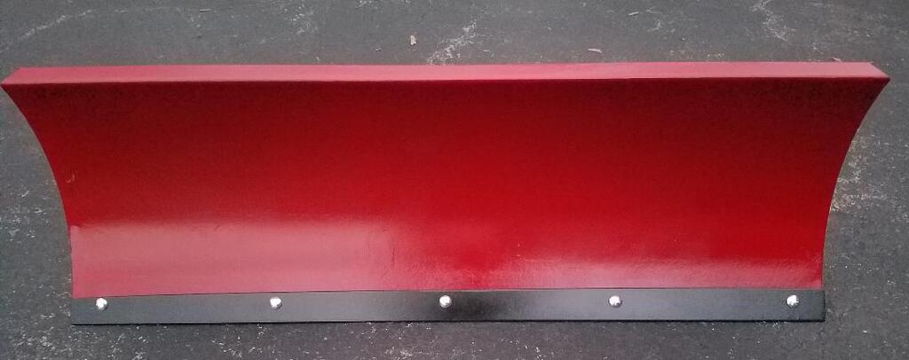

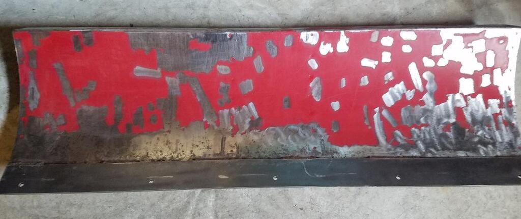

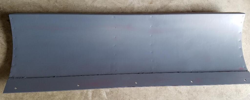

Brockport Bill 2,481 #26 Posted February 10, 2022 On 12/13/2021 at 12:13 AM, Jeff-C175 said: You can get a better deal at Amazon: https://www.amazon.com/gp/product/B092Z4NV7G I've used a lot of these and they compare favorably to the HF ones, in fact they might be the same thing. i've been using those purple Amazon grinder sponge looking discs with my 90 degree angle grinder - work great to clean rust -- i prefer to avoid Amazon if possible.... but had not been able to find them elsewhere - HD etc -- I do use the mini Ingersol Rand air grinder with 1 or 2 inch discs for tight spaces........... but the Scaler noted in this thread is wonderful for certain rust applications - especially in tight seams and cracks or really heavy chunky rust -- Scaler is especially useful in 90 degree corners ..... I use whatever rust removal tool works best,---- Here are some photos of plow blade rehab projects - just did rust removal with grinders/scaler - then hand sand paper, then soap and water then primed -- doing final red paint today in warm sun - also attached is plow i finished last months project - I have had sand blasting done for my mowers, but the plows just need the spot grinding then prime and paint. 1 6 Share this post Link to post Share on other sites
