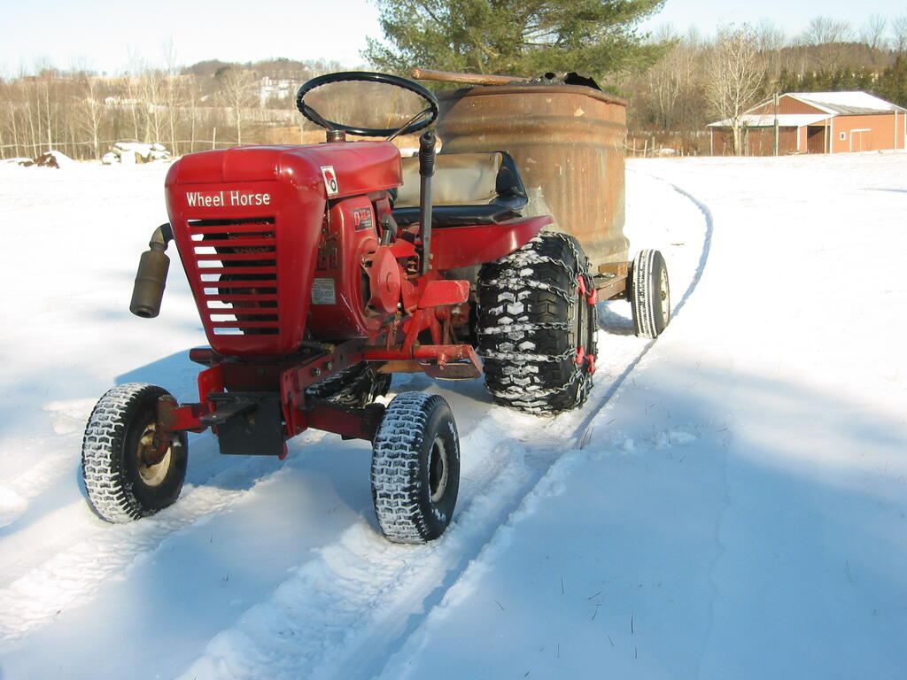

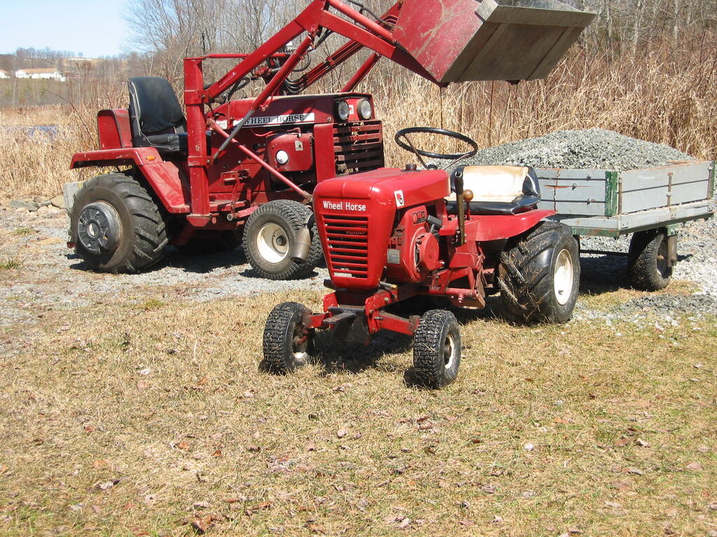

pfrederi 19,874 #12 Posted December 13, 2021 8 hours ago, APG2 said: A K181 pretty much struggles to do anything more than mowing a small yard or pulling a small wagon, I had one. Power definitely does help with plowing snow My 25+yr old 7hp Techy in my L-107 hauls about 750 lbs of coal up a grade in 3rd with out any problems Does OK hauling 2A stone also Its all about traction 3 Share this post Link to post Share on other sites
