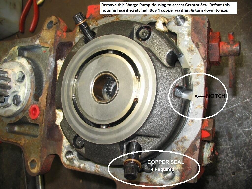

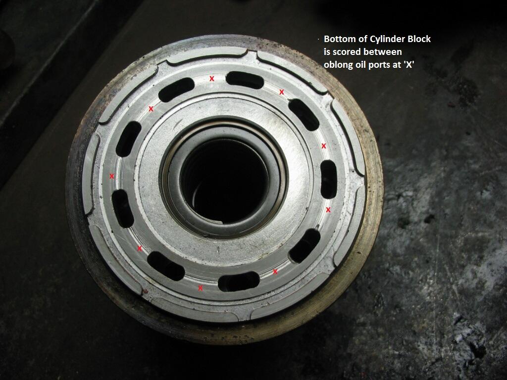

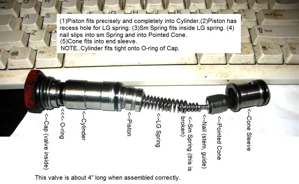

daveoman1966 3,884 #2 Posted December 9, 2021 (edited) What you've described...loss of power at operating temp...is typical of pump internal parts wear. I don't know that the fluid change you allude to will resolve that issue and I'd expect the 'sluggish' condition to only worsen. After all, the Chg 12 is now 51 years old and parts just plain wear out...eventually. To overhaul the pump is not a difficult task...if you can manage a wrench, you can manage the overhaul. Your unit, if original, has the Sundstrand HydroGear power unit model 90-2046. I've prepared a .pdf file with narrative and pics of what to do...free for download at your leisure. The file name is SUNDSTRAND HYDROGEAR refurb.pdf. Another file from Sundstrand is : Transmission_Sundstrand_Hydrogear_Piston-Piston_1965-1982. Both of these are in the TRANSMISSION section for download. Here are a couple pics of what you'll find inside the Pump... Edited December 9, 2021 by daveoman1966 4 5 1 Share this post Link to post Share on other sites
