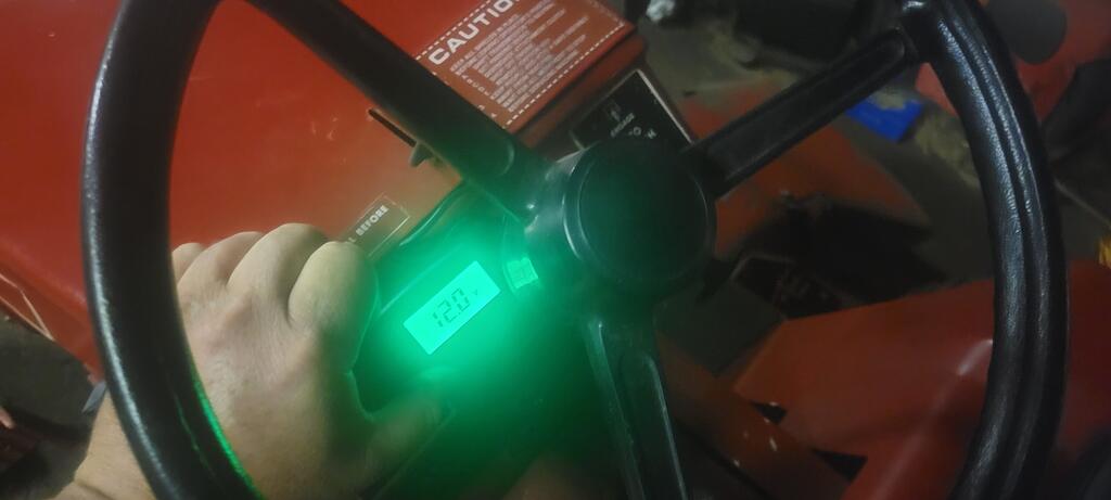

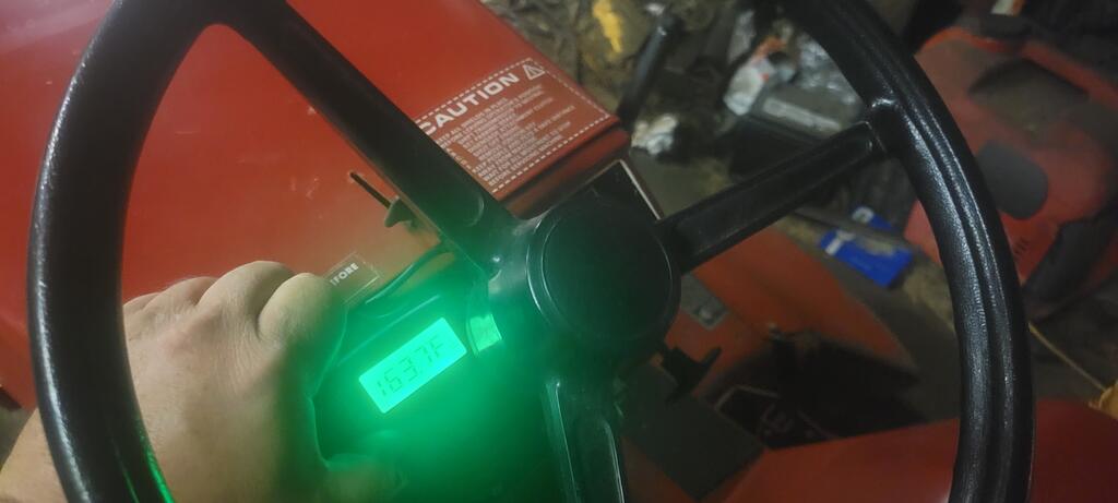

RED-Z06 2,718 #1 Posted December 9, 2021 Back when i ran racing karts we used a device called a Mycron or Digitron gauge that could measure egt, cht, lap times, etc...really good info to have. I found an inexpensive modern option on Amazon that tells you Volts and CHT. pretty simple..the copper ring gives under the spark plug, and 2 leads to the battery. Alternates between the 2 and allows a program to be set that alerts to hi/lo voltage and high temps. I took it out in 72* ambient temps on my C100 and with the deck on in 2nd gear i saw a maximum of 344⁰, dropping to 320⁰ with the deck off and holding there. Upon shutdown it heat soaked to 380⁰ then fell. Im going to 2 sided tape the display on the dash...if i like it ill get or make a more permanent mount. Its useful though, i know...up around 400⁰ you start to lose power and 425⁰ you start to hurt the oil, rings, etc. 4 Share this post Link to post Share on other sites

RED-Z06 2,718 #5 Posted December 12, 2021 Dont know how to edit but looking back i had my numbers wring, 3xx should be 2xx. It mows at 255⁰/256⁰ and idles around 205⁰ Share this post Link to post Share on other sites
