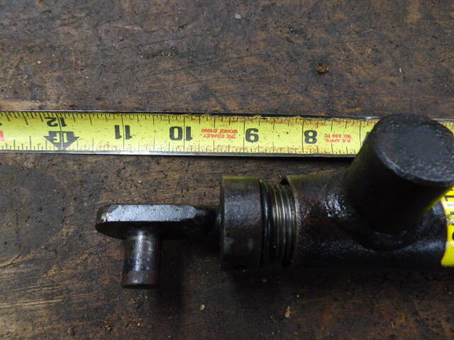

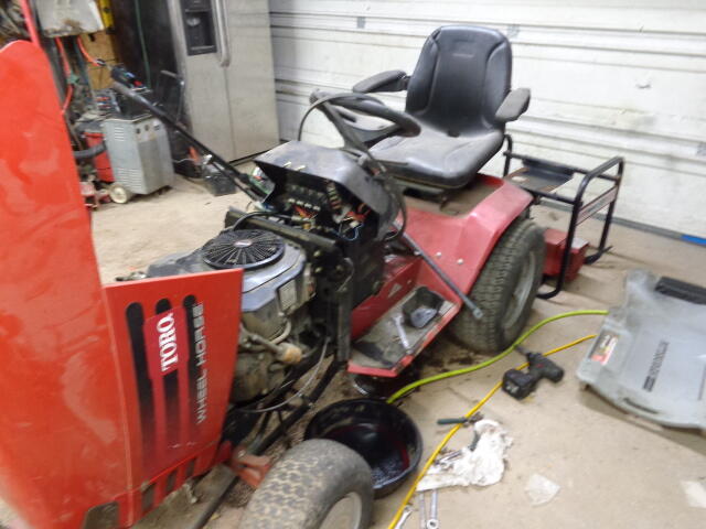

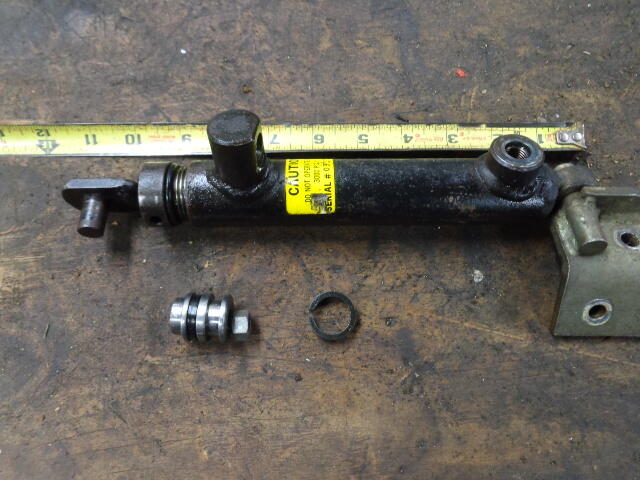

Rosco P. 0 #1 Posted December 8, 2021 I have a 269H, Model 72102 S/N 6900254 with electric/hydro lift. The piston seal and wear band in the lift cylinder are shot. Looked high and low for the seal kit part #94--9723, with no luck. Then I thought maybe buy the whole cylinder, but no, not one of those left in the world. Runs and drives perfect and I have the Toro snow blower for it, but with out the lift working it's only good for parts. Any one know where I can find parts or some other fix for this. I have about 4 hours google time in this, and haven't seen where anyone else has had this problem. Share this post Link to post Share on other sites

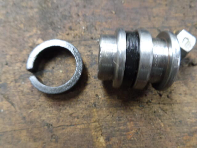

Rosco P. 0 #3 Posted December 8, 2021 I think it just got old, you can see the seal is cracked, and it's hard and stiff. the wear band should have plastic on it but that just fell out in pieces. Share this post Link to post Share on other sites
oldlineman 1,814 #5 Posted December 8, 2021 I googled the part # 94-9723 and found several places that have this part, very pricey though,here is one https://www.repairclinic.com/Shop-For-Parts/b330c21i636/New/Toro-Gasket-Seal-Seal-Kit-Parts Bob 1 Share this post Link to post Share on other sites
Rosco P. 0 #6 Posted December 8, 2021 35 minutes ago, oldlineman said: I googled the part # 94-9723 and found several places that have this part, very pricey though,here is one https://www.repairclinic.com/Shop-For-Parts/b330c21i636/New/Toro-Gasket-Seal-Seal-Kit-Parts Bob Thanks, I think I found those late last night and my mind must have rejected them do to price. Found one for $129.28, that includes the shipping, from Small Engine Parts Warehouse. They have already shipped it, so that's good. Share this post Link to post Share on other sites
