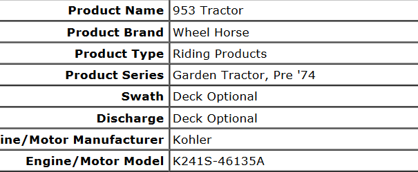

953 nut 64,275 #5 Posted December 9, 2021 (edited) 9 hours ago, oliver2-44 said: @Lane RangerThat list says: 953 engine 1-1/4 qt 1054 engine 2-1/2 qt Same engine and oil pan. Am I missing something. I think there may be a typo on the chart @Lane Ranger has on the wall. The 1055 uses the K-241AS which is a small block engine and uses 1.5 quarts of oil. The K-241S used on the 953/1054/1054A is a big block and needs 2 quarts of oil according to the Kohler Service Manual. Edited December 9, 2021 by 953 nut fat finger 1 Share this post Link to post Share on other sites

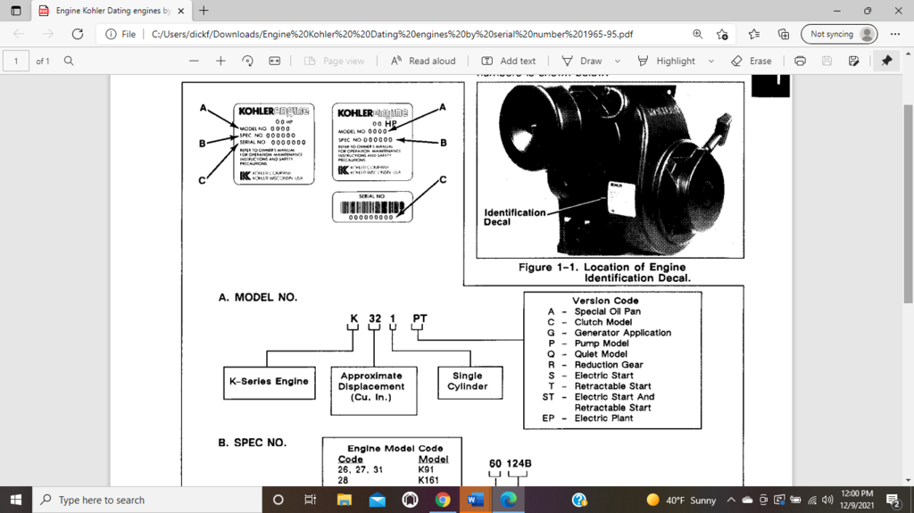

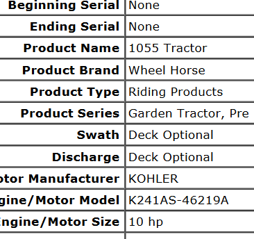

Gregor 4,847 #6 Posted December 9, 2021 (edited) 59 minutes ago, 953 nut said: The 1055 uses the K-214AS Just what is a K-214AS ? Something else I have never heard of? According to what I have found, Both the 953 and the 1055 use the K241. The 953-K241S . The 1055-K241AS. The "A" denotes a special oil pan, (deeper) so will allow for longer dipper, and more oil. Edited December 9, 2021 by Gregor Share this post Link to post Share on other sites
953 nut 64,275 #7 Posted December 9, 2021 2 minutes ago, Gregor said: Just what is a K-214AS It is a Kohler engine that has a portion of the oil pan below the frame rails and is called a small block. It was used on the 1045 and 1055 to allow the hood to close, a regular K-241S would be too tall. In '66 the hood and steering tower were a bit higher to allow the big block engines to be used. Here is a picture of the small block courtesy of @WHX??. Smaller oil pan, shorter dipper on the rod and less oil capacity. 1 Share this post Link to post Share on other sites
