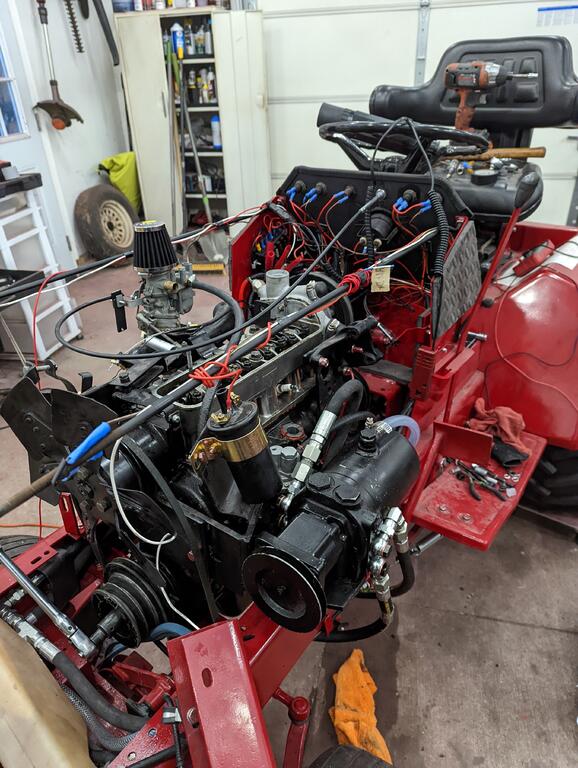

lroudebush 0 #1 Posted December 7, 2021 Alrighty Gents, I need some help. I got an engine back from the rebuilder. Please dont ask about that until I understand root cause. The engine rotated in wrong direction. Replaced the starter to correct. Water pump was wrong as well. Starter now rotates correct, but distributor rotates incorrectly. Pulled distributor and the gear is still rotating incorrectly. Am I looking at a wrong cam shaft? I rotated by hand in the proper direction and confirmed, 1 cycl top dead then #3 top dead. I need ideas from those smarter than me. Thanks. Larry Share this post Link to post Share on other sites

Achto 32,109 #9 Posted December 8, 2021 (edited) 40 minutes ago, wallfish said: That's what I'm think'n too. Maybe the fan is bolted on backwards Unless. Are these engines mounted in the tractor backwards?? I know that a Kubota is mounted backwards in a Cub Cadet 782D. If this is the case, then the engine would turn counter clockwise when viewed from the front of the tractor. Clues : Is the water pump in the front or rear of the tractor? Water pump should be on the front of an engine. Is the starter towards the front or rear of the tractor? Starter usually should drive on the rear of an engine. Edited December 8, 2021 by Achto 1 Share this post Link to post Share on other sites
953 nut 67,483 #10 Posted December 8, 2021 36 minutes ago, Achto said: Are these engines mounted in the tractor backwards?? Bingo! They were mounted in the Renault Dauphine with the water pump etc. at the rear. I found the information below on an internet site, could it be that the cam and starter were swapped out at the rebuilder's shop. Reversing engine direction Thread starterGeoff in the Gully Start dateSep 14, 2015 Geoff in the Gully Getting it together Messages 280 Sep 14, 2015 #1 I've got a bit of an odd idea to put out there. We know the 845cc engine rotates in the opposite direction to the 1100cc engine and we have to be careful to mate the right 4-speed box otherwise we end up with 4 reverse speeds and one forward. A while back I looked into improving performance by using some parts including the camshaft from a Dauphine Gordini engine. The Dauphine is a rear-engine version of the 845cc Ventoux engine. I eventually figured out I couldn't use the cam because the Dauphine Gordini engine rotates in the opposite direction and the cam would be opening the inlet and outlet valves in the wrong order. But what if we want the engine to go the other way? Can we use Dauphine bits to reverse the direction of our 845cc engine so we can use a later 354 gearbox? I might be easier to do that than to find a gearbox that goes the right way. The question is then just what does it take to reverse the direction, apart from the cam. Is the crankshaft the same, or is it balanced differently? Are the distributors rotating the same direction? 3 Share this post Link to post Share on other sites
Gregor 4,848 #11 Posted December 8, 2021 53 minutes ago, wallfish said: That's what I'm think'n too. Maybe the fan is bolted on backwards I don't think it would matter. Forward or backward, the fan will still blow air in only one direction. It will blow air better, if mounted correctly, but can only blow in one direction, as long as motor rotation remains constant. Share this post Link to post Share on other sites
Achto 32,109 #12 Posted December 8, 2021 4 minutes ago, 953 nut said: could it be that the cam and starter were swapped out at the rebuilder's shop. If the engine is backwards then #1cyl would be towards the rear of the tractor. I would check the distributor again using the rear cylinder as #1 Share this post Link to post Share on other sites

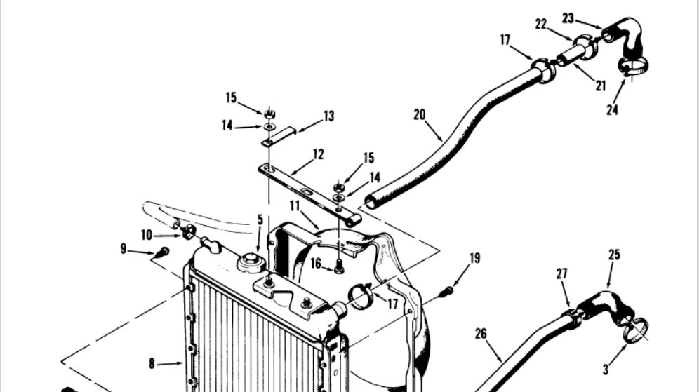

wallfish 20,230 #13 Posted December 8, 2021 6 hours ago, Gregor said: I don't think it would matter. Forward or backward, the fan will still blow air in only one direction. It will blow air better, if mounted correctly, but can only blow in one direction, as long as motor rotation remains constant. I don't know anything about those engines but Dan mentioned it turning clockwise from the front so that direction would equal air blowing from the engine into the radiator according to the pic. Maybe a was in order instead of a 1 Share this post Link to post Share on other sites
Jeff R. 35 #14 Posted December 8, 2021 I know nothing about D250’s - but am I seeing a water pump up near the dash?? Is this normal for a D250? Share this post Link to post Share on other sites
Gregor 4,848 #15 Posted December 8, 2021 26 minutes ago, Jeff R. said: I know nothing about D250’s - but am I seeing a water pump up near the dash?? Is this normal for a D250? It looks like the fan and radiator are in front, and plumed to the water pump in the rear. 1 Share this post Link to post Share on other sites
Jeff R. 35 #16 Posted December 8, 2021 7 minutes ago, Gregor said: It looks like the fan and radiator are in front, and plumed to the water pump in the rear. thanks for the diagram- just thought it was strange, now it makes sense. Share this post Link to post Share on other sites

littleredrider 409 #25 Posted January 1, 2022 The motor in 250s sit "backwards". The water pump faces the rear, the motor turns counter clockwise sitting on the tractor. I think lol. I don't know much bout these motors, other than hard to find parts for. And it anything like mine, gutless. Mine runs great, but has no power. Why I'm swapping it out for a 3 cylinder diesel.... Share this post Link to post Share on other sites
