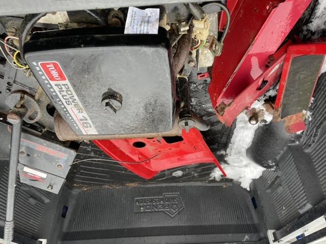

AHS 1,674 #1 Posted December 5, 2021 The Onan 16, it wasn’t the only things that I got! There were running boards, the shifter plate, and a rear seat pan….ALL going to the junk yard!! The motor is the main thing… did it come from a 416? I haven’t head of a 516? How reliable were these motors? I’m going to assume that they didn’t have the same wiring as the 416 Kohler magnums hooking up to the tractor? I’m more of a Kohler fan (8hp -14hp), but I guess 1 Onan won’t hurt!!😀💪 3 1 Share this post Link to post Share on other sites
Tuneup 1,453 #2 Posted December 5, 2021 Congrats! When they are properly tuned and attended to, they're bullet-proof. Mine is high hours and a joy to use, now that the carb is sorted. Yes, mine is on a 516H and it's an early production in that there is no oil filter. Love it as much as the K series littering the shed on other Wheel Horsies. 2 Share this post Link to post Share on other sites
WheelHorse520H 710 #3 Posted December 5, 2021 The Onan P216, 18, and 20 are almost indestructible. If you keep up with maintenance and keep it tuned it will run forever. Good score! 2 Share this post Link to post Share on other sites

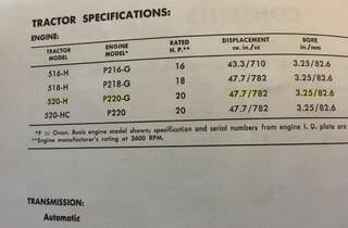

kpinnc 17,794 #6 Posted December 5, 2021 Pure opinion here, not fact. Onan P216 is probably the best of the Onans that WH used. More often than any of the others, the 16 seems to have less issues. And now a fact: Most of the internals are interchangable from the 16, 18, and 20. Very little difference in these engines. 2 Share this post Link to post Share on other sites
WheelHorse520H 710 #7 Posted December 5, 2021 9 minutes ago, kpinnc said: And now a fact: Most of the internals are interchangable from the 16, 18, and 20. Very little difference in these engines. The little changes are mentioned in the beginning of the 500 series manual from 1988. 1 2 Share this post Link to post Share on other sites

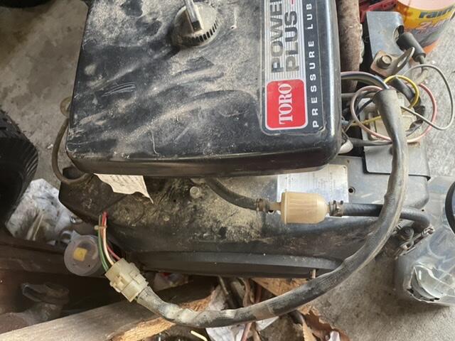

AHS 1,674 #8 Posted December 5, 2021 Good to know! I have the oil filter on the Onan, when did it come out? The mid 90’s? refer to the picture.. where the wires are cut, they go to the tractor end of it, right? 1 Share this post Link to post Share on other sites
WheelHorse520H 710 #9 Posted December 5, 2021 14 minutes ago, AHS said: Good to know! I have the oil filter on the Onan, when did it come out? The mid 90’s? refer to the picture.. where the wires are cut, they go to the tractor end of it, right? Not sure about the oil filter on the P216, my P220 from 1988 has the oil filter. I remember the owners manual saying only certain 500 series tractors had the oil filter though. Yes, on the side of the air filter with the Toro logo is the voltage regulator. That is above the cylinder that is closest to the seat when mounted on the tractor. So if it were on a tractor the front of the tractor would be on the left of the photo.In this photo you can see the chaff screen is on the left of the tractor from the seat. 1 Share this post Link to post Share on other sites

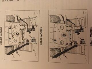

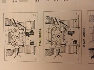

WheelHorse520H 710 #11 Posted December 5, 2021 Just now, AHS said: I mean, I’ll have to find a tractor (Onan powered) that is missing a motor!!😎👍. The 518 and the 520s would work, wiring wise though? I would think. I am sure with some retro-fitting it could work, the 520 has more lights and gauges than the 518 or 516. This is a good illustration of the differences with the lights and gauges…also from the 500 series manual. 1 Share this post Link to post Share on other sites
lynnmor 8,737 #12 Posted December 5, 2021 3 minutes ago, AHS said: I mean, I’ll have to find a tractor (Onan powered) that is missing a motor!!😎👍. The 518 and the 520s would work, wiring wise though? I would think. There were some slight differences in the wiring connector between models, wire colors change and some have tachometers. 2 Share this post Link to post Share on other sites
