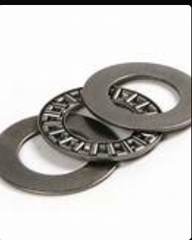

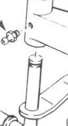

Tuneup 1,459 #9 Posted December 5, 2021 So, RED, let's see if we can do anything about this. When you jack the front end so the tires are off the ground, the steering is super smooth and easy. You're suggesting this as you said everything is lubed. Assuming also that the toe is adjusted. Locate where there is drag from weight and try a few things. I'd suggest a flat bearing at the base of the pivot point where the vertical axle meets the crossbar. I can't name the parts specifically but maybe that suffices? All the weight of the front end rests here. They're easily installed and available through the usual sources like McMaster. Maybe a little grinding at the cross member top is required to secure the retainer but, an option? I'm tempted to do the same. Winter in the South can be boring so tractor mods become more common. 5 Share this post Link to post Share on other sites
RED-Z06 2,720 #10 Posted December 5, 2021 1 hour ago, Tuneup said: So, RED, let's see if we can do anything about this. When you jack the front end so the tires are off the ground, the steering is super smooth and easy. You're suggesting this as you said everything is lubed. Assuming also that the toe is adjusted. Locate where there is drag from weight and try a few things. I'd suggest a flat bearing at the base of the pivot point where the vertical axle meets the crossbar. I can't name the parts specifically but maybe that suffices? All the weight of the front end rests here. They're easily installed and available through the usual sources like McMaster. Maybe a little grinding at the cross member top is required to secure the retainer but, an option? I'm tempted to do the same. Winter in the South can be boring so tractor mods become more common. Put a thrust washer under the axle? Worth a shot...ill measure the kingpin 1 Share this post Link to post Share on other sites

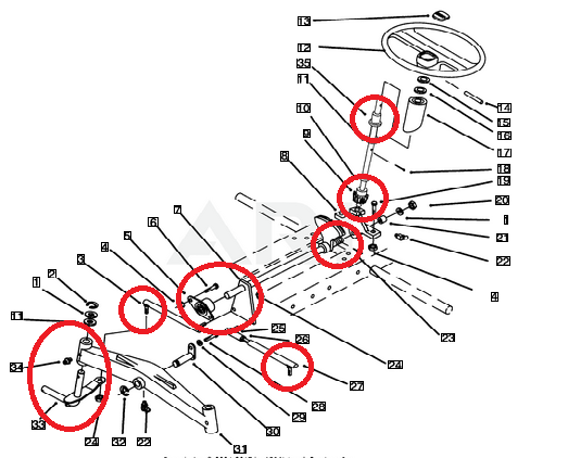

rmaynard 17,575 #13 Posted December 5, 2021 I would jack up the front of the tractor, making sure that both tires are off the ground. Try the steering with no weight on the tires. If it is still stiff then you have something that is binding. There are lots of places where binding could occur. All areas circled in red are potential areas of concern. My 416-H only steers hard when one or the other of the front tire pressures are low. 1 Share this post Link to post Share on other sites
RED-Z06 2,720 #14 Posted December 5, 2021 23 minutes ago, rmaynard said: I would jack up the front of the tractor, making sure that both tires are off the ground. Try the steering with no weight on the tires. If it is still stiff then you have something that is binding. There are lots of places where binding could occur. All areas circled in red are potential areas of concern. My 416-H only steers hard when one or the other of the front tire pressures are low. Jacked up i can give the wheel a shove from one lock and it will go around on its own to the other lock. I think im going to drop the spindles and look for contamination, maybe polish the shafts. Share this post Link to post Share on other sites

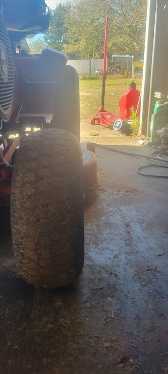

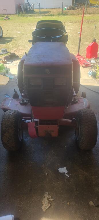

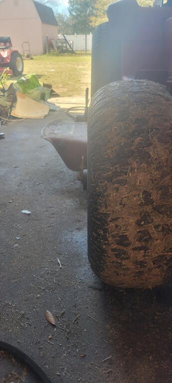

rmaynard 17,575 #16 Posted December 5, 2021 Post a picture of the front end, looking straight on. 1 Share this post Link to post Share on other sites
RED-Z06 2,720 #17 Posted December 5, 2021 4 minutes ago, rmaynard said: Post a picture of the front end, looking straight on. Share this post Link to post Share on other sites
RED-Z06 2,720 #18 Posted December 5, 2021 Its toed 0⁰...if I drive thru wet dirt and go down the road..it doesnt scuff the dirt off the tires for at least 5 or 600 feet. 1 Share this post Link to post Share on other sites
rmaynard 17,575 #19 Posted December 6, 2021 I would toe it in so that the fronts of the tires are 1/8" toward center. This is the way my 416-H is set and it steers fine. BTW, I run 14 pounds in front and 10 pounds in rear. 1 Share this post Link to post Share on other sites
pacer 3,180 #20 Posted December 6, 2021 I like to get 15-20 ft back from the front to eyeball toe so its a bit hard to get an idea from the pics, but if I had to guess then yes it seems that you have 0 toe to at least some toe out. Dial you some toe in at about what the sketch shows (I usually just 'eyeball' them till it looks right) and I bet youll at least see some difference.... Share this post Link to post Share on other sites
