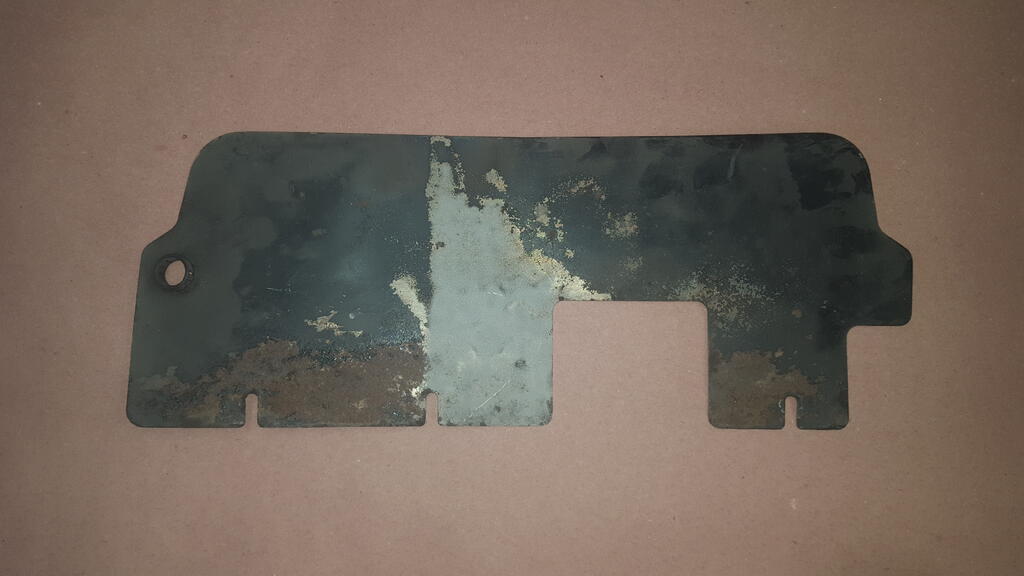

Gregor 4,848 #30 Posted December 8, 2021 Well I had to try it, soooooo, I bought 1 of these, and some of this. and gave it a shot. This is a piece of tin work from my Kophler MV 16. I didn't put this piece back on because I think it is unique to the Cub Cadet. But I did keep the piece. It didn't take long, but doing an entire hood may be a bit much for this blaster. It removed the paint and rust. I could definitely use more air compressor. Mine never did quit running. This could be pretty handy for small pieces, or areas you simply can't get at any other way. If you did this in a large cardboard box, I think you could reclaim the media. Of course that media would be contaminated with paint and rust, and would become less and less effective, the more you used it. Maybe I can talk my son into bringing over his compressor this weekend. Too cold outside for me. 2 Share this post Link to post Share on other sites

WHX?? 57,904 #32 Posted December 10, 2021 That don't look the worst Gregor. Share this post Link to post Share on other sites
