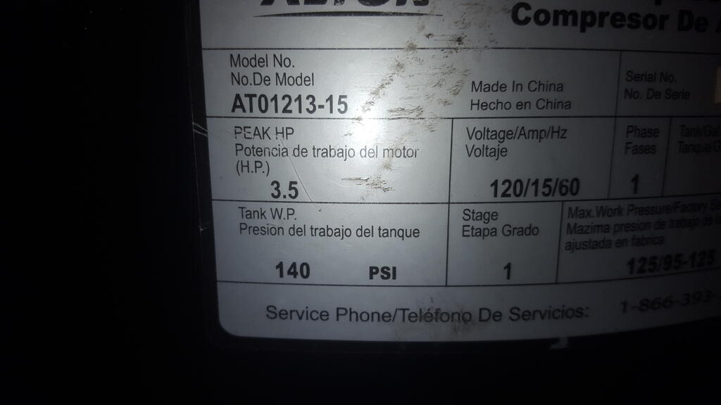

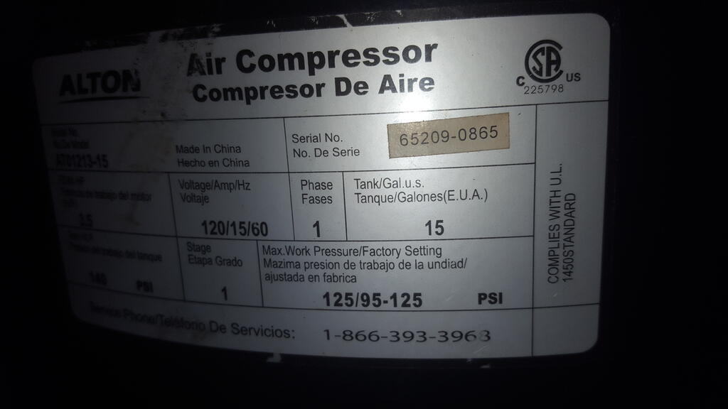

Gregor 4,848 #13 Posted December 5, 2021 58 minutes ago, WheelHorse520H said: Link to sandblaster. Would a 15 gallon, 3.5 HP compressor be sufficient for that? Share this post Link to post Share on other sites
WHX?? 57,904 #14 Posted December 6, 2021 Yeah it probaly would for the HF blaster. Says one hp or larger. Specs says requires 3.5 ccfm @50 psi with a max pressure of 120 psi. so bounce that off the your compressor specs. Share this post Link to post Share on other sites

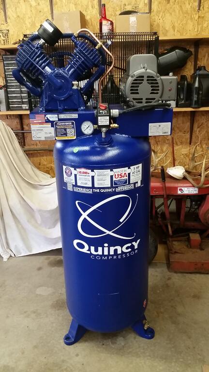

WHX?? 57,904 #22 Posted December 6, 2021 (edited) Here is the compressor he has. 4.2 cfm @90 psi so would be a little waiting. https://www.amazon.com/alton-at01213-15-15-gallon-portable-compressor/dp/b004x5l9gw Really Squonky they have alot of nice stuff there but $$. Took me years to of side jobs just to save up for this bad boy.... but I paid my dues & got by for many years with a dinky rol air. Edited December 6, 2021 by WHX?? 3 Share this post Link to post Share on other sites
Gregor 4,848 #23 Posted December 6, 2021 (edited) 7 minutes ago, WHX?? said: Here is the compressor he has. 4.2 cfm @90 psi so would be a little waiting. https://www.amazon.com/alton-at01213-15-15-gallon-portable-compressor/dp/b004x5l9gw Yep, that's what I have. Don't remember where I got it. Wanna trade? I got to thinking. Another air compressor would give me another compressor, but also another tank. Would my CFM increase, or not? Edited December 6, 2021 by Gregor 1 Share this post Link to post Share on other sites
