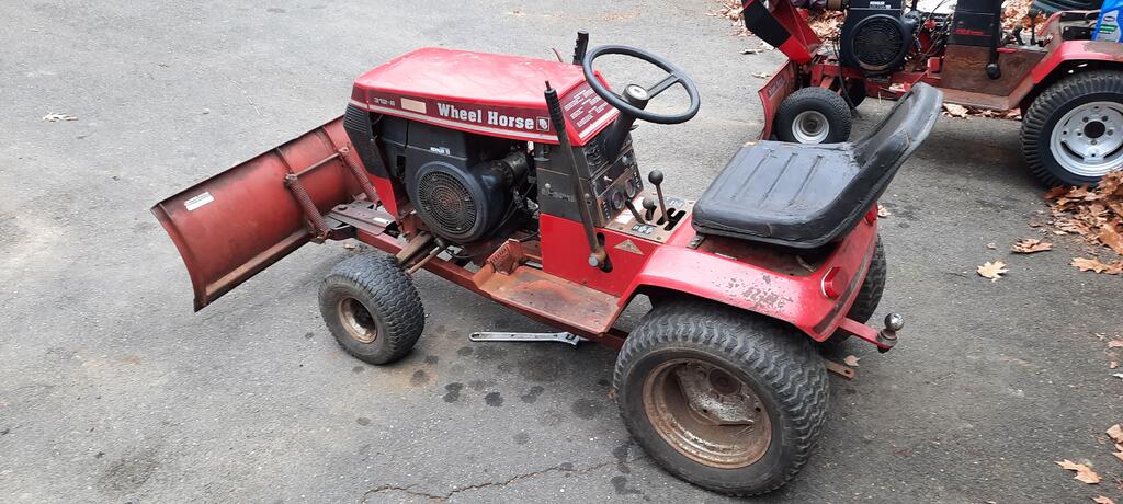

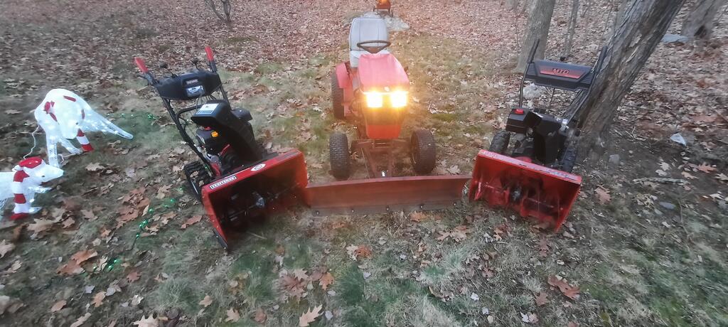

Docwheelhorse 2,792 #1 Posted December 4, 2021 Happy Saturday, Spent today fixing my beater snow blower, servicing my new one and building my plow tractor. Almost ready... weights and 2 link chains on the 312 and good to go! 20211204_160625.mp4 20211204_151635.mp4 5 2 6 Share this post Link to post Share on other sites

peter lena 9,565 #3 Posted December 5, 2021 @Docwheelhorse those dry /rusty joints could use some lubrication help , lucas hd chassis grease is a good bet , that powder tye rod connection , 2 heim joints and 3/8x24 thread rod , make a very solid and quick fix , only if you want to . pete 2 Share this post Link to post Share on other sites
stevebo-(Moderator) 8,601 #4 Posted December 5, 2021 Tony…. You have trouble with those tie rods!! 1 2 Share this post Link to post Share on other sites
Docwheelhorse 2,792 #5 Posted December 5, 2021 23 minutes ago, stevebo said: Tony…. You have trouble with those tie rods!! Yep.... I do... I think I'll ask for a couple NOS sets for Christmas 1 Share this post Link to post Share on other sites
ebinmaine 75,824 #6 Posted December 5, 2021 11 hours ago, stevebo said: Tony…. You have trouble with those tie rods!! Maybe these are the newfangled high speed removable types?? Share this post Link to post Share on other sites
kpinnc 16,230 #7 Posted December 5, 2021 54 minutes ago, ebinmaine said: Maybe these are the newfangled high speed removable types?? I think he's onto something here: Quick Disconnect (QD) tie rods. Makes for rapid front axle changes with minimal tools required! 2 Share this post Link to post Share on other sites
peter lena 9,565 #8 Posted December 5, 2021 @Docwheelhorse been road testing my heim joint set ups for years now , seeing if they would stand up , no problems and zero failures , steering rods , pto foward rod , snow plow swing rod , clutch linkage , simple easy upgrade , only if you want to , pete 1 Share this post Link to post Share on other sites
