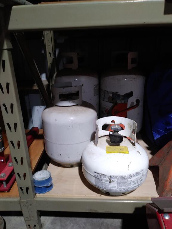

ebinmaine 80,765 #32 Posted December 10, 2021 10 hours ago, sparkys toy said: reasonable sized tank What's that wittle pancake thing go to??? Share this post Link to post Share on other sites
Handy Don 17,490 #33 Posted December 10, 2021 2 hours ago, ebinmaine said: What's that wittle pancake thing go to??? Same question! Share this post Link to post Share on other sites
clueless 3,439 #34 Posted December 10, 2021 LP does not burn as hot as gas so you use a little more, a 20# tank holds 4.2 gals of propane. Contact these folks uscarburetionwww.com. they can help you with your regulator questions. They were very helpful a couple of years ago when I converted two 10hp tecumseh generators to gas or LP. Like I said it's been a couple years and things change fast now especially customer service . As a side note when you exchange your 20# grill tank at the local box, grocery, or convenient store you are only getting 15# or a little over 3 gals of gas. Divide that into what ever you pay for it and you'll find you paid over two times what propane cost, I know convenience is nice but not every time. Down here we do a lot of grilling, fish and chicken frying and seafood boils all year round, I keep one tank full at at all times and when the other's empty I take it to my propane dealer and have it filled. Ain't nothing worse than having a couple hundred dollars worth of shrimp, crabs and crawfish in mid boil and you run out of propane. 1 Share this post Link to post Share on other sites

sparkys toy 77 #37 Posted December 10, 2021 7 hours ago, ebinmaine said: What's that wittle pancake thing go to??? No idea,it's the magic of Garage sales,5.00 and it's over half full 1 1 Share this post Link to post Share on other sites

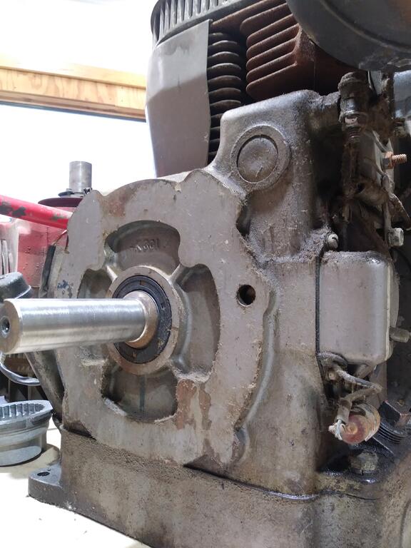

sparkys toy 77 #39 Posted December 10, 2021 Got her in old man starting configuration with a spare starter/generator and brackets and pully ,noticed no holes on the pto side of block or the two in the bottom of the oil pan ,that I can swap out when I find one 1 1 Share this post Link to post Share on other sites
clueless 3,439 #40 Posted December 10, 2021 7 hours ago, ebinmaine said: What's that wittle pancake thing go to??? That's a 11 lb. propane tank or 2.5 gals. Got one strapped to my Bi fuel, gas/ lp portable generator, run it about 10 minutes every other month keeps the battery charged. Got one strapped on a small hand dolly with a 150,000 BTU torch, need to start a burn pile or kill some weeds just fire it up. Also I'm sure many here know a portable propane tanks has a 12 year shelf life, the manufacture production date is stamped on the collar of the tank, just remember that when buying used tanks. Down here it cost $27.00 to recertify one for 5 years and not all pass. 2 Share this post Link to post Share on other sites
ebinmaine 80,765 #41 Posted December 10, 2021 24 minutes ago, clueless said: Also I'm sure many here know a portable propane tanks has a 12 year shelf life, the manufacture production date is stamped on the collar of the tank, just remember that when buying used tanks. Down here it cost $27.00 to recertify one for 5 years and not all pass That's the one and only time I bring a tank for exchange. HD employee told me it didn't matter to them or their vendor what the date was because the vendor would check/recertify/refill. 1 1 Share this post Link to post Share on other sites

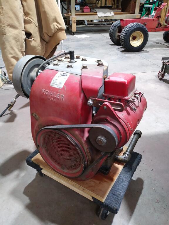

sparkys toy 77 #42 Posted December 15, 2021 On 12/10/2021 at 3:11 PM, ebinmaine said: That's the one and only time I bring a tank for exchange. HD employee told me it didn't matter to them or their vendor what the date was because the vendor would check/recertify/refill. Just found an other 11 lb tank full on market place close by for 20 bucks now I have a backup and discovered I have an oil tank off a bad motor that was given to me with the bottom holes tapped for wheel horse So I got that swapped out and the motor look like brand new inside .just need a jet and regulator and I think I'm set 1 Share this post Link to post Share on other sites

sparkys toy 77 #45 Posted December 15, 2021 I'm thinking it's going on this 1076 I think the oil ring is stuck and it needs to come apart any way for a rering 1 Share this post Link to post Share on other sites

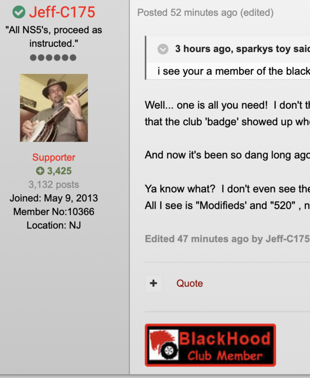

sparkys toy 77 #46 Posted December 16, 2021 On 12/5/2021 at 9:11 AM, Jeff-C175 said: Ya mean the little tanks for propane torch? Ten, fifteen minutes? If yer lucky. i see your a member of the black hood club,whats it all about ,how many do you need to own to join Share this post Link to post Share on other sites
Jeff-C175 7,211 #47 Posted December 17, 2021 (edited) 2 hours ago, sparkys toy said: i see your a member of the black hood club,whats it all about ,how many do you need to own to join Well... one is all you need! I don't think anyone would fault you for having none even! But the 'club' thing seems to have fallen by the wayside. Used to be that the club 'badge' showed up when you made a post and that seems to have stopped for some reason. And now it's been so dang long ago that I just don't remember what one has to do to join! Ya know what? I don't even see the 'blackhood club' listed! Where did you see that? All I see is "Modifieds' and "520" , no others? Edited December 17, 2021 by Jeff-C175 Share this post Link to post Share on other sites
Handy Don 17,490 #48 Posted December 17, 2021 (edited) if you're in, you're in! But if you're not in, .... Edited December 17, 2021 by Handy Don Share this post Link to post Share on other sites
Jeff-C175 7,211 #49 Posted December 17, 2021 22 minutes ago, Handy Don said: if you're in, you're in! But if you're not in, .... Why don't I see that? Share this post Link to post Share on other sites
ebinmaine 80,765 #50 Posted December 17, 2021 4 minutes ago, Jeff-C175 said: Why don't I see that? You on a phone, tablet, or PC? Signatures don't appear on most phones, some tablets. PC should show it. 99.9 percent of my Redsquare existence is phone so I VERY rarely see signatures. Only when I'm on PC. Share this post Link to post Share on other sites
