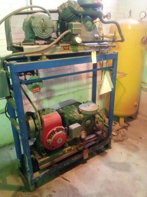

sparkys toy 77 #1 Posted December 4, 2021 (edited) Just acquired a k301 powered by natural gas and want to change it to l.p. is there a different orfice in the carb to change or just carb adjustments required Edited December 4, 2021 by sparkys toy Added picture 1 Share this post Link to post Share on other sites

sparkie333 265 #5 Posted December 4, 2021 Hay --that thing don't look like a K301 that I ever seen.--- O I was looking first at your air compressor--- You do mean the red one? 1 2 Share this post Link to post Share on other sites
