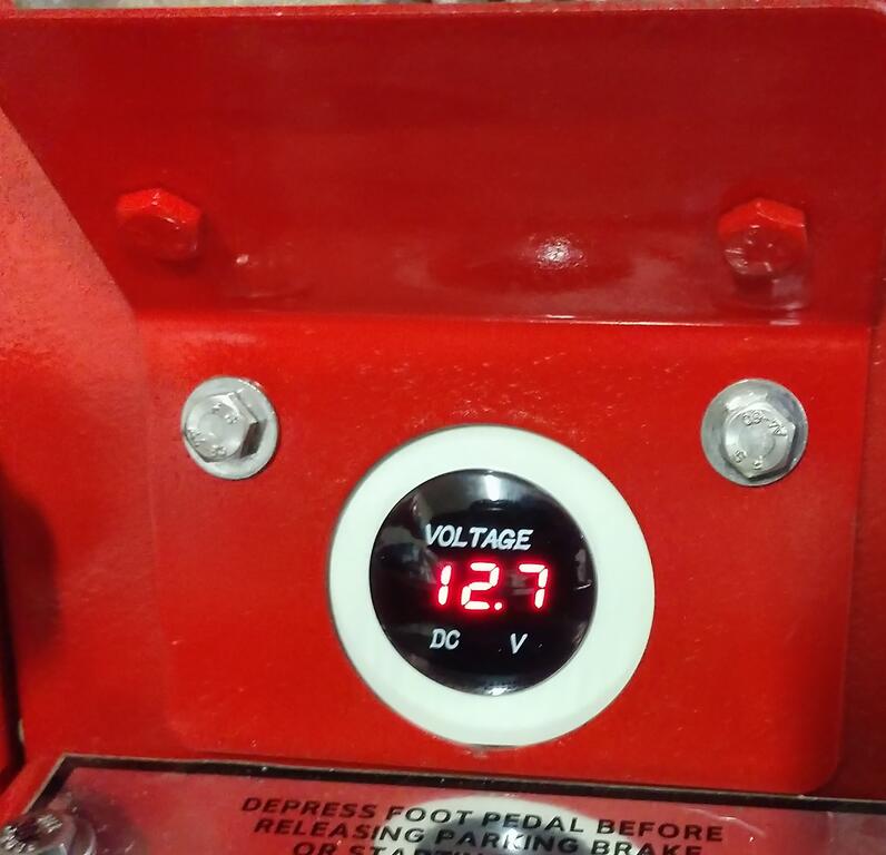

kpinnc 17,499 #10 Posted December 15, 2021 I add the cheapo digital voltmeters on most of my tractors. When running, if I see 14+vdc, I know I'm good. 12.5+vdc or less, I'm on borrowed time. The pic below is battery voltage before cranking. 3 1 Share this post Link to post Share on other sites
peter lena 9,797 #11 Posted December 15, 2021 @kpinnc thinking of changing over to that type of gauge , any downside? pete 1 Share this post Link to post Share on other sites
kpinnc 17,499 #12 Posted December 16, 2021 13 hours ago, peter lena said: @kpinnc thinking of changing over to that type of gauge , any downside? pete Not that I know of. Just remember that most guages are not made for exterior use. You may not need marine grade stuff, but I do look for waterproof when I buy them. 3 Share this post Link to post Share on other sites
