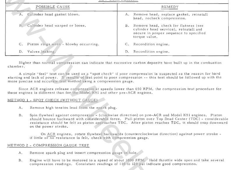

moe1965 774 #28 Posted December 4, 2021 Sorry to keep asking questions but I'm baffled I know there us a lot of debate on doing a compression test on these kohler engines. Here is my latest finding and confusion. I put a pressure gauge on and it jumped up to 75 psi. Just for the heck of it I put the gage on my c141 which runs and starts no smoke and runs awesome and I only got about 40 psi. I'm assuming that the compression releas is working properly on the c141. So could the compression releas on the 312 b be stuck closed giving me my issues If so where is it located in the engine and how to check it. I'm still blown away on how good it starts and runs but is still pushing smoke on throttle up only. I'm going to pull the head off it today and see what I find inside and go from there. I'm thinking at this point I have tried all the easy stuff I know and it's time for a heart transplant . Share this post Link to post Share on other sites
pfrederi 21,174 #29 Posted December 4, 2021 (edited) Either do a leak down test or look at the engine test in the older K series service manual You can check your ACR just look at the exhaust valve behind the breather as you crank it should open wide exhaust stroke and just a slight bump on compression stroke Edited December 4, 2021 by pfrederi Share this post Link to post Share on other sites

953 nut 69,550 #34 Posted December 7, 2021 On 12/4/2021 at 1:54 PM, moe1965 said: I put a pressure gauge on and it jumped up to 75 psi. Just for the heck of it I put the gage on my c141 which runs and starts no smoke and runs awesome and I only got about 40 psi. I'm assuming that the compression releas is working properly on the c141. So could the compression releas on the 312 b be stuck closed giving me my issues The compression test can be done on an engine with ACR by backing off the valve lash to the point where the exhaust valve won't be lifted by the ACR cam. It could be the exhaust valve lash on the 312 is not set properly. Considering the other problems under engine tins I don't think you need to worry about that until you have corrected the condition causing the gunk build up on the cooling fins. Share this post Link to post Share on other sites
