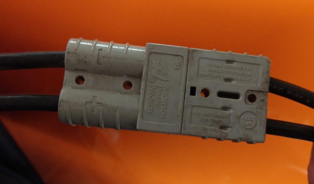

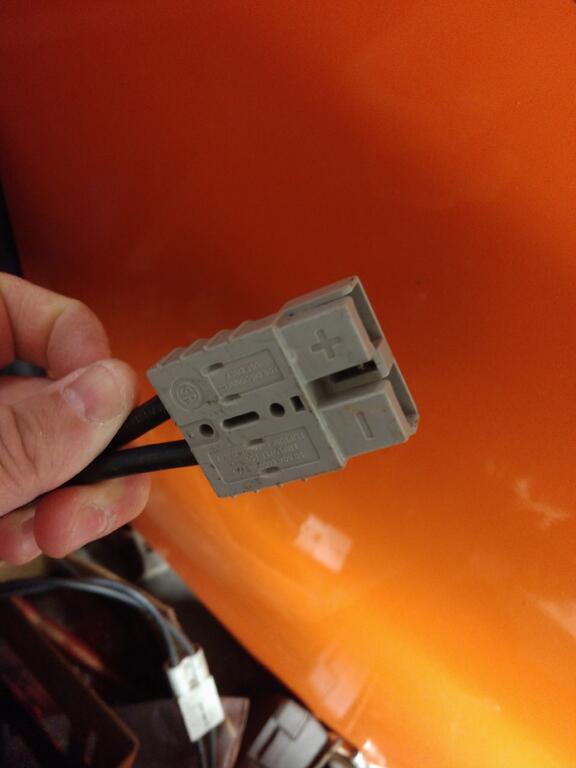

kpinnc 17,499 #23 Posted December 9, 2021 On the hour meter issue, or on phantom voltage drains that destroy batteries and coils- I cable in a disconnect on all my builds. The simple fact is that if you have 3 or more machines, it's difficult to run all of them enough to keep the batteries up. A disconnect not only preserves the battery, it makes working on the tractor easier, because it doesn't matter if a wrench touches the positive terminal. A quick click before use, and you're back in business. Not to mention swapping batteries between machines takes a few seconds now. 3 Share this post Link to post Share on other sites
RED-Z06 2,718 #24 Posted December 9, 2021 Ive seen conductive crud kill alot if breakerless coils in my shop. On modern engines the coil fires on its own and you ground the primary windings to kill spark..which travels thru the M terminal on the switch and thru to the G ground terminal. If there is even a slight amount of conductivity from the Accessory or S solenoid 12v terminals thru to the M magneto terminal, you backfeed power into the coil...and the coil is fried 1 Share this post Link to post Share on other sites
Jeff-C175 7,207 #25 Posted December 9, 2021 7 hours ago, kpinnc said: On the hour meter issue, or on phantom voltage drains that destroy batteries and coils- I cable in a disconnect on all my builds. The simple fact is that if you have 3 or more machines, it's difficult to run all of them enough to keep the batteries up. A disconnect not only preserves the battery, it makes working on the tractor easier, because it doesn't matter if a wrench touches the positive terminal. A quick click before use, and you're back in business. Not to mention swapping batteries between machines takes a few seconds now. I've got a bunch of those I salvaged from dumpstered UPS supplies. Share this post Link to post Share on other sites
