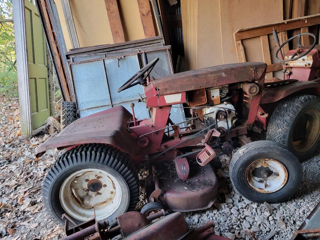

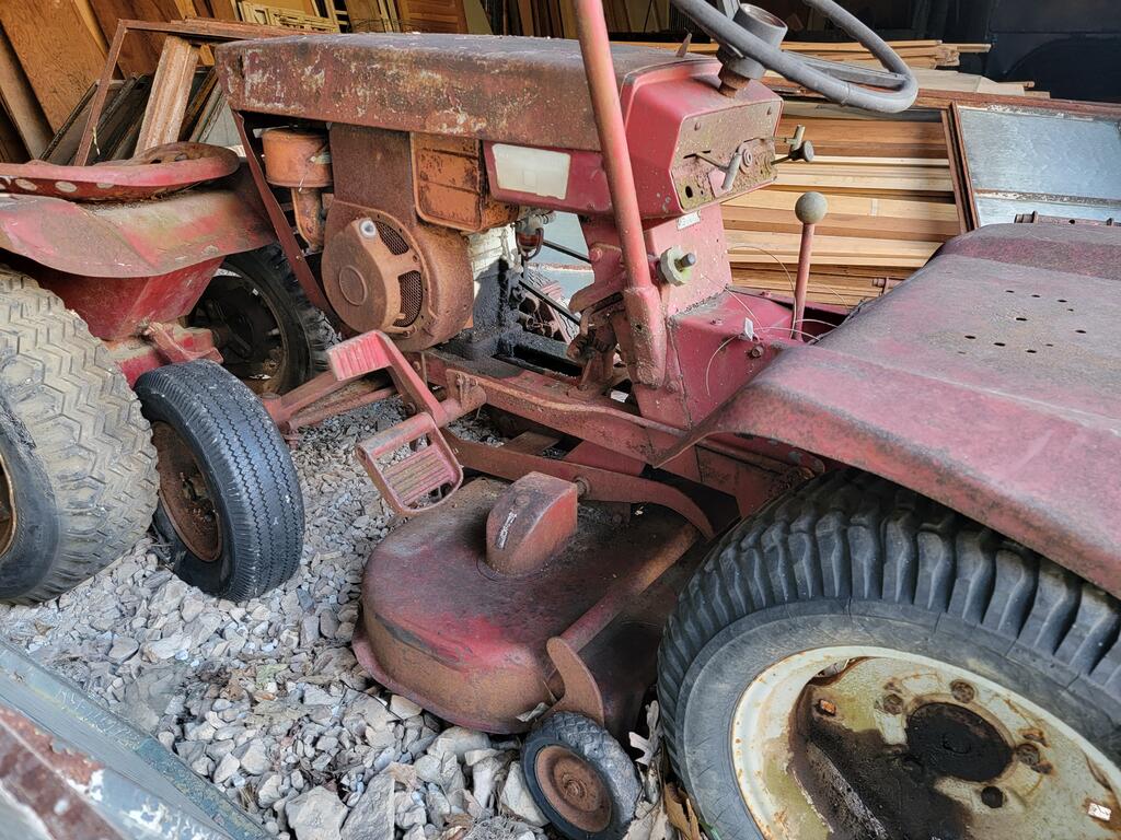

Fredo 56 #38 Posted December 3, 2021 On 12/1/2021 at 2:16 PM, Maxwell-8 said: Nice tractor, Just way to clean to make a mudmower from! I wouldn't do it. After going through this tractor i am consider leaving this one alone and just fix the wiring issues. It is a nice tractor for sure! I will be using the commnado 6 and the 657 to make a mud mower instead since they are both real rough. 1 2 Share this post Link to post Share on other sites
Maxwell-8 4,371 #39 Posted December 3, 2021 3 hours ago, Fredo said: I will be using the commnado 6 and the 657 lighter machines do better in the mud! Share this post Link to post Share on other sites
ebinmaine 79,740 #40 Posted December 3, 2021 6 hours ago, Fredo said: After going through this tractor i am consider leaving this one alone and just fix the wiring issues. It is a nice tractor for sure! I will be using the commnado 6 and the 657 to make a mud mower instead since they are both real rough. I like that you see the diamond in the rough of the C series. 1 Share this post Link to post Share on other sites

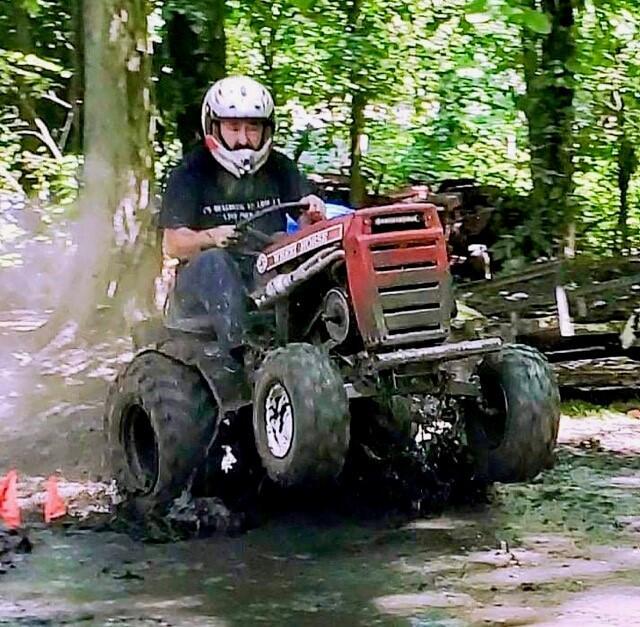

Greentored 3,220 #41 Posted December 20, 2021 I really gotta start checking in here more often This is my B-100, also known as the B-1 bomber. Theres a ton of mods on it, but as far as mods to make it hold up, very little needs to be done to a Horse. How crazy are you planning to get with it? As for 'absolute must have mods' as follows: Lock the diff! If you have an 8 pinion, you can absolutely flip them and call it a day- I have put mine through h-e-double hockey sticks and zero issues. Front spindles need to be the bolt style to hold wheels on, not clips. Also not a bad idea to drill and tap the tops of the spindles and use a big washer to hold them in place in the axle as well. Beef/brace up the steering arms where they attach to the spindle- this is a weak point, and if you jam a tire against something, you WILL snap it off. Tie rods- whip up a set with heim ends. Trans/frame brace- this is a weak point even on stock Horses that get used hard, lots of info out there for this mod. Your rear hubs WILL come loose, especially being locked up in rear- thats a ton of stress. At the very minimum install new locking screws and check them every ride. Better yet, clean the hubs and axles spotless and use loctite green 'sleeve retainer'- they will never move again. Yes you'll need heat to disassemble if the need arises. You can get a 26" rear tire under them if you're willing to 'roll' the fender lips a bit and perhaps trim the floorboard/fender meeting point. Most guys run 25s. I run the stock rear brake and have had no issues, but I also dont ride it to slow down on high speed runs and chance overheating it. If you plan to get into some serious mud, you'll have belt slip issues. 'Creepycrawler' came up with a killer idler setup to put more tension and wrap on the trans pulley and it makes the clutch as smoothe as most cars. Drill small holes in trans pulley to relieve trapped water/mud, and no smaller than 4.5-5" pulley. Also run a 1/2" belt. Yes. Much smoother action. Take a peek at the youtube vids, Creepycrawler and Giverthebeans97 are both strong Wheel Horse guys and post up lots of modification vids. I am 'Captain 315' but dont have a ton of stuff up yet. 2 4 1 Share this post Link to post Share on other sites
Pullstart 70,770 #42 Posted December 20, 2021 @Greentored I don’t care who says what, that’s an awesome picture! Ride hard, ride safe (?) and have fun! 1 Share this post Link to post Share on other sites
Greentored 3,220 #43 Posted December 21, 2021 20 hours ago, Pullstart said: @Greentored I don’t care who says what, that’s an awesome picture! Ride hard, ride safe (?) and have fun! Thanks buddy! That was on the obstacle course at the Top Tractor Challenge. Having SO much fun on this thing, and absolutely zero issues. 1 2 Share this post Link to post Share on other sites
