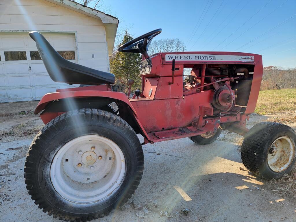

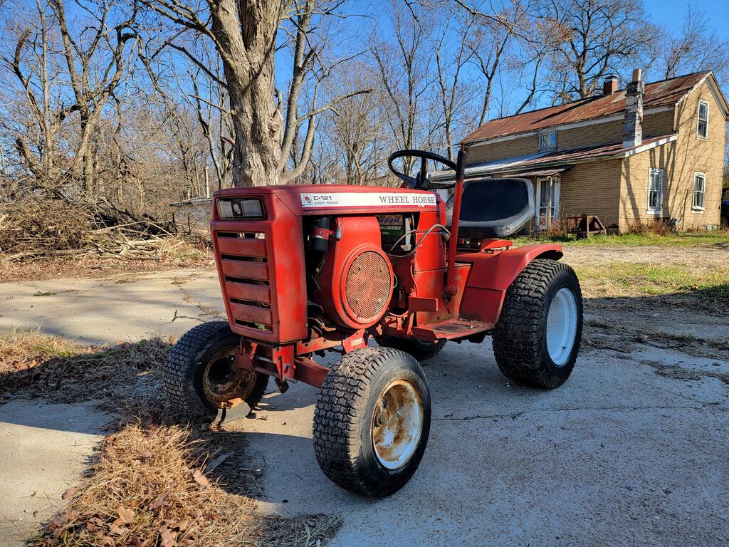

Fredo 56 #1 Posted December 1, 2021 Just picked up my 5th WH for $75! 5 2 Share this post Link to post Share on other sites

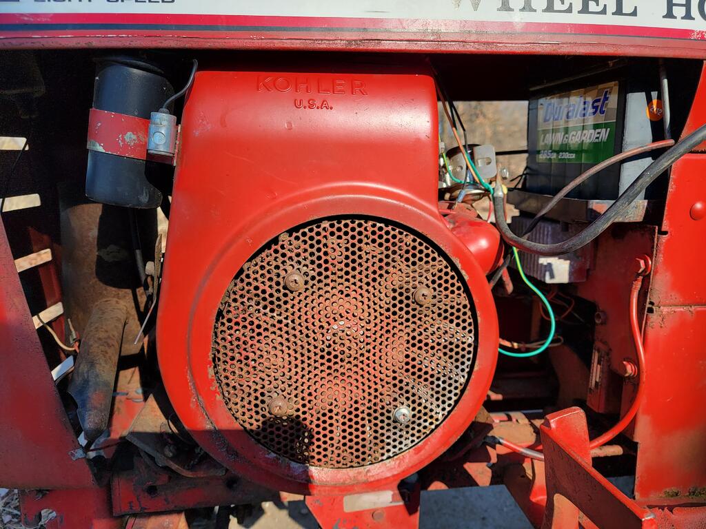

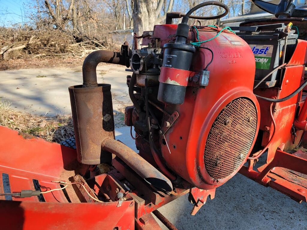

Maxwell-8 4,371 #6 Posted December 1, 2021 Nice tractor, Just way to clean to make a mudmower from! I wouldn't do it. You may want to check compression on the engine since I don't see an airfilter! If you take that tractor out mudding as is sits right know. Maybe 5min of driving before the engine sucks in a good chunk of mud. 2 1 Share this post Link to post Share on other sites

Fredo 56 #8 Posted December 1, 2021 25 minutes ago, Maxwell-8 said: Nice tractor, Just way to clean to make a mudmower from! I wouldn't do it. You may want to check compression on the engine since I don't see an airfilter! If you take that tractor out mudding as is sits right know. Maybe 5min of driving before the engine sucks in a good chunk of mud. I know what you mean but about 3 weeks I started my collection of WH's and man em I hooked! I like them all and as long people keep interest in them I am ok with poeple doing what they please with them. Oh and it did have a filter just needed it for one of the other running ones in my collection. So far i have two in really bad conditon they were sitting outside a commando 6 and a 657(i like the short frame better so will restore those or at least one of them). The other two were garage kept. 1076 hydro drive and 1056 gear tranny. 5 Share this post Link to post Share on other sites

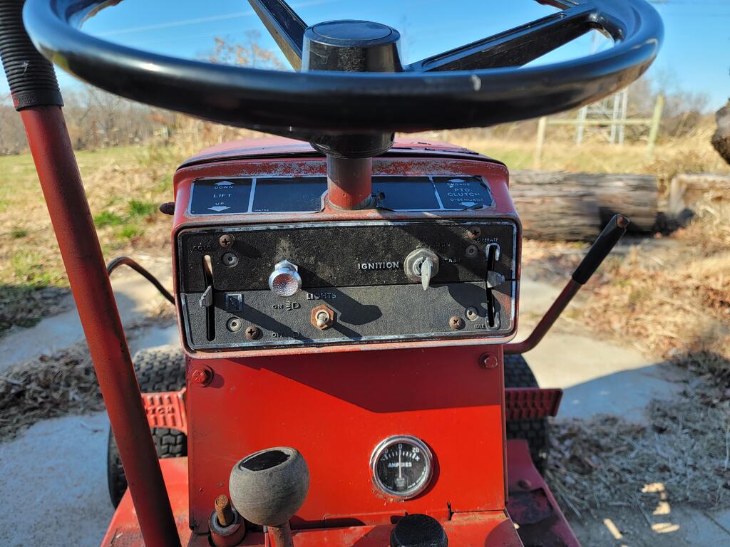

Fredo 56 #10 Posted December 1, 2021 45 minutes ago, ebinmaine said: No kidding, right? That's a good deal at three times that price. Do you have a specific plan for this tractor yet? Yes plan on having everything powder coated that i am keeping. Motor will get hot rodded and rebuilt, big mud tires and maybe 4 in lift, change to hydraulic brake use original brake pedal and location, lock the transaxle, add an accelerator, some more gauges( it has a volt gauge already). Build some bolt on rock sliders and bumper/brush guard with winch. Use existing headlight but change to LED bulbs and custom make yellow acrylic cover. Dont plan on beating on it but def have fun on my 20 acre farm. 3 1 Share this post Link to post Share on other sites

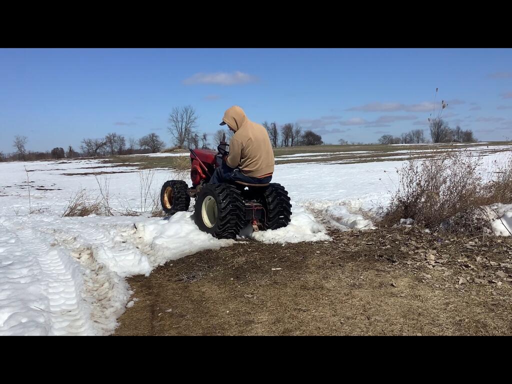

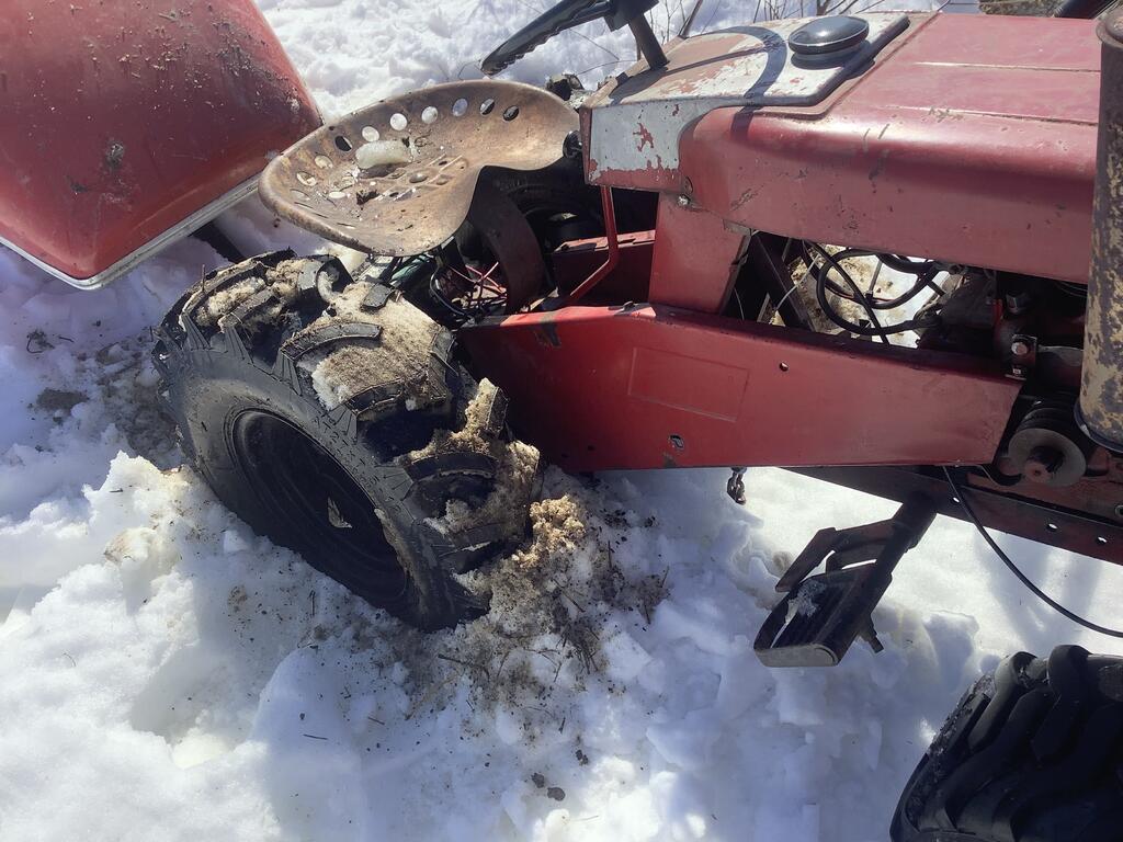

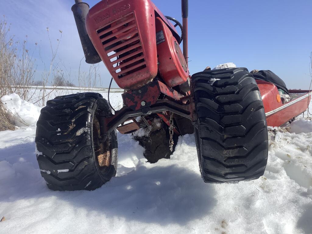

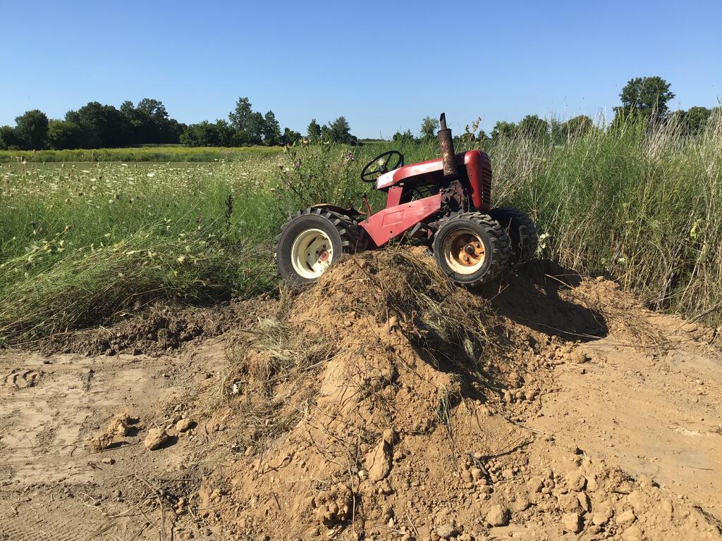

Pullstart 71,482 #11 Posted December 1, 2021 @Fredo! I know there is some extreme “mud mower” stuff on YouTube. Be careful (who am I to preach safety!?) and have fun! These are pretty dang capable as is… but I’ve never been in extreme off road conditions… just climbing over stuff and the occasional rock pile. My Commando 6 “Jane” is super tough. There’s a perfect balance of grip and weight transfer that makes this thing bite and occasionally lift the front end, but just plain go. “Poppy” the 552 round hood was purpose built to fit the obnoxiously large tires I earned on a job and generally rolls over things quite well with zero air pressure in the tires. Once slick situations or snow come though, the skinny Interco Interforce tires come out. 3 2 Share this post Link to post Share on other sites

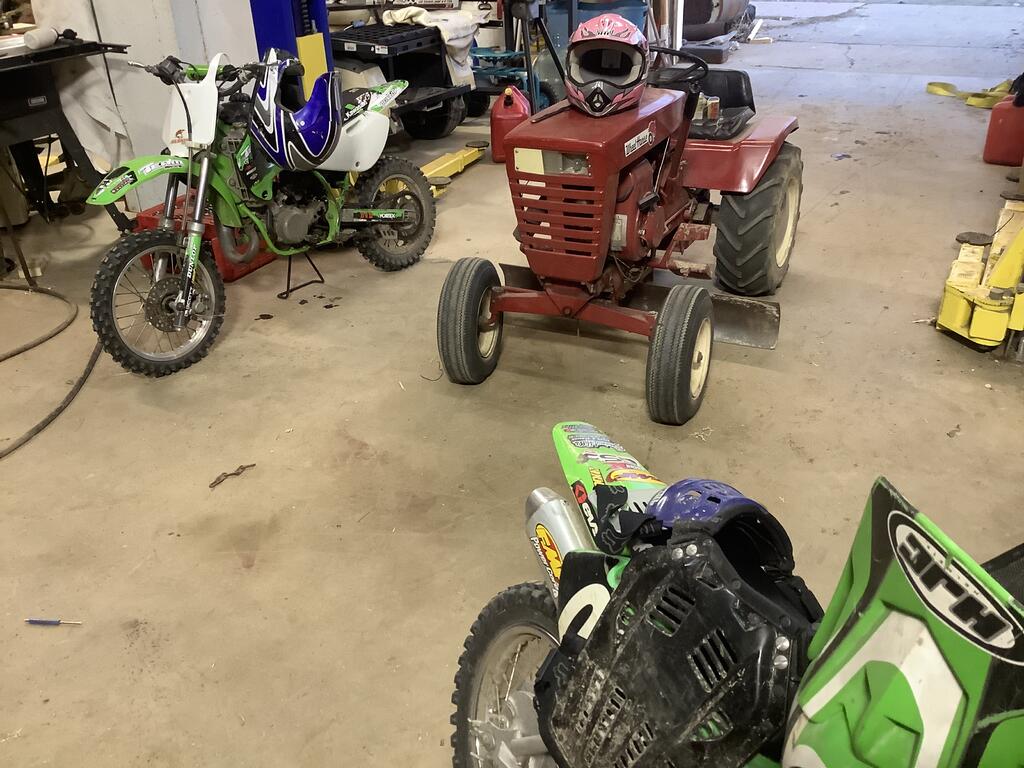

Maxwell-8 4,371 #12 Posted December 1, 2021 12 minutes ago, Fredo said: poeple doing what they please with them. You got to do what you like to do with them. Here in Belgium they are pretty rare, for sure in a nice condition. Here I would almost be a crime making a horse like yours into a mudmower. In the USA, not so much. Just to give you an idea: I bought every single horse that came up for sale in my half of the country. This is what you get here for 350€ (no runner) and 250€ (chassis) 2 Share this post Link to post Share on other sites
