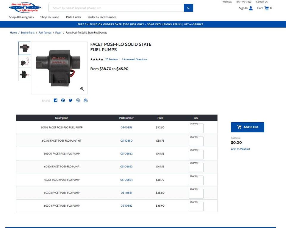

pfrederi 21,175 #3 Posted November 30, 2021 (edited) I can't speak to Onans, don't have any. For the Kohlers when a fuel pump start to leak or otherwise fail i go electric (I think I have 5 now). Facet Posi flo made in USA I have used both the 60304 1-2PSI and the 60245 1.5 -4psi. I had a cheap knock off pump failed after a few hours no issues with the posiflos. US Made may cost a bit more but.... I wire them to ACC. Turn on ignition you can hear them clicking as pressure builds up click changes and you can start up. The have an internal fuse 3.5 amps and draw very little current. Some say overhaul the existing metal fuel pump on the Kohler...but the price of the rebuild kit is about same as the posiflo. and if the Rebuild fails you might be pumping gas into your crankcase Edited November 30, 2021 by pfrederi 3 4 Share this post Link to post Share on other sites

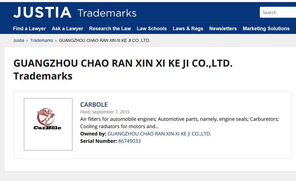

pfrederi 21,175 #7 Posted November 30, 2021 41 minutes ago, davem1111 said: Yikes - I hadn't considered that the fuel could be going through a busted diaphragm into the crankcase but I can see how that could happen. I don't know where to find the "B43" or whatever Onan model number. The manuals I have (from Toro website) say "94-1810 Engine-Onan", the pump is listed as part #57-9080. Those Facet pumps are a bit pricey but I'd rather pay more for something that won't crap out on me in a few years (or months). Maybe I'll wait a few days till I have time to mess with it some more before buying anything. Actually, I missed the post about the CarBole pump before I wrote this. Those are more "affordable". One question though: If you go with an electric, do you need to put the old pump back on just as a "cover"? Or is there a better way to plug that hole? Carbole is a registered trademark of an unpronounceable company...Want to guess where the pumps were made... Share this post Link to post Share on other sites
davem1111 2,377 #8 Posted November 30, 2021 1 hour ago, pfrederi said: Carbole is a registered trademark of an unpronounceable company...Want to guess where the pumps were made... Well, crap. Thanks for pointing that out. I'm definitely on board for cutting back on buying junk made in China. Facet Posi-Flo is made in Elmira, NY. Will go with the "Made in USA" for sure. It's worth the extra bucks. 2 1 Share this post Link to post Share on other sites
Gregor 4,848 #9 Posted November 30, 2021 (edited) 2 hours ago, davem1111 said: Those Facet pumps are a bit pricey but I'd rather pay more for something that won't crap out If you think the Facet is pricey, skip this post. This is the pump I use. I have it on several Kohlers, but I do not own an Onan. I have tried cheaper pumps. They tend to flood the carb, regardless of what their "posted" psi is. This is the only electric fuel pump I will use. Fuel Pump Edited November 30, 2021 by Gregor 1 Share this post Link to post Share on other sites
oldlineman 1,810 #10 Posted November 30, 2021 I went electric with a Facet Posi-Flo several years ago on a 1989 414-8 M14 Kohler, best thing I ever did.You can leave the old pump on to cover the hole or make or buy a cover plate to do it. Bob 1 1 Share this post Link to post Share on other sites
davem1111 2,377 #11 Posted November 30, 2021 15 minutes ago, Gregor said: If you think the Facet is pricey, skip this post. This is the pump I use. I have it on several Kohlers, but I do not own an Onan. I have tried cheaper pumps. They tend to flood the carb, regardless of what their "posted" psi is. This is the only electric fuel pump I will use. Fuel Pump I appreciate any and all info I can get. The only thing that concerns me with this Mr. Gasket pump is that it looks almost exactly like the CarBole pump, so I'd bet a small amount of money that Mr. Gasket is sourcing those from the same factory and marking them up. Happy to see proof otherwise. 1 Share this post Link to post Share on other sites
squonk 48,154 #12 Posted December 1, 2021 12 hours ago, Gregor said: If you think the Facet is pricey, skip this post. This is the pump I use. I have it on several Kohlers, but I do not own an Onan. I have tried cheaper pumps. They tend to flood the carb, regardless of what their "posted" psi is. This is the only electric fuel pump I will use. Fuel Pump That's the PosiFlo with another sticker on it. Also same as the Napa 610-1051 2 Share this post Link to post Share on other sites
