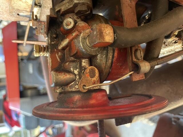

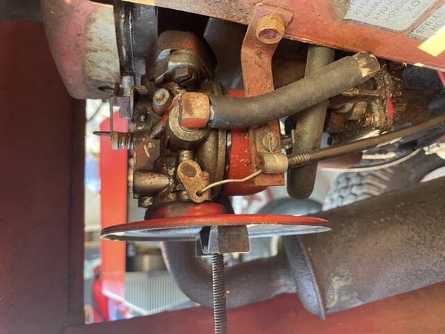

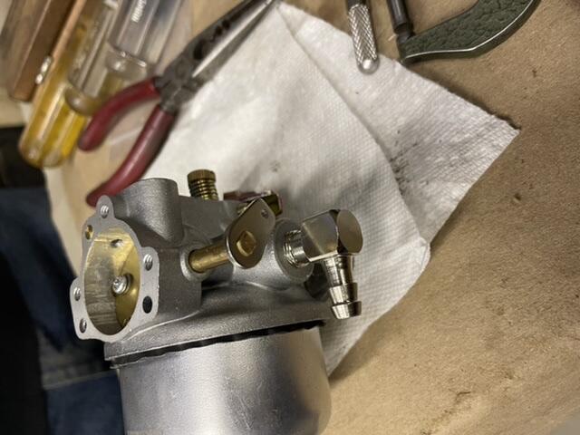

AHS 1,594 #1 Posted November 29, 2021 Ok, I’m having issues with the choke, I think the choke is 180 degrees from the old one. The choke plate is on the flat side of the shaft, and the detent ball is with it open (how it should be so it doesn’t accidentally close on you). Tell me you think… Share this post Link to post Share on other sites
pfrederi 19,893 #2 Posted November 29, 2021 A lot of the aftermarket (chicom) carbs have the choke set up for JD and other. that is opposite what WH's need. some provide an different choke shaft that you can put in... Honestly I have a couple horses where I just put a note on the instrument pane and live with reverse operation... 2 Share this post Link to post Share on other sites
WHX?? 55,024 #3 Posted November 29, 2021 (edited) Yeah that's always been a problem with the knock off carbs. Only two things you can do... one is try and get the tab off and rotate it and stake it back on. Paul beat me to the second one. Edited November 29, 2021 by WHX?? 2 Share this post Link to post Share on other sites
ebinmaine 77,349 #4 Posted November 29, 2021 @AHS I'm no fan of those Chinese carburetors but if you want to use it one option is to swap the choke shaft from the old carburetor. Your BEST option is to do as Paul said above. Do you have the old carb? You mail it down here and I'll rebuild it for you... 4 Share this post Link to post Share on other sites

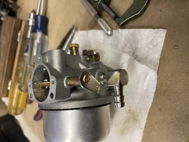

AHS 1,594 #5 Posted November 29, 2021 Ok, hold on; has anyone used one of these? That is set up right! Share this post Link to post Share on other sites
WHX?? 55,024 #6 Posted November 29, 2021 Yep that's the right one just swap them out. I was never lucky enough for that to be "in the box" Red or even green loctite on those plate screws. 58 minutes ago, ebinmaine said: @AHS I'm no fan of those Chinese carburetors Yeah I know but so fast and easy even a Squonky can do it! 1 4 Share this post Link to post Share on other sites
