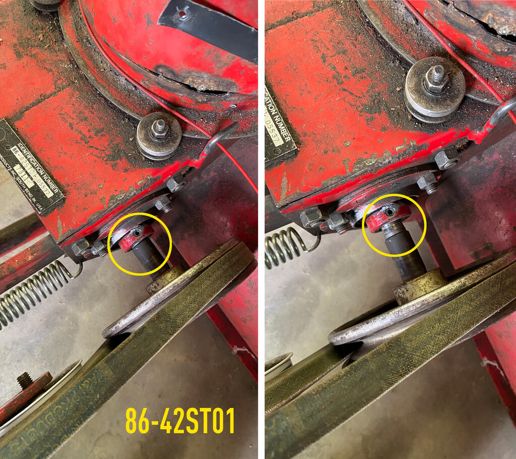

echoffmann 2 #1 Posted November 29, 2021 I have a 42ST01 blower on a 1995 520H. Last year I blew a chain, the shaft shifted to the left (as sitting on it) and rubbed on the carriage bolts for the bearing seat. I freed the allen set screws on the bearing keeper shown in the image. I can't find anything on how to set this or adjust it. If I try to tighten the set screws, the shaft is out of center and shakes. If I leave them loose, smooth as butter and the shaft seems to center with the smooth part inside that collar. You can see in the photo I can slide the shaft to the right a ways. Does this collar lock the shaft, does it go in the smooth portion showing? Any tips are greatly appreciated! Share this post Link to post Share on other sites
Jeff-C175 7,211 #2 Posted November 29, 2021 (edited) 3 hours ago, echoffmann said: Does this collar lock the shaft I believe that the collar turns and locks onto the shaft. Is there another hole in the collar, without a setscrew? If so, you put a punch in that hole and use a hammer to turn the collar to lock onto the shaft, then tighten the set screw. I think they call it a 'cam lock' bearing or some such. This video may help: I don't believe the shaft should be 'stepped' as in your picture though: It sorta looks like that bearing has been loose for a long time and wore the shaft down. You may be looking at a more extensive repair job. Check out https://thebigbearingstore.com/ I've purchased a bunch of stuff from them and satisfied with the price and quality. Edited November 29, 2021 by Jeff-C175 2 Share this post Link to post Share on other sites
gwest_ca-(File Mod) 12,510 #3 Posted November 29, 2021 The shaft should be 3/4" diameter on this 1978 model. In 1987 they went to a 7/8" shaft. The collar on the bearing is rotated on the shaft in the same direction the shaft rotates in operation until tight and the set screw is tightened. The collar ensures the shaft does not spin inside the bearing. Perhaps the bearing is starting to fail? 1 Share this post Link to post Share on other sites
ri702bill 13,190 #4 Posted November 29, 2021 All: I for one am NOT a fan of eccentric lock style shaft collars - they have to be installed correctly for direction as Gary stated, and they do NOT tolerate vibration well at all over time. Seen that all too many times over the years as a Machine Design Engineer - we flat out would not use them in any of our products. Bill 1 Share this post Link to post Share on other sites
peter lena 10,090 #5 Posted November 29, 2021 @echoffmann agree with @ri702bill on the lock collar type of bearing . you are actually in a good easy to get at spot , for a refit. bolted flange bearings , a new shaft , also do a lubrication upgrade on your bearings , that is a major failure area . lucas x-tra heavy duty , made for hi heat and stress , get some . do a detail rebuild , lubricate and enhance every stage , that assembly should spin up easily . your chute base is reflective of needing care / service , I have the same blower . spins up by hand . pete Share this post Link to post Share on other sites

echoffmann 2 #9 Posted December 5, 2021 On 11/29/2021 at 4:16 AM, gwest_ca said: The shaft should be 3/4" diameter on this 1978 model. In 1987 they went to a 7/8" shaft. The collar on the bearing is rotated on the shaft in the same direction the shaft rotates in operation until tight and the set screw is tightened. The collar ensures the shaft does not spin inside the bearing. Perhaps the bearing is starting to fail? I tried that and pretty sure SOMETHING has failed. The collar never gets tight, just free spins. Thanks for the direction...looking like a more extensive repair, or watch for a replacement. Share this post Link to post Share on other sites
lynnmor 9,051 #10 Posted December 5, 2021 1 hour ago, echoffmann said: I tried that and pretty sure SOMETHING has failed. The collar never gets tight, just free spins. Thanks for the direction...looking like a more extensive repair, or watch for a replacement. The shaft is the wrong size or worn, if that is not the case the bearing is wrong. Share this post Link to post Share on other sites
