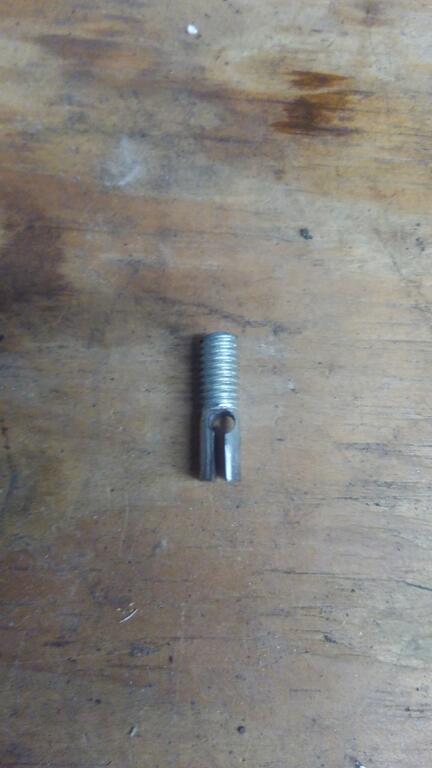

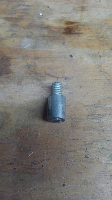

JPWH 6,544 #30 Posted December 11, 2021 Just a couple small pieces to mount some threaded knobs. 2 Share this post Link to post Share on other sites

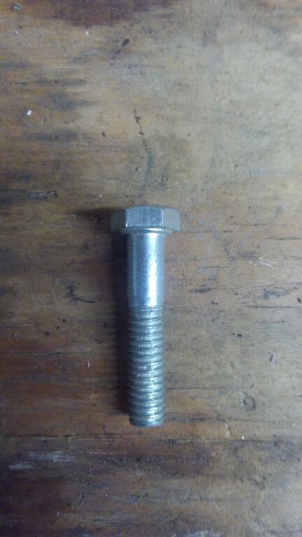

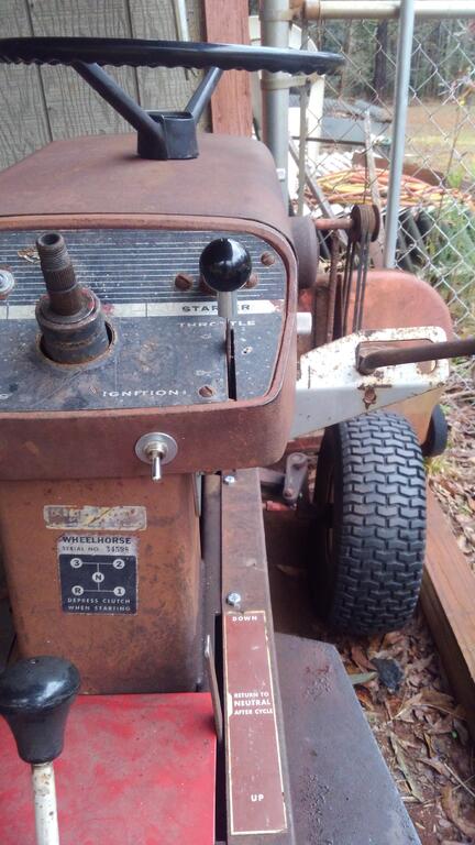

JPWH 6,544 #31 Posted December 11, 2021 One custom throttle knob complete. 2 4 1 Share this post Link to post Share on other sites

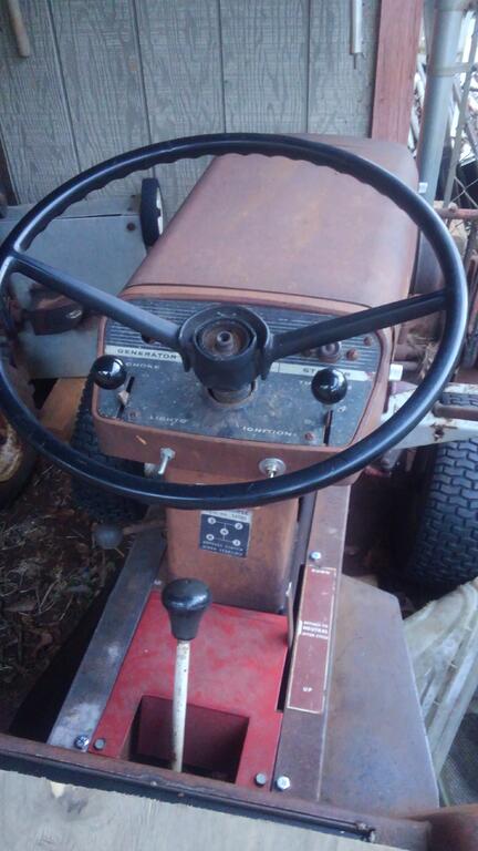

JPWH 6,544 #33 Posted December 12, 2021 I was playing in the shop early this morning. I spent a few minutes with the grinder with a cut off wheel, the drill press, and the lathe. 1 5 Share this post Link to post Share on other sites

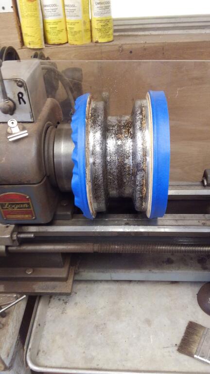

JPWH 6,544 #42 Posted December 12, 2021 This was the worst wheel. Even with the lathe it took a while to get it cleaned up. 4 2 Share this post Link to post Share on other sites
Pullstart 71,386 #43 Posted December 12, 2021 Looks great! I know some people have repaired pitted wheels with JB Weld or PC7. Great opportunity to smooth that thing out too! 2 Share this post Link to post Share on other sites
oliver2-44 11,782 #44 Posted December 12, 2021 I’ve used both PC7 and JB Weld on rim pitting in the beat area. Both work, although PC7 is a little thicker. I apply with a putty knife best I can. Then lay wax paper or clear cellophane wrap on it and smooth with my fingers through the wrap. Leave the wrap in place until dry. I then use a coarse file to work it down close and finish with sandpaper. Using the file and the wheel in the lathe should work great. 5 Share this post Link to post Share on other sites

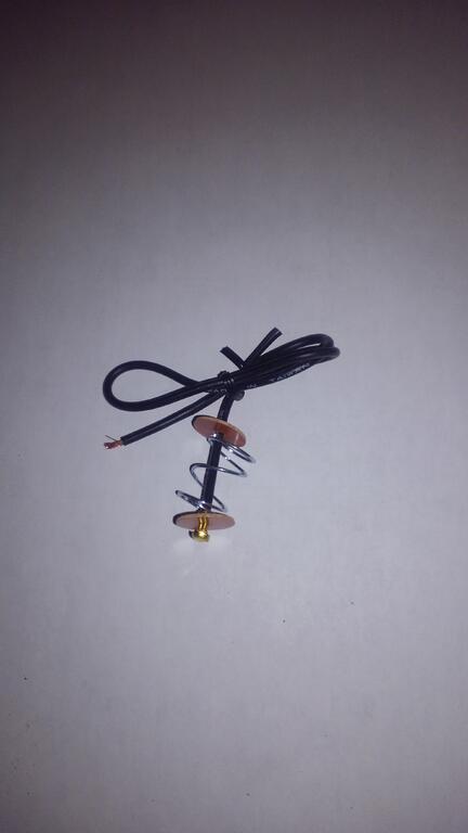

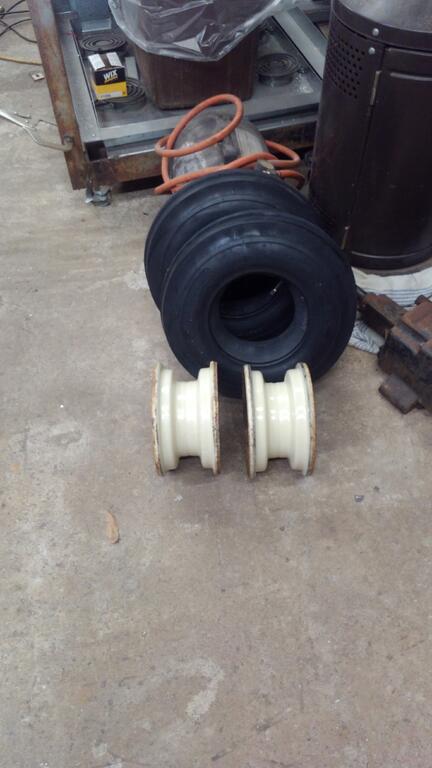

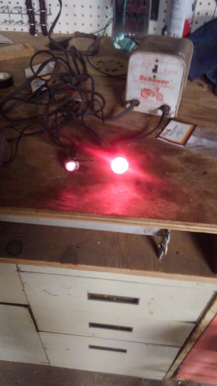

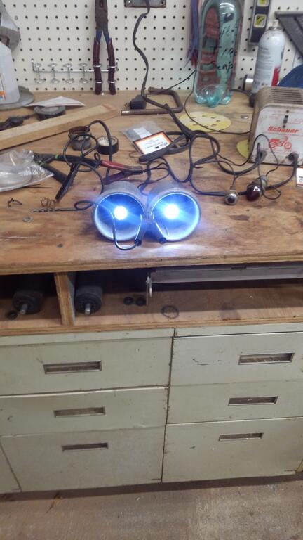

JPWH 6,544 #47 Posted December 16, 2021 The inside of the rims are painted. I'm letting them sit a few days before I mount the tires. I also got all the new light socket pigtails installed and tested the headlights, tail light, and the gen warning light. 3 6 Share this post Link to post Share on other sites
