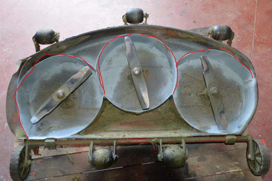

Maxwell-8 4,371 #3 Posted November 28, 2021 This is a 42" side discharge deck that I converted into a mulcher. The redlines is where I added steel. Their is a link to it in my signature (underneath this post.) Share this post Link to post Share on other sites
Jack Orsi 2 #4 Posted November 28, 2021 Thanks Maxwell. Will look at converting to side discharge now that I know which baffles to remove. Deck came with the side discharge cover so I suspected it might be a kit. Deck and spindles seem to be in good shape and I always wash after use but it dies accumulate and also makes for uneven cutting. Ihave a tow behind sweeper so if it's really windrowish I can always sweep. It takes about 4-41/2 hrs to do front and back yards. Share this post Link to post Share on other sites
