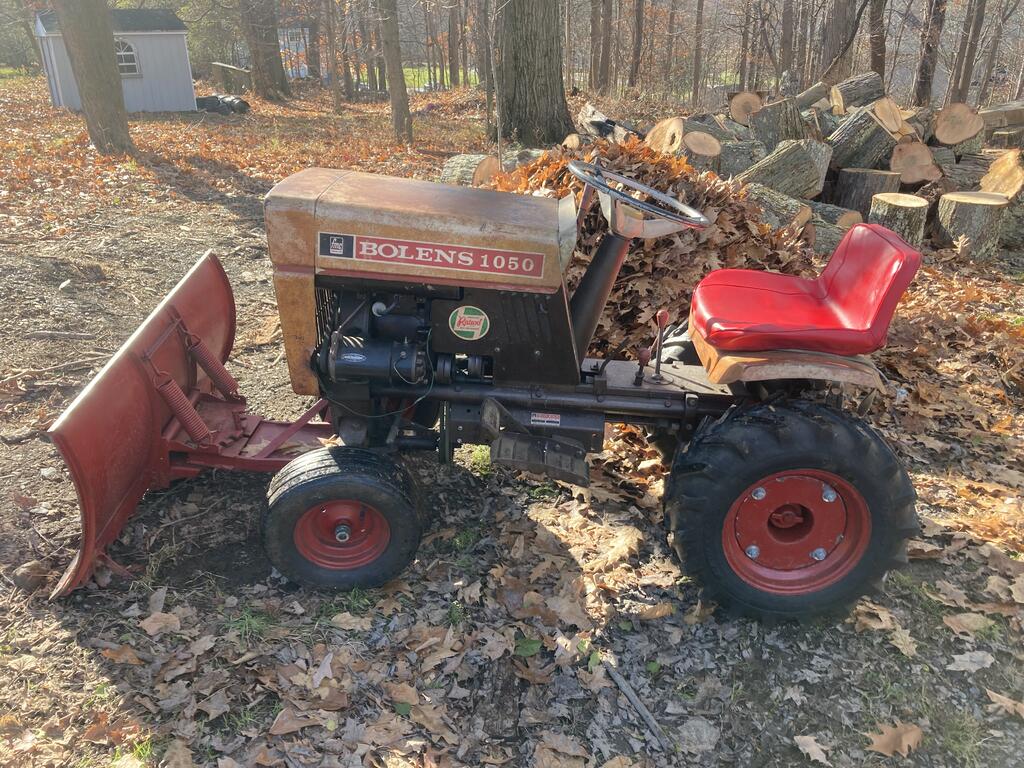

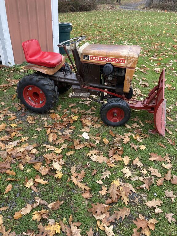

Ifixoldjunk 778 #1 Posted November 27, 2021 So this tractor here can be blamed for every rusty old garden tractor that’s ever followed me home. It’s never given me any trouble. Until recently anyways. I came down with Covid and life just got in the way, so the tractor just kinda sat for a few months. After getting it to run it ran perfectly until I tried to get it to move. As soon as I let of the clutch it’s a 50/50 shot whether it just stalls out or gets moving. It doesn’t really start easily either. I’ve ran seafoam through the carb and it idles perfectly. Does anyone have any clue what I should try next? You think it’s a clutch issue or a carb issue? 1 Share this post Link to post Share on other sites

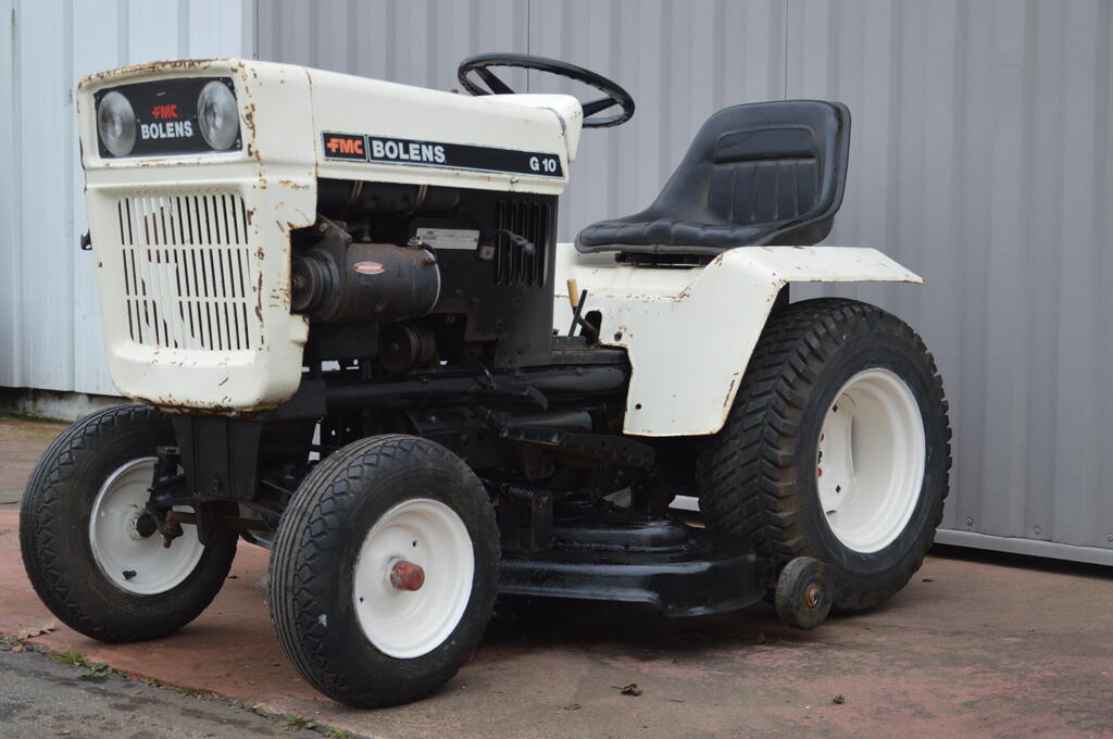

Maxwell-8 4,371 #18 Posted November 30, 2021 On 11/27/2021 at 11:39 PM, Ifixoldjunk said: Bolens certainly aren’t as straightforward as wheel horses to repair. Tell me 2 Share this post Link to post Share on other sites
Ifixoldjunk 778 #19 Posted December 1, 2021 3 hours ago, Maxwell-8 said: Tell me nice one. always liked the g10 1 Share this post Link to post Share on other sites
Maxwell-8 4,371 #20 Posted December 1, 2021 5 hours ago, Ifixoldjunk said: nice one. always liked the g10 Currently having some tranny problems. The detent balls for the shifter somehow disappeared. Share this post Link to post Share on other sites
Ifixoldjunk 778 #21 Posted December 2, 2021 18 hours ago, Maxwell-8 said: Currently having some tranny problems. The detent balls for the shifter somehow disappeared. First thing I'd check is to make sure that the shift rod didn't pop out from between the plungers. That's happened to me before. But truth be told Bolens gearboxes are kinda sucky. 1 Share this post Link to post Share on other sites
