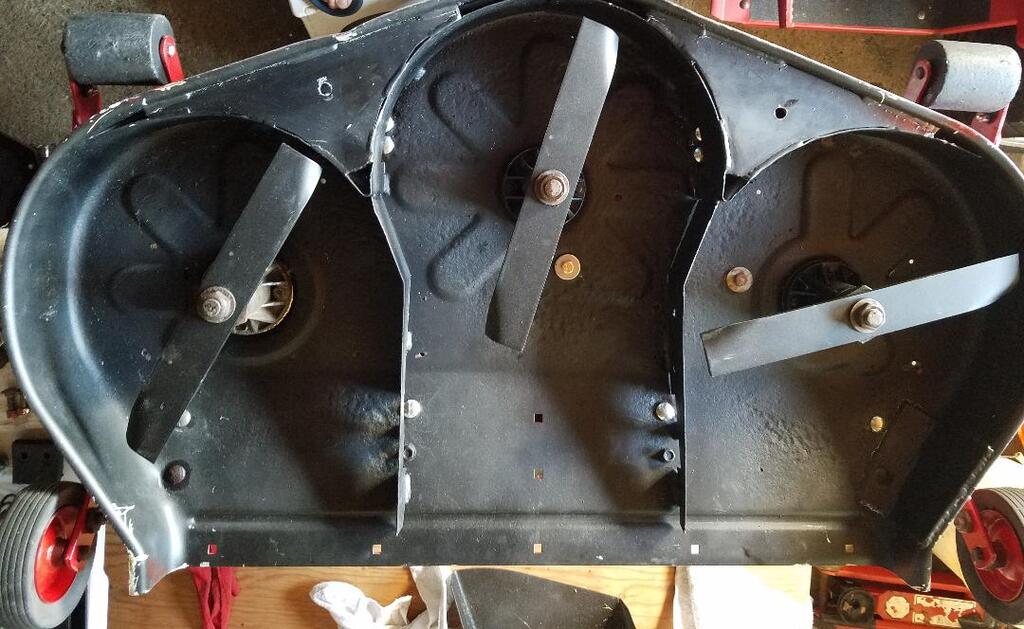

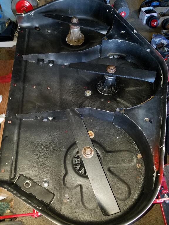

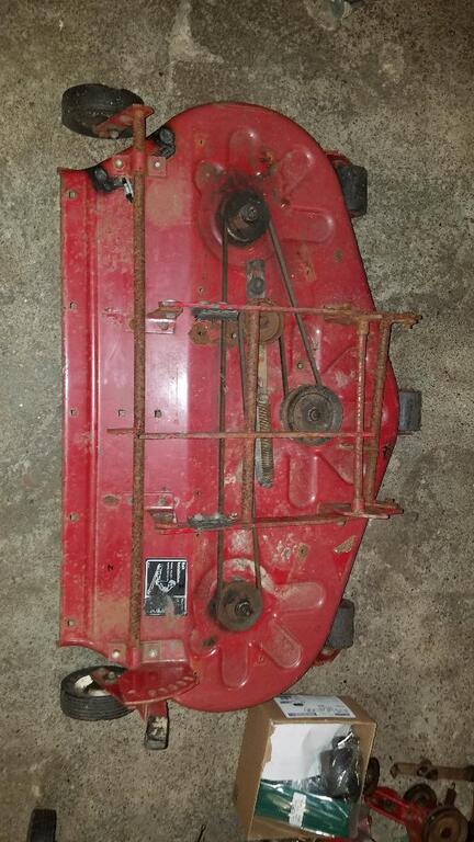

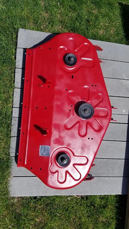

Brockport Bill 2,455 #1 Posted November 24, 2021 Curious? I recently acquired a 1980 era 42 inch RD mower 05-42mr01.... i recently disassembled - had sand blasted, then I painted, as well as did some mechanical work. I checked diagrams online and they show the two different spindles - oriiginal and successor -- my curiosity is about the washers between the blades and the spindle? It appears many decks have a "thin" washer between the blade and the spindle and the heavier, thicker, washer is between the nut and blade. However, the online diagrams and what I found on this RD is two thicker washers - including the thicker washer between the blade and spindle? I understand the concept of the thicker washer between nut and blade to distribute the nut physics across the heavier washer -- but does it matter much if using a thin washer or thicker between the blade and spindle -- and WHY the difference in the original production spindle of using thicker washer both sides of blade ? (See some before and after photos attached ) --- thanks 1 Share this post Link to post Share on other sites
pfrederi 21,046 #2 Posted November 24, 2021 to keep the blade tips even I have had to switch washers around even add or subtract some. After 40 years the deck shells can be deformed... 1 Share this post Link to post Share on other sites

JoeM 10,155 #5 Posted November 24, 2021 Looks like you have two different spindles, the ones with the big hex takes a thick washer and the small hex on the spindle take the thin. Must have to do with what Paul said keeping the tips in line dimensionally. Spindle Shaft Washer Difference Large Nut vs Small Nut.pdf 2 Share this post Link to post Share on other sites
