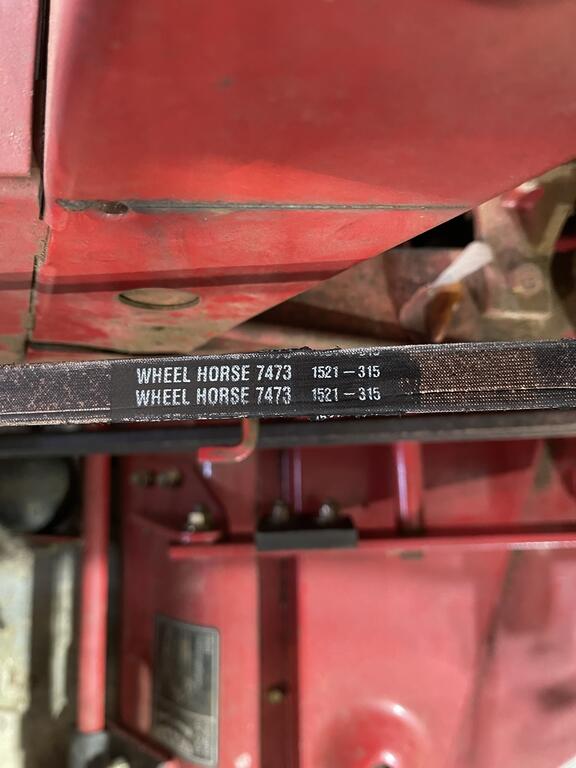

wallfish 19,754 #8 Posted November 23, 2021 Is that an actual OEM belt or a "the same" equivalent from another supplier? A rubber sided belt will certainly grab quick as $%!* so it should be a cloth covered belt. Understanding the clutching action is actually the belt slipping on the engine pulley helps to narrow down a solution to try and get it to slip more during pedal movement. A new belt tends to have some memory in it from the packaging too so wearing it in as suggested like letting it slip and driving up to an immovable object like a wall or tree and running plenty of tension on it could help. Just be careful and ready!!!! If there are belt guides around the engine pulley like little rods around the belt, maybe they are holding the belt too tight into the pulley groove. They should be about 1/8 inch off the belt when it it's tight. Same for the belt guard if there's a tab on the bottom it can be adjusted. If the pulleys are rusted or especially if they're painted it can be either slip or grab just like you have. no in between. The idea is to get that belt to slip on the engine drive pulley a little more which would solve the quick starts. Easier said than done but take a good look at why it's not slipping as the belt should only grab when it's somewhat forced into the groove. Have any of the pulleys changed? Even a larger idler pulley can change the clutching time. Does the pedal have a lot of swing to it or is it like it's already half pushed down? Post some pictures with belt guard off 2 Share this post Link to post Share on other sites
Snoopy11 5,731 #9 Posted November 24, 2021 12 minutes ago, wallfish said: Is that an actual OEM belt or a "the same" equivalent from another supplier? Yeah, my thoughts exactly. What you could do is go an extra inch on the belt size, which would give you more play with the clutch. Very important to note where you bought the belt. My thoughts.. buy original from Lowell... Don 1 Share this post Link to post Share on other sites

76-C120 20 #11 Posted November 24, 2021 2 hours ago, wallfish said: Thanks all for the thoughts... I'll grab some pics in the morning. The belt is a genuine Wheel Horse. Nothing has been repainted, and it's 99% original 1976. It's been garage/shed kept since new, so rust it's really bad. The belt guard is in place, wouldn't dream of running without it. I expected it to have more bite, but dang, not like that. Guess the old one was really stretched. 1 Share this post Link to post Share on other sites

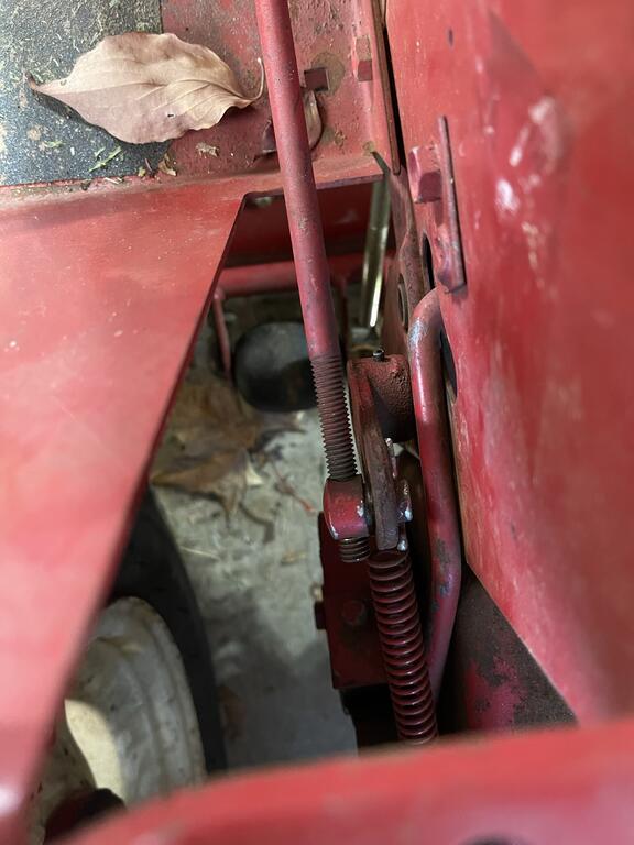

gwest_ca-(File Mod) 12,166 #12 Posted November 24, 2021 The pedal return spring may be weak from use/age. A stronger one gives you more control. A drop of oil on the pivots will also help. 1 Share this post Link to post Share on other sites

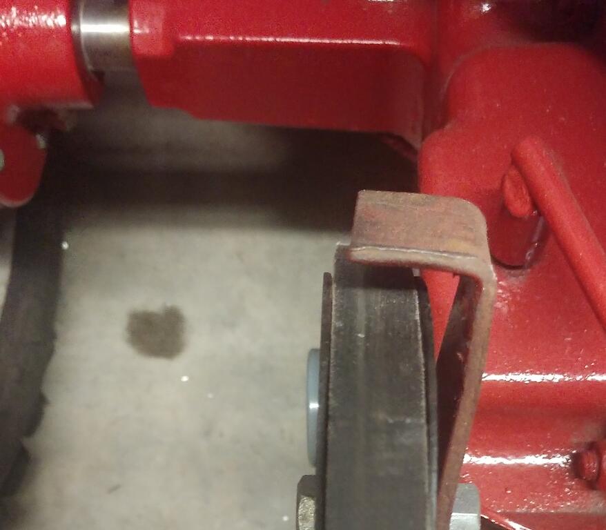

kpinnc 17,931 #13 Posted November 24, 2021 Is the little tab over the idler pulley bent like the one in the pic below? That tab should grip the belt as the clutch is depressed, effectively stopping it. You should have to loosen or remove the idler pulley to change the belt if the tab is in the correct position. The one in the picture is actually wrong. It's been bent so many times be the previous owner that I may never get it right again. 1 Share this post Link to post Share on other sites

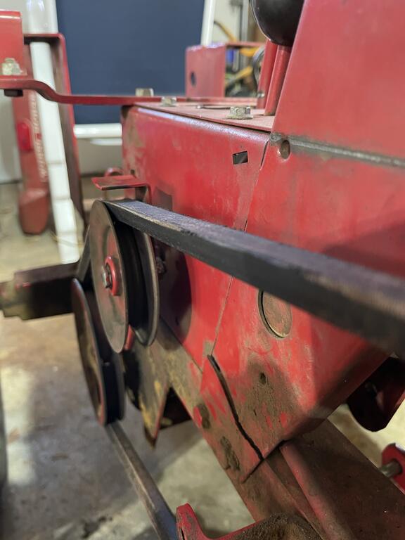

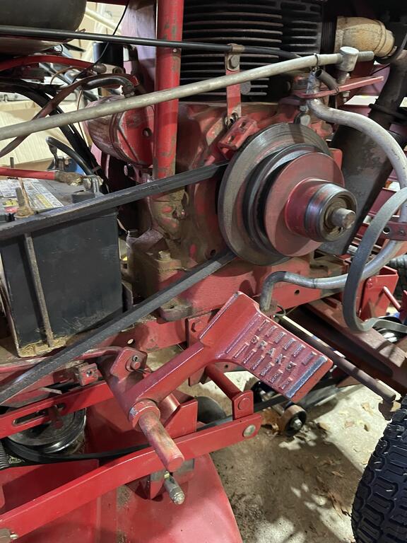

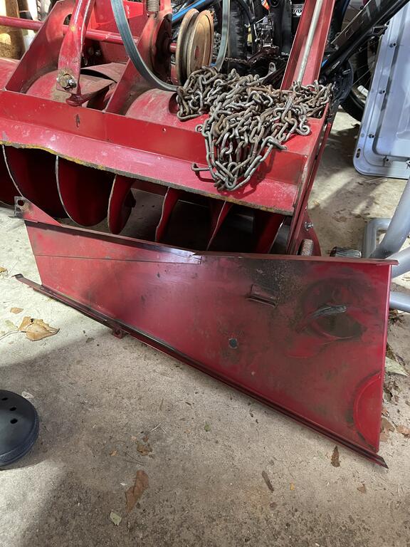

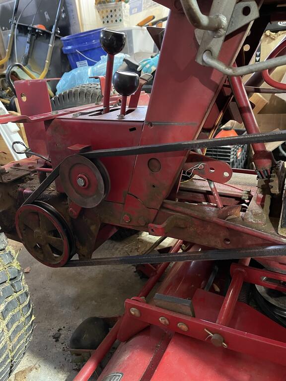

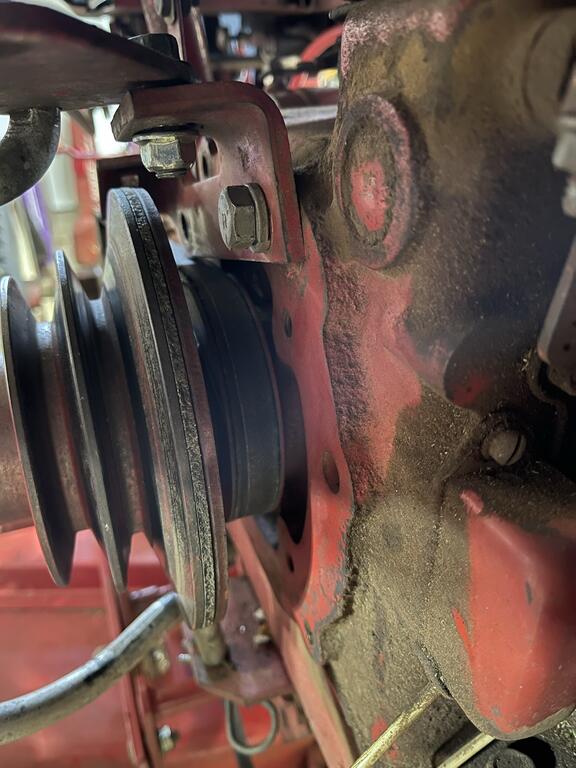

76-C120 20 #15 Posted November 24, 2021 Here are the pics... For the roll pin fix, I was able to get the broken one out and bought a new one. I also included a pic of the belt cover, all the tabs are in place. I had to adjust the clutch linkage so it would engage the safety switch. For the idler pulley, yes, I have to remove it to get the belt off, so that tab should be in the correct position. 1 Share this post Link to post Share on other sites
daveoman1966 3,882 #16 Posted November 24, 2021 Another cracked hoodstand...have seen a bunch of these over the years. 1 Share this post Link to post Share on other sites
76-C120 20 #17 Posted November 24, 2021 19 minutes ago, daveoman1966 said: Another cracked hoodstand...have seen a bunch of these over the years. I have a welder. I had to fix the belt cover. The tab that mounts to the engine was broken when I took it apart. 1 Share this post Link to post Share on other sites

Snoopy11 5,731 #20 Posted November 24, 2021 2 hours ago, 76-C120 said: For the idler pulley, yes, I have to remove it to get the belt off, so that tab should be in the correct position. That is pretty odd. You should not have to take the idler pulley off to get the belt off. You should just be able to push the clutch in, and reach down and pull the belt off the idler pulley. Obviously, if the belt is not the right size (i.e. not stretched out enough)... getting the belt on/off will be a lot harder. BUT, you still shouldn't have to take that pulley off... hmm... Don 1 Share this post Link to post Share on other sites
pfrederi 20,305 #21 Posted November 24, 2021 4 minutes ago, Snoopy11 said: That is pretty odd. You should not have to take the idler pulley off to get the belt off. You should just be able to push the clutch in, and reach down and pull the belt off the idler pulley. Obviously, if the belt is not the right size (i.e. not stretched out enough)... getting the belt on/off will be a lot harder. BUT, you still shouldn't have to take that pulley off... hmm... Don With a welded tab you usually do have to at least loosen the idler pulley to get the belt in. 3 Share this post Link to post Share on other sites
Snoopy11 5,731 #22 Posted November 24, 2021 Just now, pfrederi said: With a welded tab you usually do have to at least loosen the idler pulley to get the belt in. Seriously? Mine is welded... Don 1 Share this post Link to post Share on other sites
Snoopy11 5,731 #23 Posted November 24, 2021 Okay, so I think I understand now. So... the tab is not providing enough clearance to get the belt onto the pulley... thus why he has to remove the pulley to get the belt onto the pulley, then re-install. Well, even though that is a pain in the behind, it has to be done... Don 1 Share this post Link to post Share on other sites
Snoopy11 5,731 #24 Posted November 24, 2021 I think the original belts from Wheel Horse were not kevlar, rather, they had polyester cords. Therefore, the belts stretch. I think this is the issue here... the belt needs to get stretched out a bit. 13 hours ago, gwest_ca said: The pedal return spring may be weak from use/age. A stronger one gives you more control. A drop of oil on the pivots will also help. The return spring should be tense enough so that the belt stretches a little over a ride or 2... Don 1 Share this post Link to post Share on other sites
