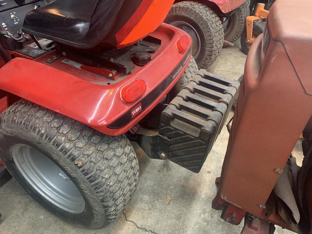

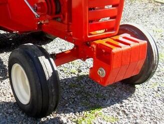

wh5208speed 677 #1 Posted November 21, 2021 For plowing snow, I have used rear wheel weights & chains for years. I bought a snowblower a few years ago and when I was loading it up, the seller said “these weights are supposed to go with it”. It basically bolts in place of the rear drawbar and secured under the rear fender bracket. Holds 6-25# suitcase weights. My Dad is a retired machinist, so we are going to make some copies of this rear weight bracket for some of our other Wheel Horses. 9 1 Share this post Link to post Share on other sites

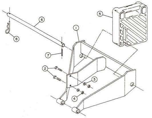

gwest_ca-(File Mod) 12,510 #3 Posted November 21, 2021 Looks like the Bervac model in this manual. 2 Share this post Link to post Share on other sites
JCM 11,419 #4 Posted November 21, 2021 In the WH / Toro Lawn and Garden bulletin # 050988 it shows that set up available for 3,4 and 500 Series tractor and a Ber vac blower. In 1989 I was quoted at the dealer $1700.00 for the 2 stage blower with wheel weights and the 520-H was $ 4000.00 and a 42'' deck was $ 700.00. 1 Share this post Link to post Share on other sites

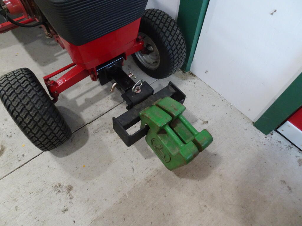

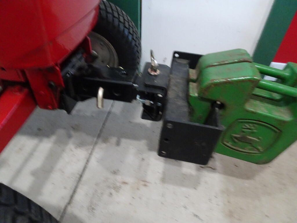

doc724 927 #8 Posted February 10, 2022 You can buy a suitcase weight bracket from Heavy Hitch. It fits into a standard 2 inch receiver hitch and is made to work with JD suitcase weights. Someone on the forum here was making the brackets with the receiver hitch and they bolted to the tractor in the same manner as the rear tach-a-matic (aka snow plow hitch). Suitcase weights are usually the problem. You can find them but they are pricey. Share this post Link to post Share on other sites

sergeant 350 #10 Posted February 28, 2023 (edited) Here is what I did for Front suitcase weights and the same set-Up will work On this https://wheelhorsepartsandmore.com/product/heavy-duty-removable-receiver-hitch-with-axle-mounting-hardware-if-you-do-not-have-a-104659-bracket/ I had to also Purchase the 2-inch sleeve Hitch adapter from Heavy Hitch https://heavyhitch.com/product/sleeve-hitch-adapter-2-inch-receiver/ and rear sleeve Hitch weight Bracket from Johnny Product's 4X Multi Suitcase weight Pinned weight receiver it will cost about $362.00 Before Tax & shipping to run what I have for the rear of My wheel Horse The Other way and a Bit lower cost would be buy this https://wheelhorsepartsandmore.com/product/heavy-duty-removable-receiver-hitch-with-axle-mounting-hardware-if-you-do-not-have-a-104659-bracket/ and then Buy this https://heavyhitch.com/product/6-weight-bracket-for-2-receiver-hitch/ which will be about $272.00 before Tax and shipping But here is what I have On the front https://www.ebay.com/itm/131944396619?chn=ps&mkevt=1&mkcid=28&srsltid=Ad5pg_Fk59eFLoQsr78dzkkt1Yu3SuXC8cdRog2Nb1U02pXGu2Op0MIB1d0 to use 4 suitcase weights with the Heavy Hitch sleeve Hitch insert to the Johnny Products 4X Multi Suitcase weight Pinned weight receiver I think it does sit out to far in the front I may invest in the 6 suit case weight Bracket from Heavy hitch to use on the front as well as the weight will be closer to the front end Edited February 28, 2023 by sergeant 1 Share this post Link to post Share on other sites
