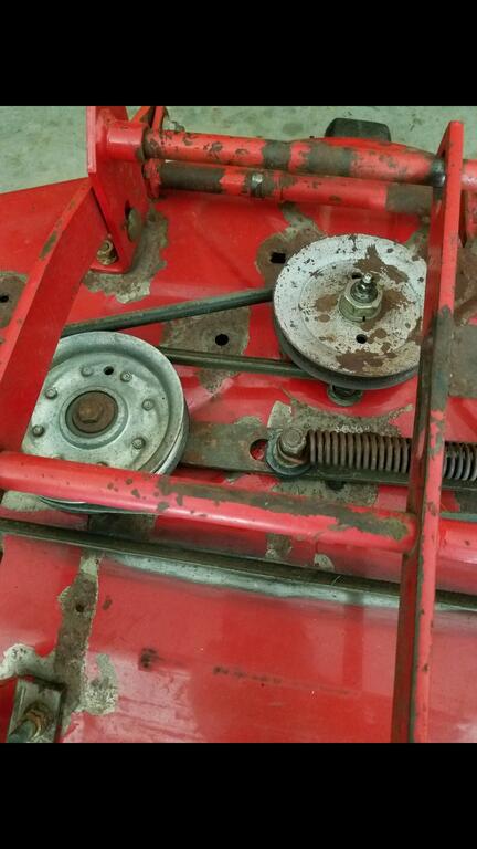

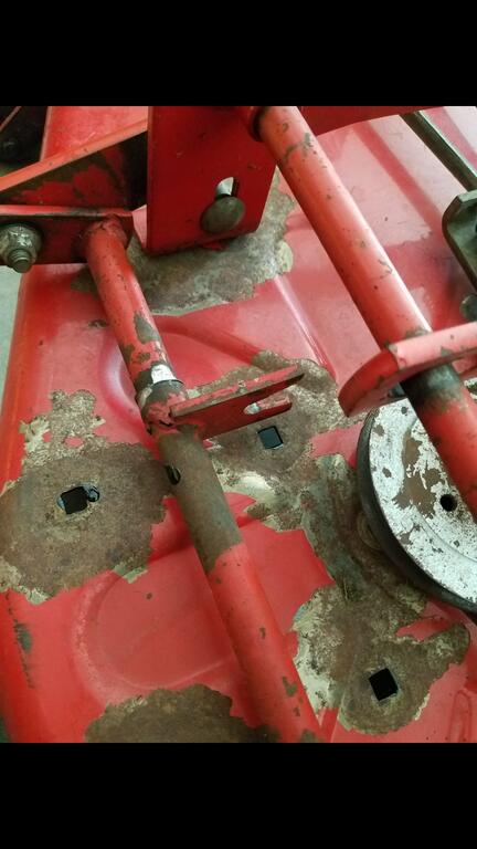

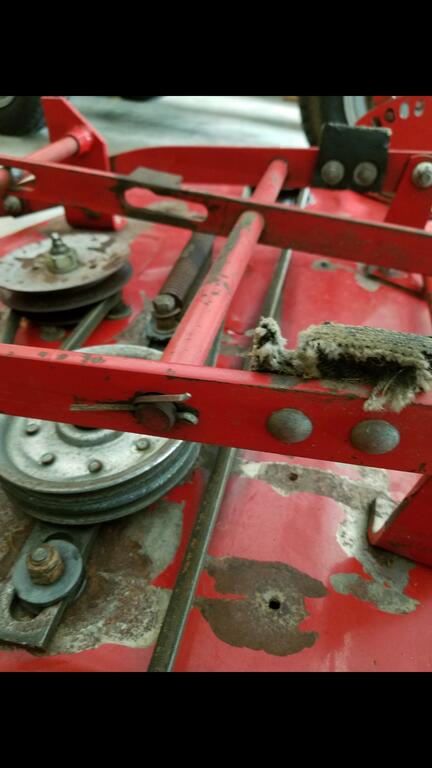

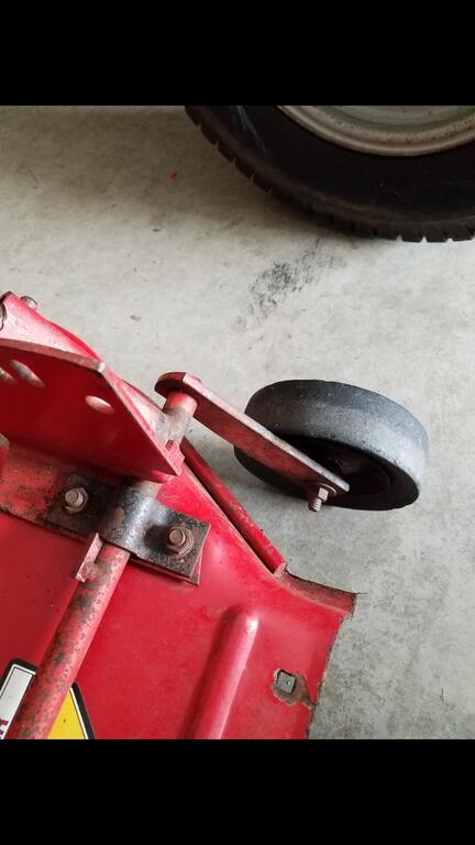

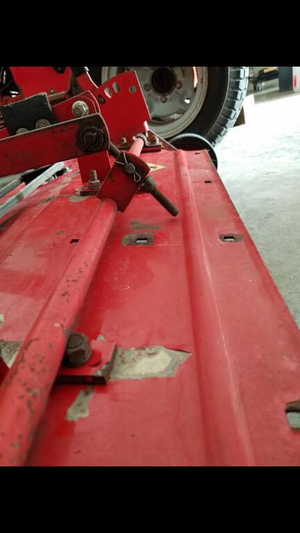

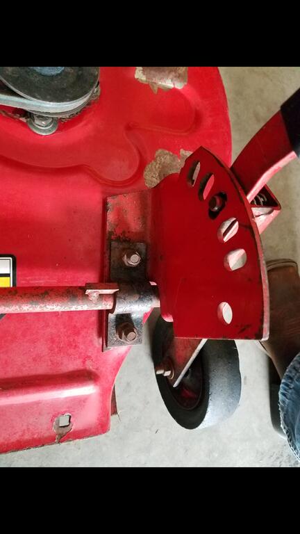

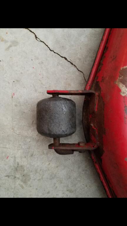

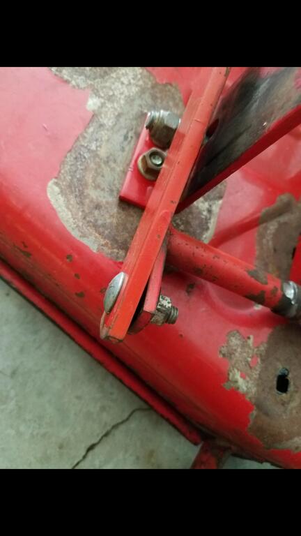

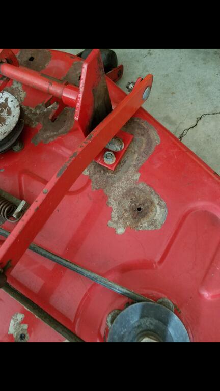

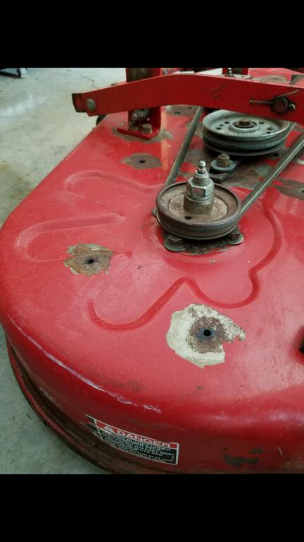

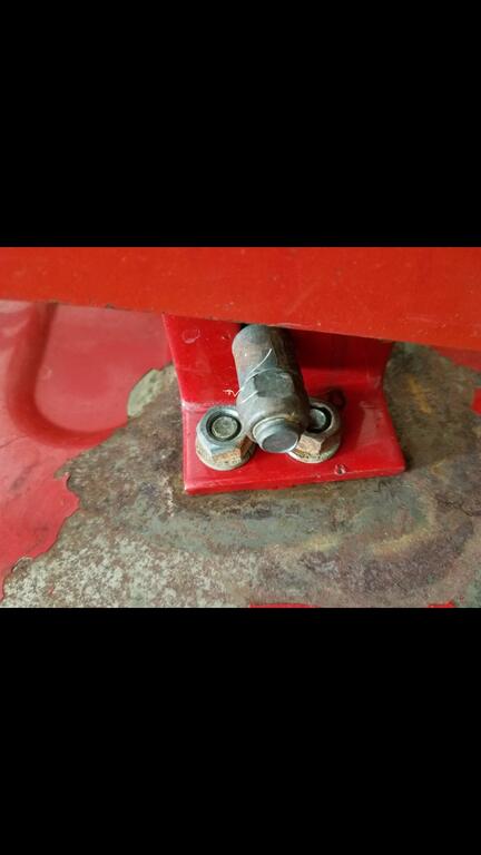

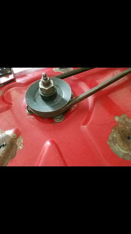

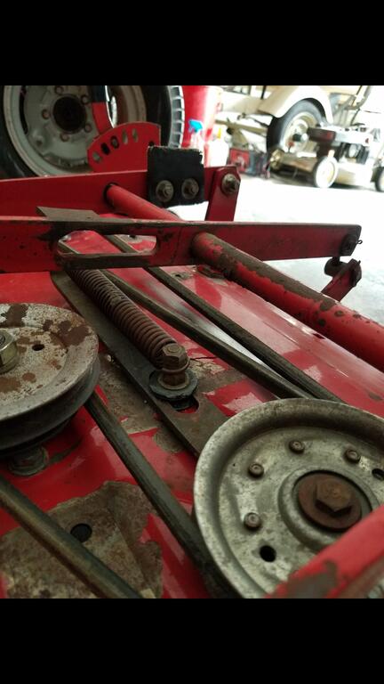

Mustang67ford 234 #3 Posted November 21, 2021 Here are some pica of my deck. In the process of going over it and fixing up. Do any of these help identify it? Share this post Link to post Share on other sites

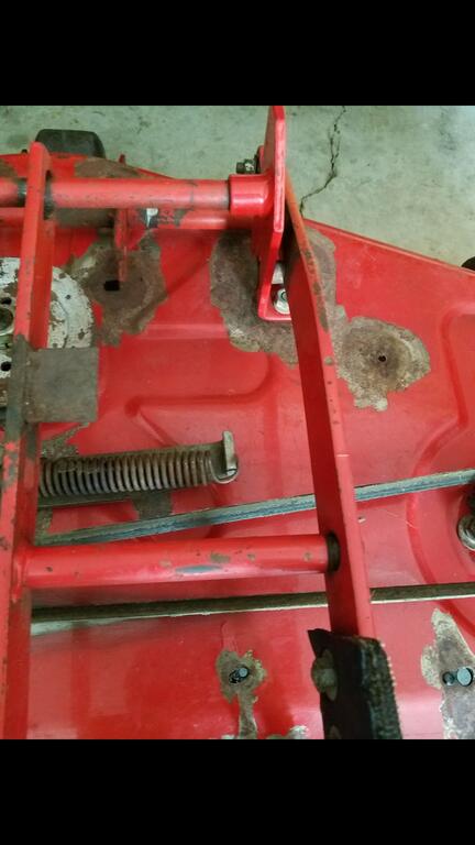

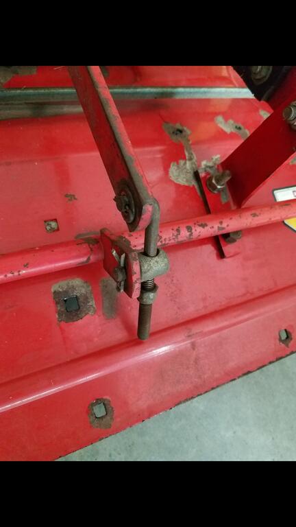

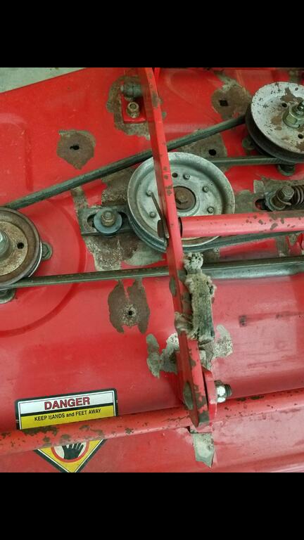

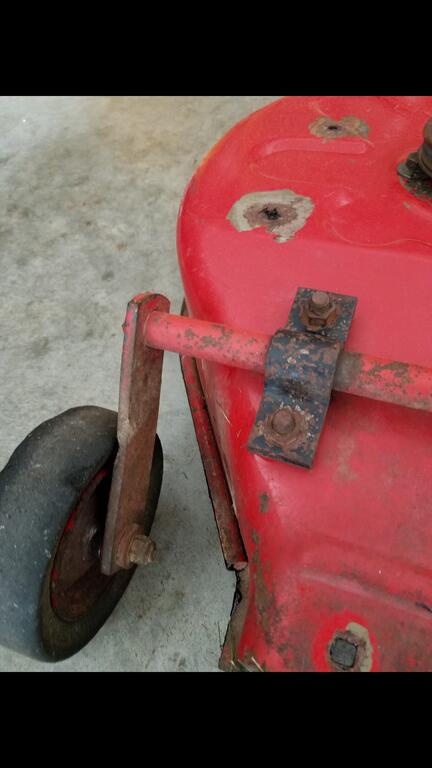

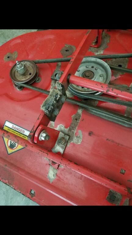

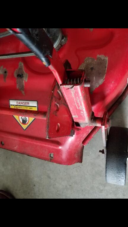

Mustang67ford 234 #5 Posted November 21, 2021 17 minutes ago, gwest_ca said: This may help Mower DNA 1976 model 65-42MR01 replaced by - (Has the flat spindle belt idler pulley mounted on a triangular plate.) - (Has multi-link hardware at the gauge wheel support) 1977 model 75-42MR01 - Both use blades with 5/8" x 3/4" double-D center hole unless the spindles have been upgraded. (Has the flat spindle belt idler pulley mounted on a triangular plate) - (Has multi-link hardware at the gauge wheel support) ---------------------------------------------------------------------------------------------------------------------------------------------------------------------------------------------------------------------------------------------------------------- These all use blades with 3/4" center hole. 1977 model 75-42MR02 replaced by - (Has the flat spindle belt idler pulley mounted on a flat bar) (Has multi-link hardware at the gauge wheel support) 1978 model 85-42MR01 - (Has the flat spindle belt idler pulley mounted on a flat bar) (Has multi-link hardware at the gauge wheel support) 1979 model 95-42MR01 - No ipl available 1979 model 95-42MR02 - (Has no multi-link hardware at the gauge wheel support) 1980-1983 model 05-42MR01 1984 model 05-42MR02 - Last year for bearings with 3/4" ID 1985 model 05-42MR03 - First year for bearings with 17mm ID unless older spindles were updated. 1986-1988 model 05-42MR04 1989-1990 model 15-42RC01 1990-1992 model 15-42RC02 1993-2012 model 78350 Note - 17mm is .669" Thank you. Posted some pics of my deck. Share this post Link to post Share on other sites
roadapples 6,987 #6 Posted November 21, 2021 Don't know the number, but that's the good one with that heavy rod welded around the front for extra strength... Share this post Link to post Share on other sites
Mustang67ford 234 #7 Posted November 21, 2021 57 minutes ago, roadapples said: Don't know the number, but that's the good one with that heavy rod welded around the front for extra strength... You mean the rod around the bottom lip? 1 Share this post Link to post Share on other sites

roadapples 6,987 #9 Posted November 21, 2021 5 hours ago, Mustang67ford said: You mean the rod around the bottom lip? Yup.... Share this post Link to post Share on other sites

Lee1977 7,709 #11 Posted November 23, 2021 (edited) The only thing you need the number for is the mower blades and belts I'm sure someone can help you with that. It has metric 17 mm spindles the bearing are number 6203. The pulleys and Idler will be the same as any 42" Metric WH deck. Edited November 23, 2021 by Lee1977 Share this post Link to post Share on other sites
Mustang67ford 234 #12 Posted November 23, 2021 1 hour ago, Lee1977 said: The only thing you need the number for is the mower blades and belts I'm sure someone can help you with that. It has metric 17 mm spindles the bearing are number 6203. The pulleys and Idler will be the same as any 42" Metric WH deck. I was looking thru the blade selection pdf and noted many different 42" RD decks. I would assume something would have changed between models. Share this post Link to post Share on other sites
gwest_ca-(File Mod) 12,354 #13 Posted November 23, 2021 Early bearings for decks with 3/4" blade hole is 6203-12 (12/16" = 3/4" ID) Late bearings for decks with 3/4"center hole is 6203-RS or 6203-2RS depending on the number of seals. (17mm ID is .669 ID) The OD of the 6203 is the same - 40mm Many years ago bearings used in North America were mostly inch sizes and in Europe they were metric. The metric won out so we ended up with many hybrid bearing sizes so older equipment with inch sized shafts could be maintained. Fafnir and New Departure are two very old companies that supplied North America. Share this post Link to post Share on other sites
