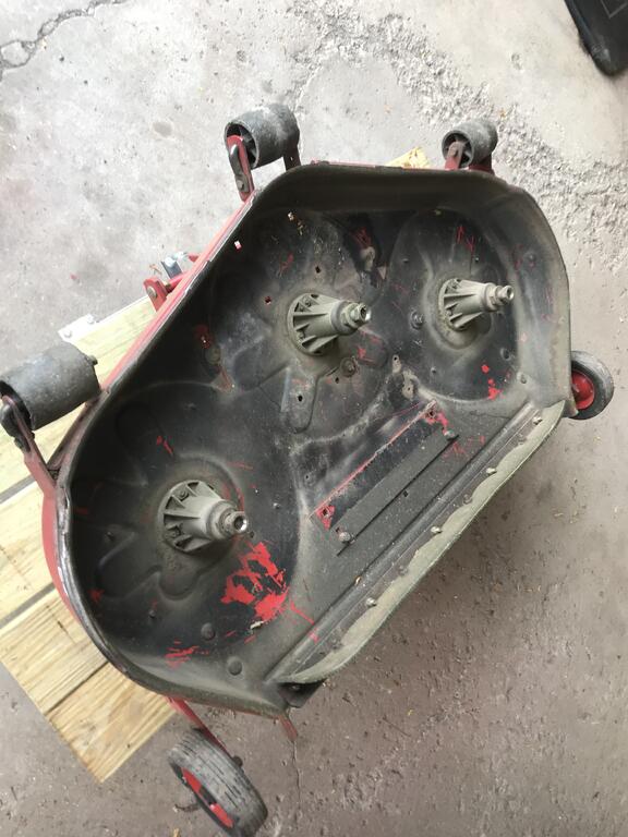

lynnmor 8,902 #10 Posted November 21, 2021 6 minutes ago, Mustang67ford said: Thanks. The spindals are not smooth on the sides, they have veins. At this point, a photo would be helpful. You may have spindles from a different brand. Share this post Link to post Share on other sites
JoeM 10,095 #11 Posted November 21, 2021 4 hours ago, JoeM said: These are the gator blades I used on the 42 rear. They have a little more lift, are used on the side discharge mowers. I am not sure if the make a low lift gator. @Mustang67ford Share this post Link to post Share on other sites
Mustang67ford 234 #12 Posted November 22, 2021 On 11/21/2021 at 1:29 PM, lynnmor said: At this point, a photo would be helpful. You may have spindles from a different brand. Will get a photo and post soon. Share this post Link to post Share on other sites

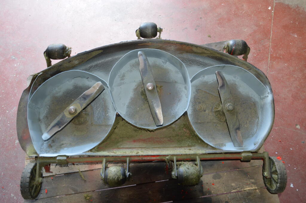

Maxwell-8 4,371 #17 Posted November 23, 2021 (edited) @Mustang67ford Or you will have to modified your deck to mulch if you like me can't find a recycler insert Like I did: a link is in my signature Here are some pictures. Edited November 23, 2021 by Maxwell-8 1 Share this post Link to post Share on other sites
Handy Don 16,953 #18 Posted November 23, 2021 4 hours ago, Maxwell-8 said: @Mustang67ford Or you will have to modified your deck to mulch if you like me can't find a recycler insert Like I did: a link is in my signature Here are some pictures. Nice work. I'm also a convert to "recycling" the grass (I don't know why it took me so long, but that's another story...) and am fine with the clippings being a bit visible. Lasts only until a good breeze or shower comes along. 1 Share this post Link to post Share on other sites
Maxwell-8 4,371 #19 Posted November 23, 2021 19 minutes ago, Handy Don said: Nice work. I'm also a convert to "recycling" the grass (I don't know why it took me so long, but that's another story...) and am fine with the clippings being a bit visible. Lasts only until a good breeze or shower comes along. we started with closing off the exit on the side discharge, but the clippings were mindblowing! Now we are happy to say, clippings are very limited! 1 Share this post Link to post Share on other sites

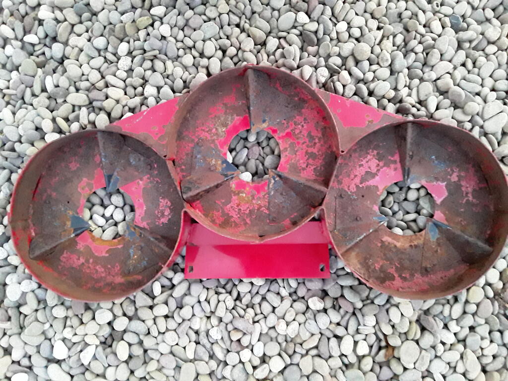

76c12091520h 4,238 #22 Posted November 24, 2021 (edited) 5 hours ago, squonk said: The insert traps a lot of debris behind it but I take it out a couple times a year. It keeps the underside of the deck pristine. Squonk, do you have the "kickers" installed on the recycler insert? I have used a 42" recycler for 25 yrs, and just added a set of the Gator blades last year. That combination absolutely pulverizes leaves and grass. Best cutting deck Toro or Wheel Horse ever made, as you long as you mow regularly and correctly. Edited November 24, 2021 by 76c12091520h Share this post Link to post Share on other sites
squonk 47,403 #23 Posted November 24, 2021 Yes kickers installed. Lots of debris gets behind them too. I take them off couple times a year to clean them also. Share this post Link to post Share on other sites

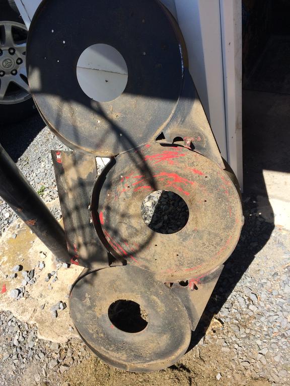

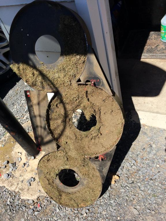

squonk 47,403 #24 Posted November 24, 2021 Here's how much dirt and dust gets trapped with the insert. 99% of it just sweeps right out. And what gets trapped under the kickers 1 Share this post Link to post Share on other sites

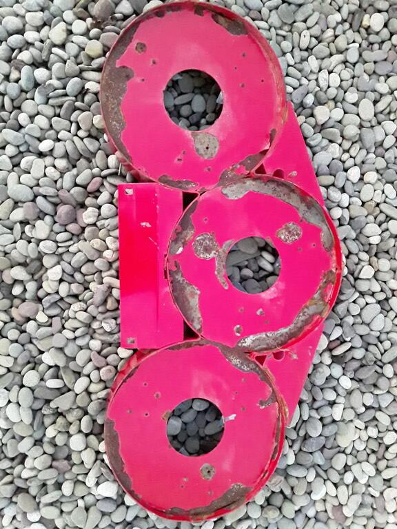

76c12091520h 4,238 #25 Posted November 25, 2021 This is my "sorta" NOS recycler insert. This was part of a dealer buyout from back in May and the story I got is that it was removed from a recycler deck before it ever left the dealership. The downside is that they got sick of having it in the way , so it spent 25+ years outside leaning up against the building covered in dirt and crap from grass clippings accumulating on it.. It will be getting sandblasted and powdercoated prior to installation in a 42" recycler that I am in the process of restoring. 2 Share this post Link to post Share on other sites
