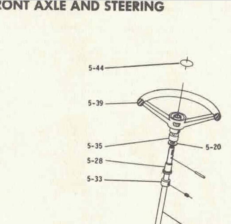

RandyL 53 #1 Posted November 20, 2021 What do I need to know to remove my steering wheel from my '74 C-120? Parts diagram shows a long roll pin, which I do see. Seems I read a post here some time past about life is all fun and games, until you want the roll pin out of the steering wheel. Searching posts has not shed any light. Any thought would be appreciated before I beat, cut, and drill. Thanks! Share this post Link to post Share on other sites

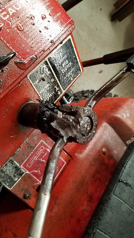

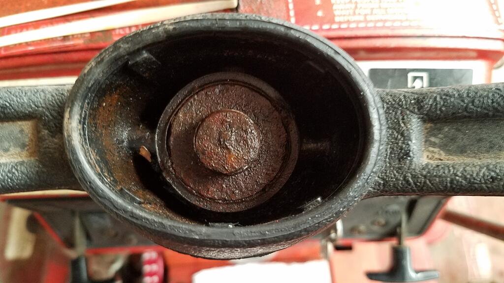

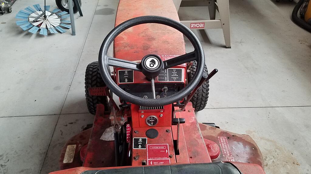

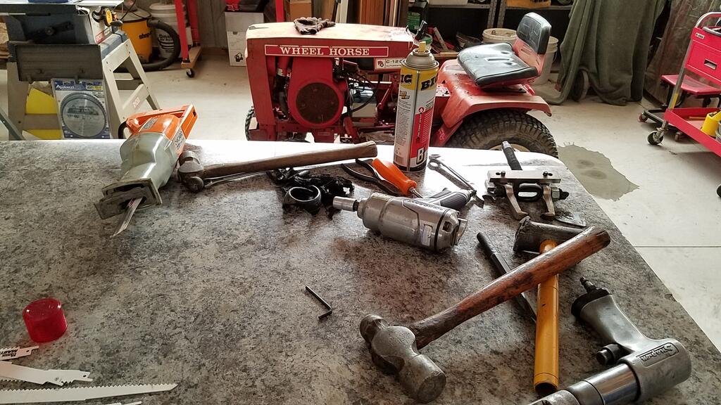

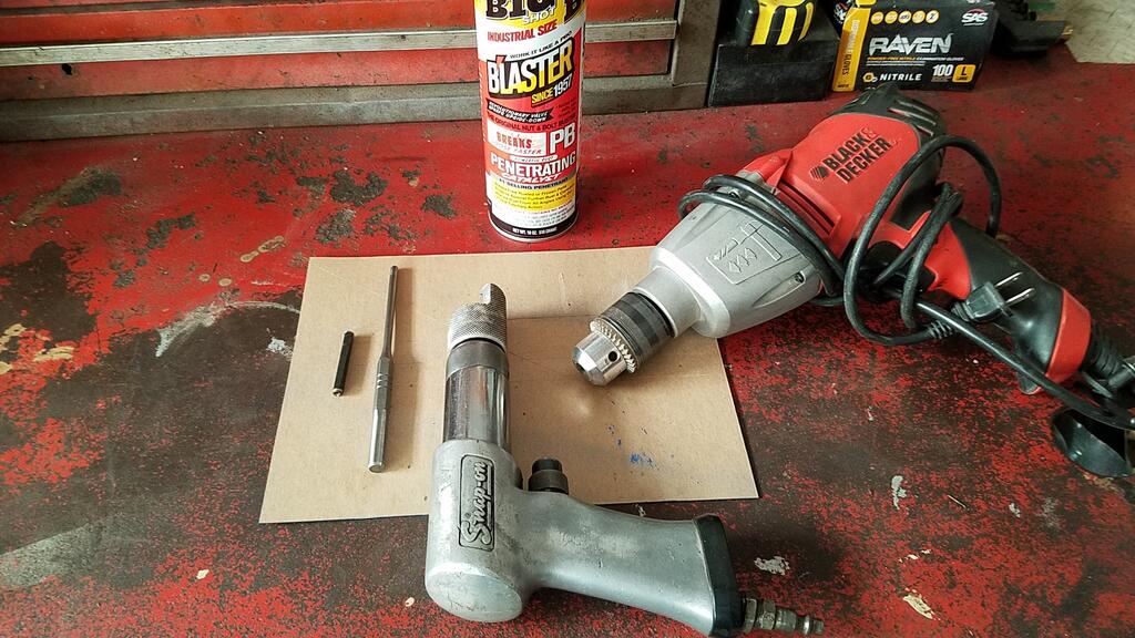

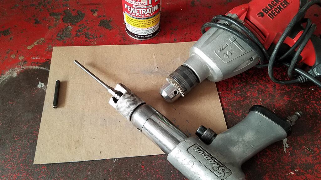

RandyL 53 #20 Posted November 26, 2021 OK... Here is my steering wheel update. Not sure I can keep it real short as it was a long project! To start with, thanks for all the ideas and advice. I used PB Blaster and a hammer drill with a 7/32 roll pin punch to soak and vibrate the roll pin for about 4 days. Today, I put that punch in a lathe and turned it to .400 so it would fit my air chisel. A moderate pull of the trigger and the pin was moving, a couple more blurps and the pin was out. No bracing etc, just the air chisel and me holding the wheel. I thought I was home free. As it was the battle had only started. The wheel won't come off. I took a sawsall and cut the rubber away so I could heat the coller. Even cherry red ( and ruining lower plastic sleeves ) it woudn't budge. Next I pull a puller on it and heated it again, no dice. Finally too sawsall and some time but cut a slice off the hub to expose the shaft. I then kept spaying PB Blaster and used a standard chisel bit in the air chisel and fin got it to budge...Gee whiz, that was a fast 3 hours this morning. Sanded and polished the shaft until I could easily press the new wheel on. I'm there...and love it! Its on as temp until body work, amybe next summer. 1 1 Share this post Link to post Share on other sites
Handy Don 17,462 #21 Posted November 26, 2021 Well you gave it your all and were victorious in the end! That shot of the hub looks like it'd been filled with water for YEARS. Good work. Share this post Link to post Share on other sites
RandyL 53 #22 Posted November 26, 2021 Yes sir, Months ago it looked even worse before I started knocking rust off of it. Originally I thought that may that was a bolt in the center. I finally understood what I was looking at. It was a tough go. Usually I am pretty patient but it gave me no choice but to get ugly with it. Thanks! 1 Share this post Link to post Share on other sites
