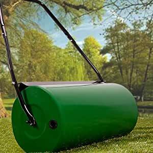

echris 1,426 #10 Posted November 27, 2021 4 hours ago, Travas said: concrete instead of air How do you fill it? Chip the concrete into little pieces and funnel them through the Schrader? It reminds me of the sound my Dad's hand roller made when I was a kid. We were working on some project and the roller filled with water just wasn't cutting it. Pops needed more weight. He filled it with gravel and I will forever remember the sound of gravel rolling around in a roller/compactor for hours on end. One of these, only not new, shiny and crappy. His was old, rusty, and is probably still alive and well today at my brothers' house. lol Share this post Link to post Share on other sites
