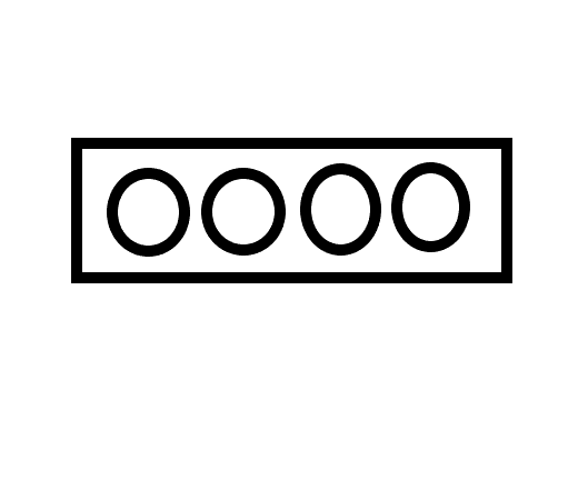

953 nut 69,555 #3 Posted November 19, 2021 1 hour ago, Gregor said: pre-stressed concrete floor If yours is like the pre-stressed slabs I have worked with there are several voids filled with air in the slab that will give some reasonable amount of insulation compared to a sloid concrete slab. You will probably find that the heater will run less to make up temperature than if it maintained it all night. 2 Share this post Link to post Share on other sites
Gregor 4,848 #4 Posted November 19, 2021 (edited) 23 minutes ago, 953 nut said: If yours is like the pre-stressed slabs I have worked with there are several voids filled with air in the slab Yes they are basically hollow, with a webbing. End view of my concrete slabs There is a 4" slab poured on top of these. Edited November 19, 2021 by Gregor Share this post Link to post Share on other sites
953 nut 69,555 #5 Posted November 19, 2021 3 minutes ago, Gregor said: they are basically hollow, with a webbing R Value is about 2 as compared to 0.4 for a solid slab. It isn't much but better than nothing. The basement area probably helps cool your shop in the summer. Share this post Link to post Share on other sites
