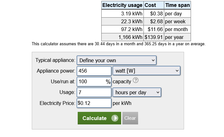

Gregor 4,848 #32 Posted November 21, 2021 (edited) 16 hours ago, Gregor said: I calculated it costs .55 per hour to run the furnace, electricity wise anyway. Seems I made a mistake in using the electricity calculator. Actual cost is 5 1/2 cents per day rather than 55 cents per hour. If this is not right, let me know, but I hope it is. I found another electricity calculator on line. According to it, my cost is 38 cents per day, if the furnace runs for 7 hours. Math never was my strong suit. I've never really found my strong suit. Edited November 21, 2021 by Gregor Share this post Link to post Share on other sites

SylvanLakeWH 32,601 #34 Posted November 21, 2021 40 minutes ago, Gregor said: I found another electricity calculator on line. According to it, my cost is 38 cents per day, if the furnace runs for 7 hours. Seems awfully low to me… Share this post Link to post Share on other sites
Gregor 4,848 #35 Posted November 21, 2021 Calculator 3.8 Amps X 120 volts = 456 watts Share this post Link to post Share on other sites

Maxwell-8 4,371 #37 Posted November 23, 2021 On 11/21/2021 at 3:16 PM, Gregor said: Calculator 3.8 Amps X 120 volts = 456 watts 0.12$ a kWH, we pay close to triple that here in Belgium.... 1 Share this post Link to post Share on other sites
