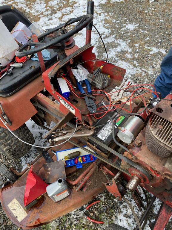

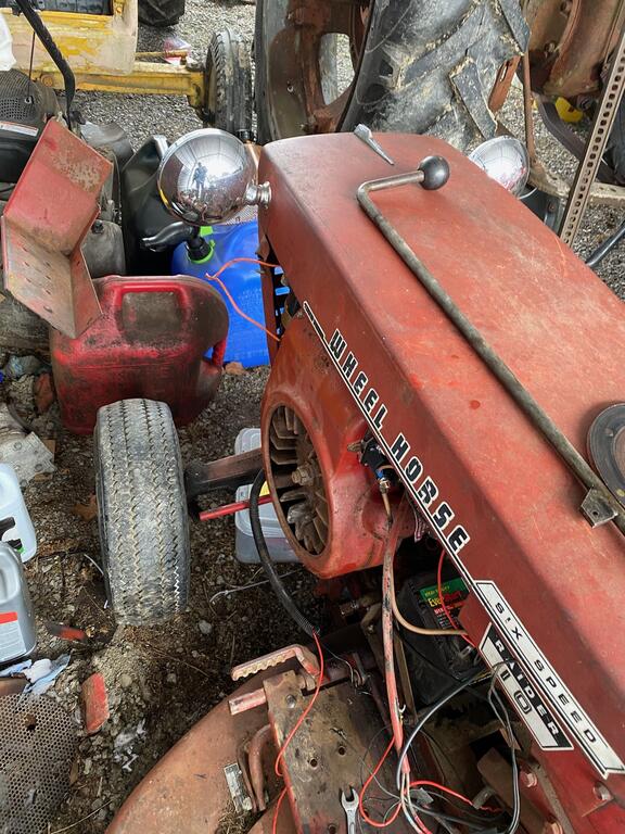

jtrosp1980 89 #17 Posted December 21, 2021 Some progress got motor to run got some electrical done IMG_1056.3gp 2 Share this post Link to post Share on other sites
ebinmaine 75,775 #18 Posted December 21, 2021 Just looking at the pics. Thread title is 1970. That's a 68 or 69 by the hood. Is the engine a '70 or have you checked the tractor numbers? Good to see the progress. Share this post Link to post Share on other sites
